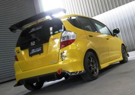

My problem is I don't see the oem hook under the rear bumper of my car... See this video where there is a hook to install the aftermarket one:
Here's what my car looks like, and my question is if the oem tow hook is inside the plastic cover?

lets make this simple.
look at the back of your fit. find the exhaust tip. Look above and to the right, that small round cover is where the factory eye bolt screws into.
At front, look under driverside headlight.
Honda moved from a unibody-towing location to a removable one in hopes of cleaning up cosmetic appearances

This thing?
The description of the aftermarket tow hook says it will fit this generation of Fit, but it doesn't seem like it.
