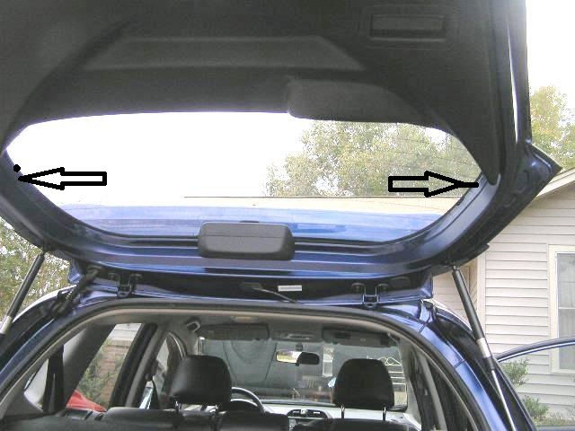

I took my 2013 Fit Sport to the local Honda dealer today for a oil change & tire rotation and the technician test drove the car for my noise issue. He did hear a noise, but determined that it was the molded plastic part inside the hatchback lid. It was rubbing against the metal part and he put some odd tape under the plastic part. It did seem to have no screws to adjust the fit against the inside part of the hatchback.
However....I still hear the seat belt shoulder strap height noise. As already mentioned, it does go away temporary if you lower, or even move, the shoulder strap height adjustment. It is not as bad in cold weather. At least the dealer has the information on record for when the car goes out of warranty.

Last edited by bulldogtrekker; Dec 17, 2014 at 08:00 PM. Reason: added phoyto of hatch rattle
