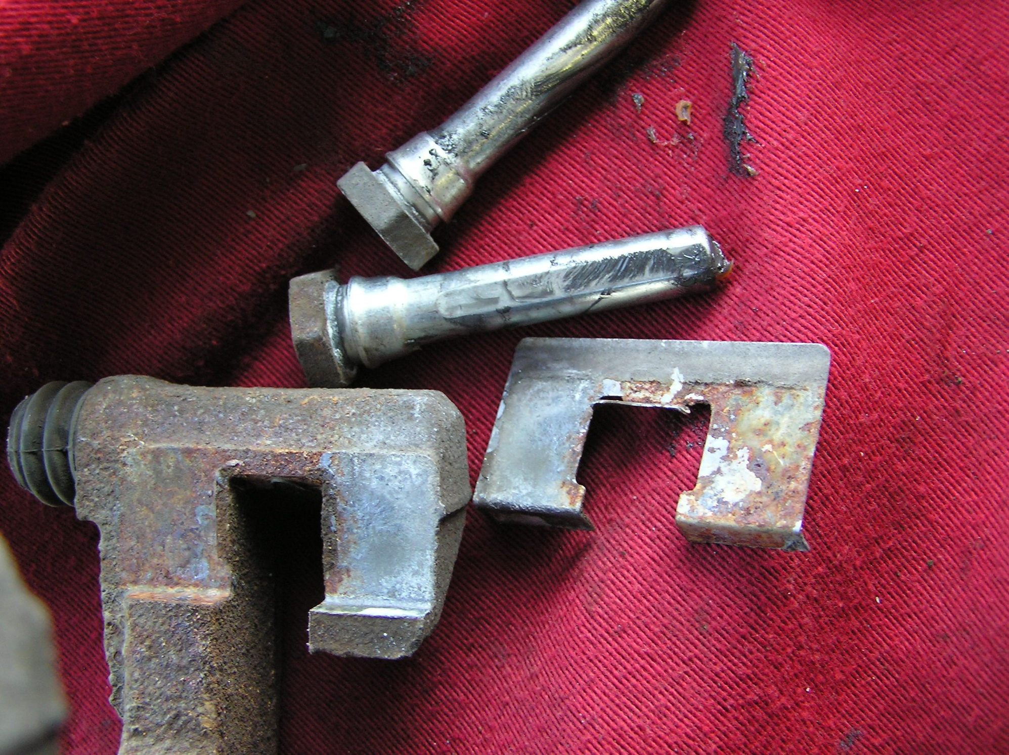

Biggest problem I see in the rust belt is brake pads that get stuck in the brackets due to rust buildup under the clips on the ends. The pads need to be free enough to "float" and rust causes them to bind, and can cause uneven wear and low spongy pedal. I take them all apart and grind the rust out, coat the exposed iron with Silicone grease, and wire wheel the rust off of the end clips.
Next biggest issue IMO is stuck slide pins. Free them up, clean them up, and I use Silicone grease on them regardless of whatever type of grease was on them prior. Silicone won't attack the rubber boots. Make sure the boots are not torn open.
^You can see the rust issue there
Bad caliper(s) can also cause lousy pedal feel too.
