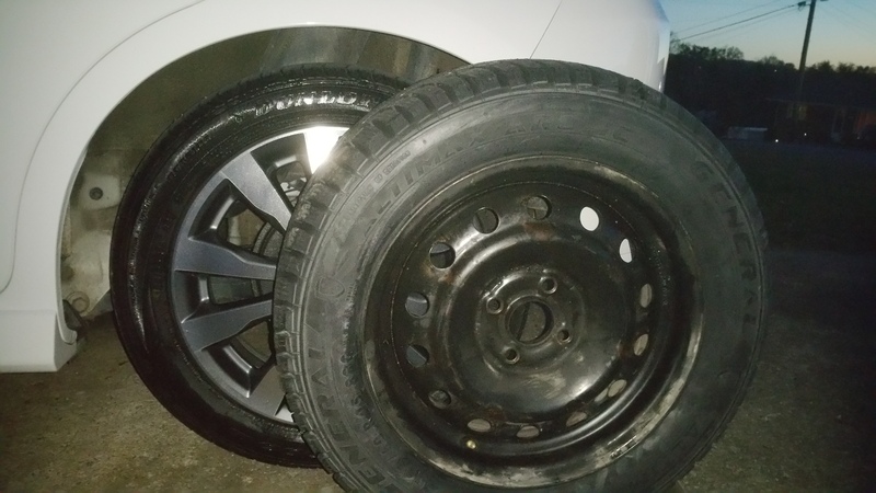

Surely you could find 14 or 15 inch steelies on craigslist. Got these for $30 and put my General Altimax Arctics on them. Can't wait to run them!

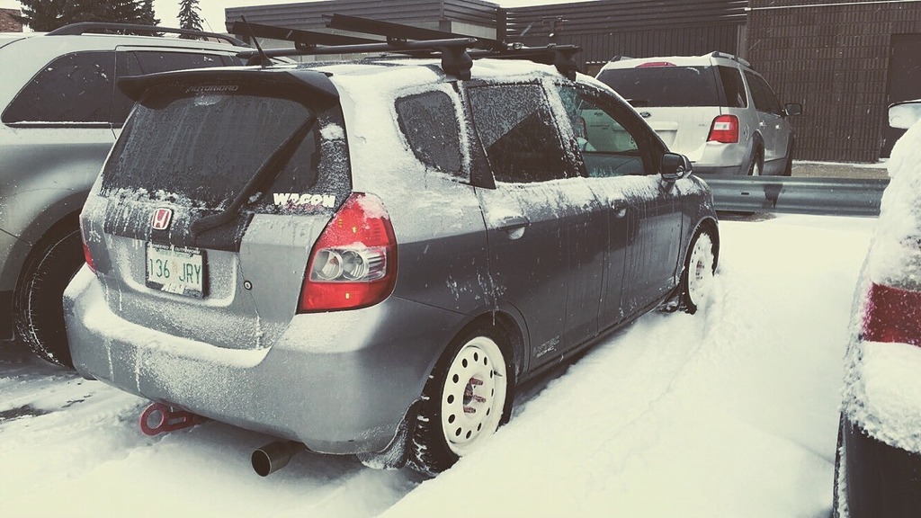

Winter mode 😂 I had to get a centric ring machined by a shop locally because i bought a universal steel wheels from a guy. its hub bore is 72.5mm or something fit has 56.1mm. And i can't find it online or locally. No vibrations but just real heavy feeling. 😪😪

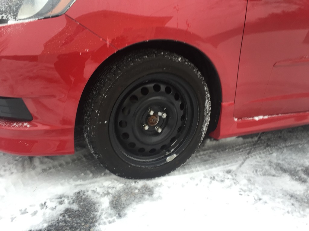

I have 16" steel wheels on mine with Yokahama snow tires. What a huge difference it makes.
Attached Thumbnails Rims for Snow Tires-5eb218f2-6d22-4367-9c5d-c2c1fe1f7fee_zpsxldswbqb.jpg
