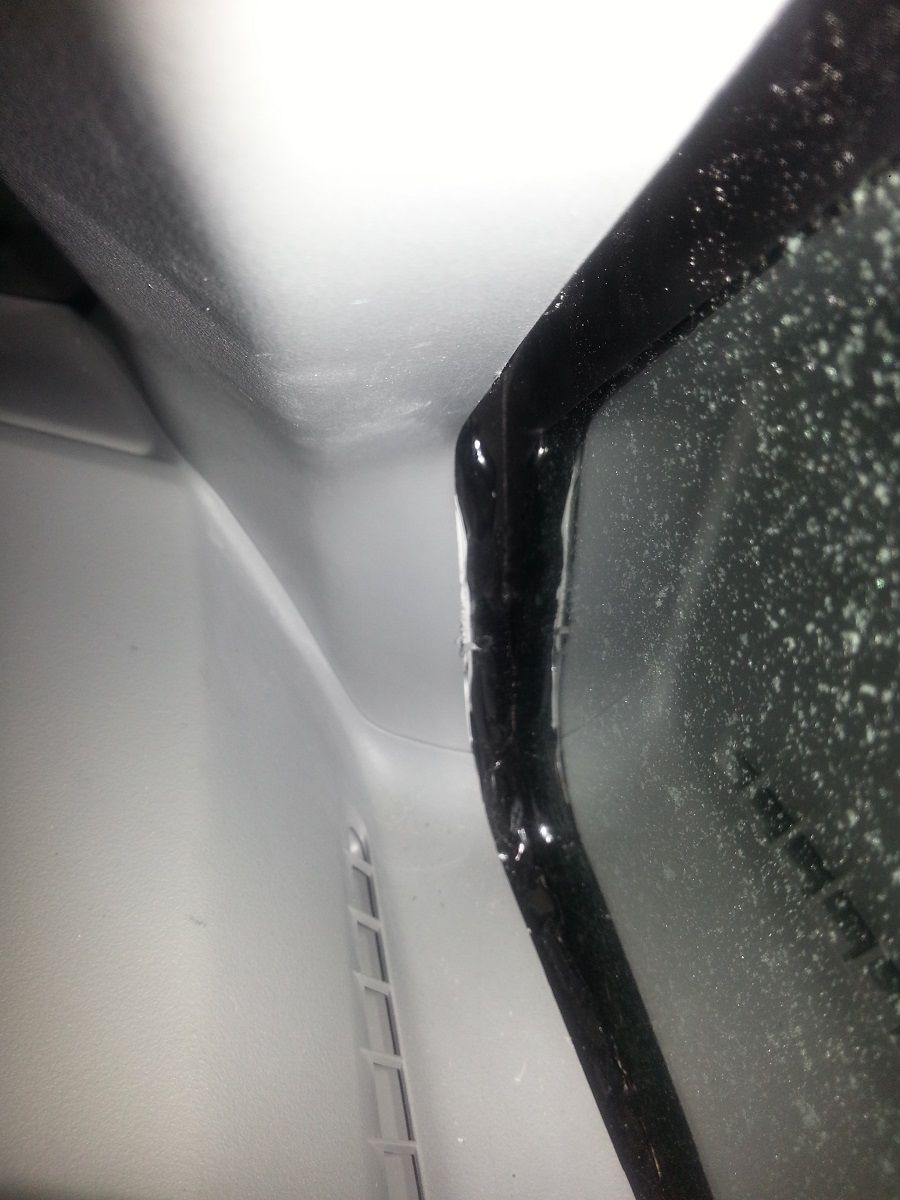

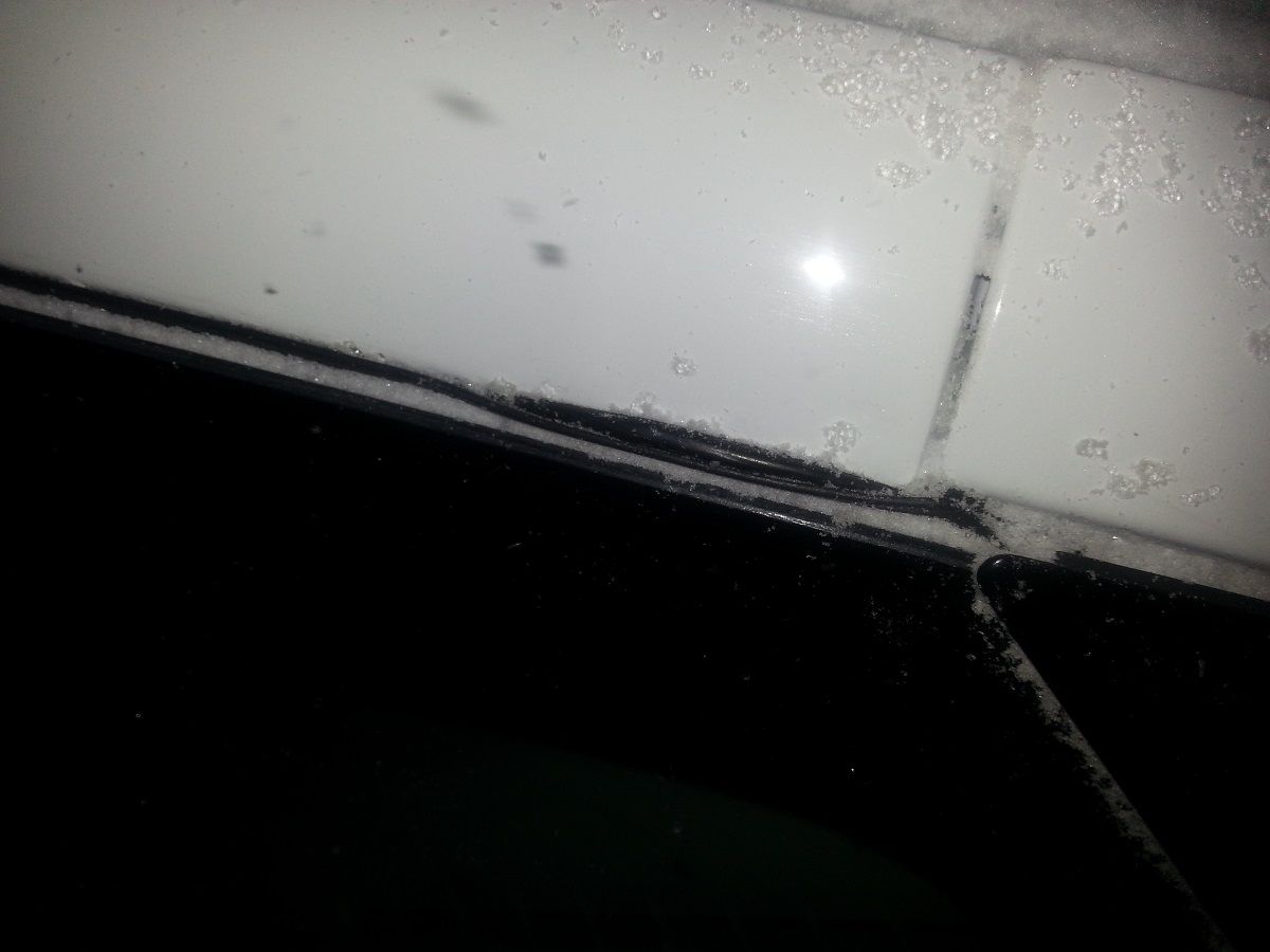

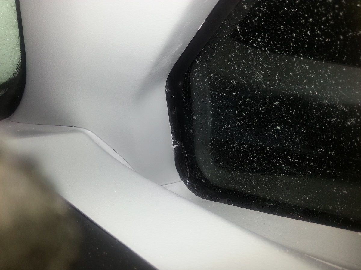

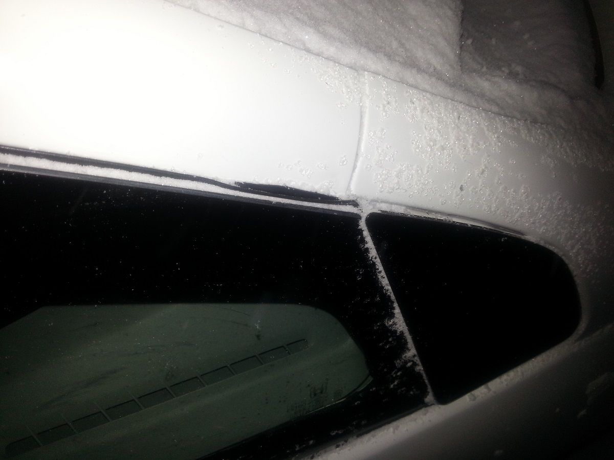

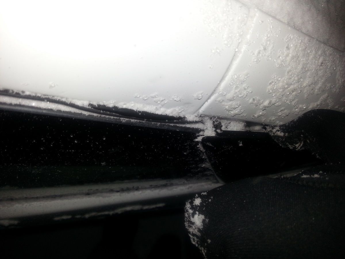

so the front corner window on my sister's new-to-her 2010 fit looks like it wasn't attached properly, there's visible silicone blobs visible from the interior, it doesn't look flush with the sheet metal, and the little plastic piece in front of is seems loose...
and at highway speeds, it produces a lot of wind noise..
any ideas?
here's some pictures;
Attached Thumbnails Front corner window poorly sealed?-80-img_20160123_170025_49e1cfb845c087c2b0af4f6b10a548d788e6d0c6.jpg   Front corner window poorly sealed?-80-img_20160123_170036_cae819bafbe01ade96de84d1f7dbb449f905504d.jpg   Front corner window poorly sealed?-80-img_20160123_170045_ef6c5aebc3df8ed3ddbad981c07061ea06f7ad12.jpg   Front corner window poorly sealed?-80-img_20160123_170231_449d998f4ecc022970f4b84ddfd691186eced9aa.jpg   Front corner window poorly sealed?-80-img_20160123_170239_7f08a04ad12b51bd1119d8d7e9e3e63ac3d27aab.jpg

looks like the channel is out. was this car involved in a improper window repair ?

That is a serious red flag... it's shoddy work, whether the car was in a major wreck, or they simply fubared a simple window replacement.
Carfax is useful for checking the condition of the title, however it's meaningless for the most part in detecting undeclared accidents or repairs.
Just have a couple auto glass repair shops look and give an estimate. If you don't know how to detect body shop repairs, I would strongly recommend that you take the car to a body shop and have them look and quote to repair it. You can often find repairs by checking the inside of door openings for masking lines, clear coat inconsistencies, etc. It would be difficult to tell when it's wet/snowy!
