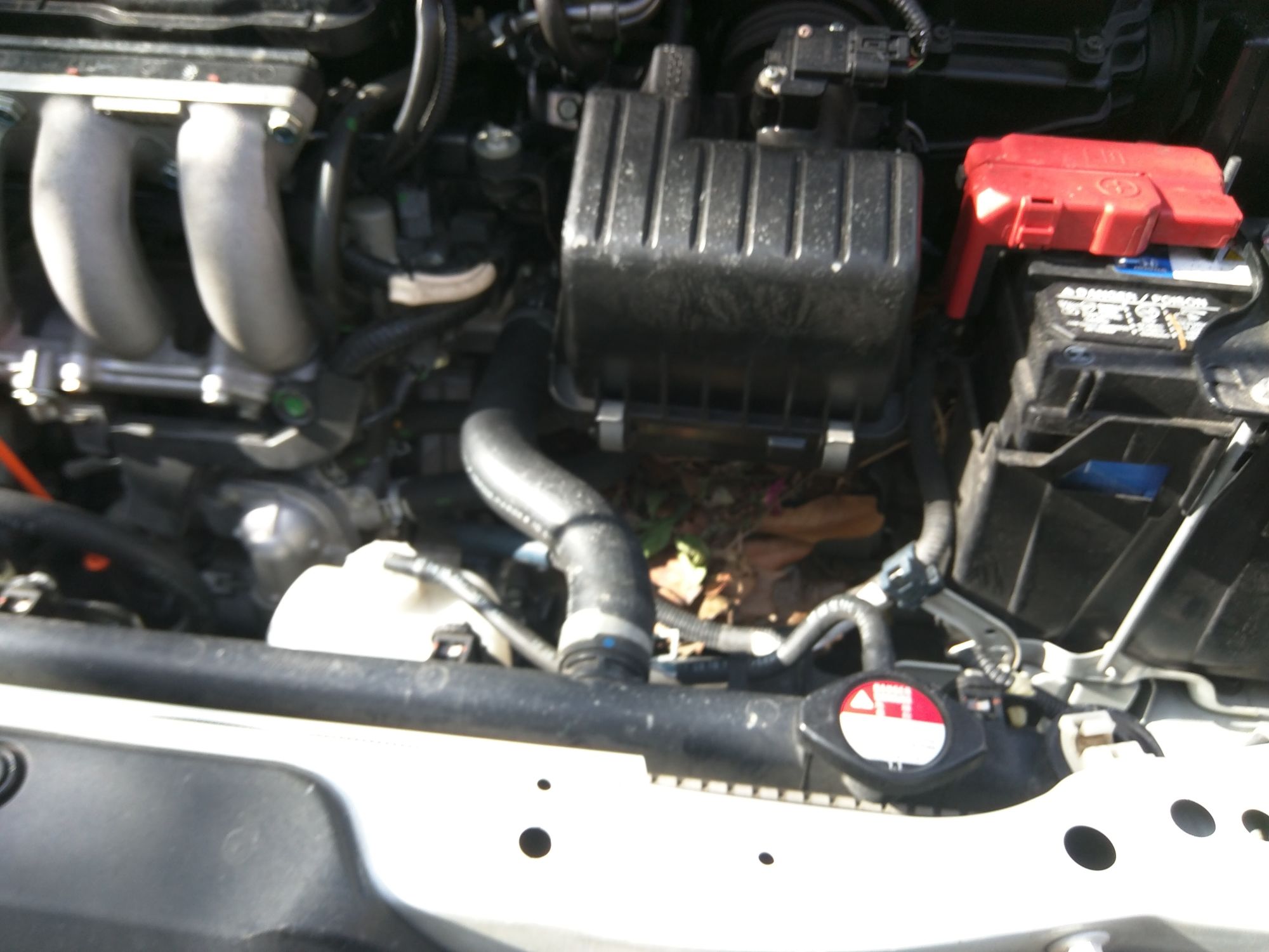

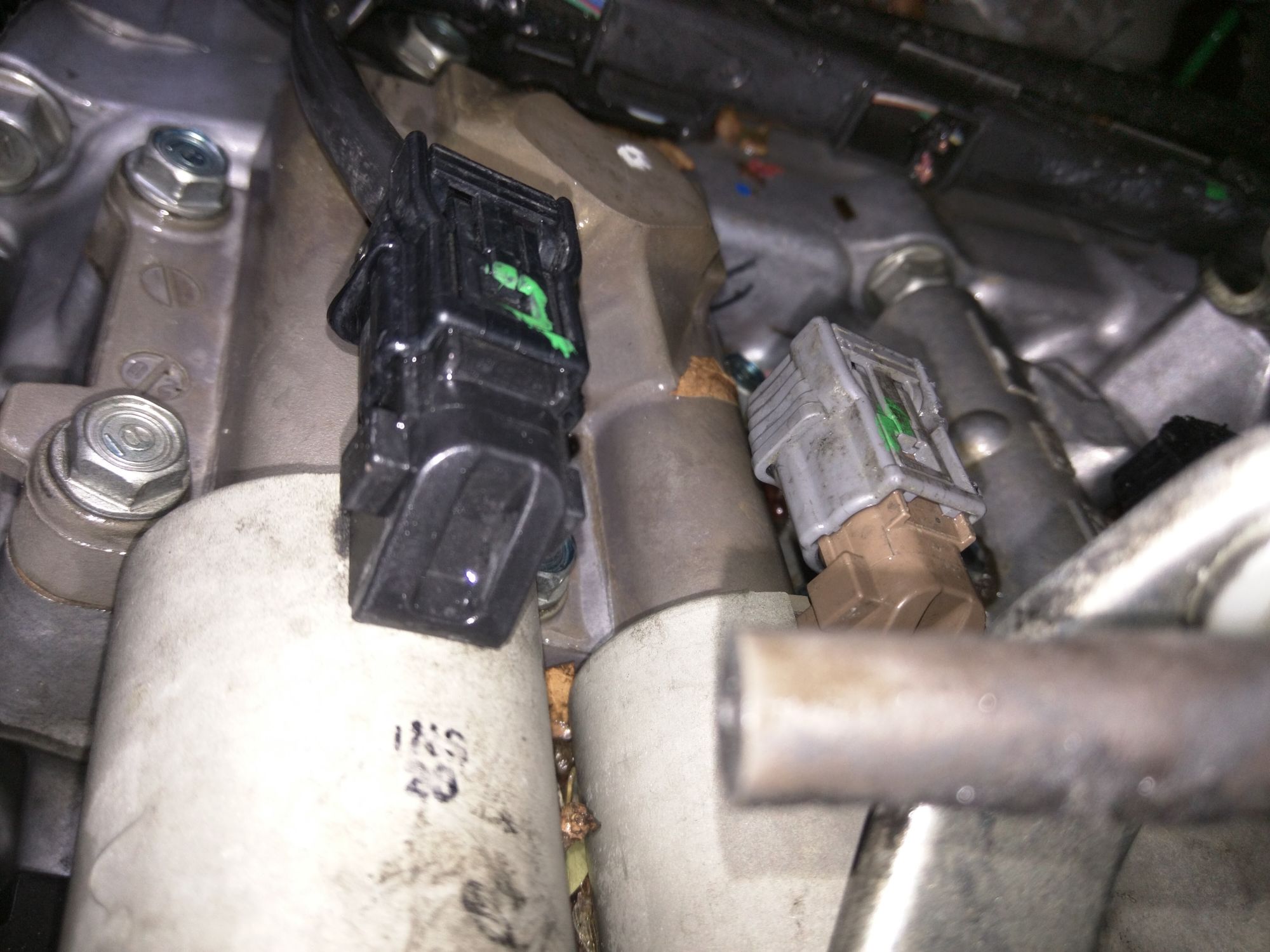

I hope someone can ID this wire underneath the air filter box. I have had my Fit Stored for over a month because of the AirBag Recall and today when I went to move it it ran funny and shifted hard. The Check engine light is on also. I have what looks like two Completely gone wires that go into connctors under the air filter box. If anyone knows what these might be please let me know. I will be going to the dealer to see if I can find the connector so I can hopefully fix this mess. If not I may need to make yet ANOTHER insurance claim. This will be my 3rd claim and 2 of them are RAT related. I live next to a huge field.
THanks!

I fix the harnesses when rodent damage occurs. Each situation is different though....
Not all people who work on cars can repair wiring and make a long lasting, weatherproof repair.

Thanks for the reply. I would normally fix this myself. But it looks like two parts of the harness at least 5 inches long that go into two connectors. One of the connectors (the grey one) is easily visible. You can see that there is no wire harness going into it. This makes me think that I need to take the whole harness out and splice in at least 7 wires per connector and then solder them in. This is not going to be fun either way.
