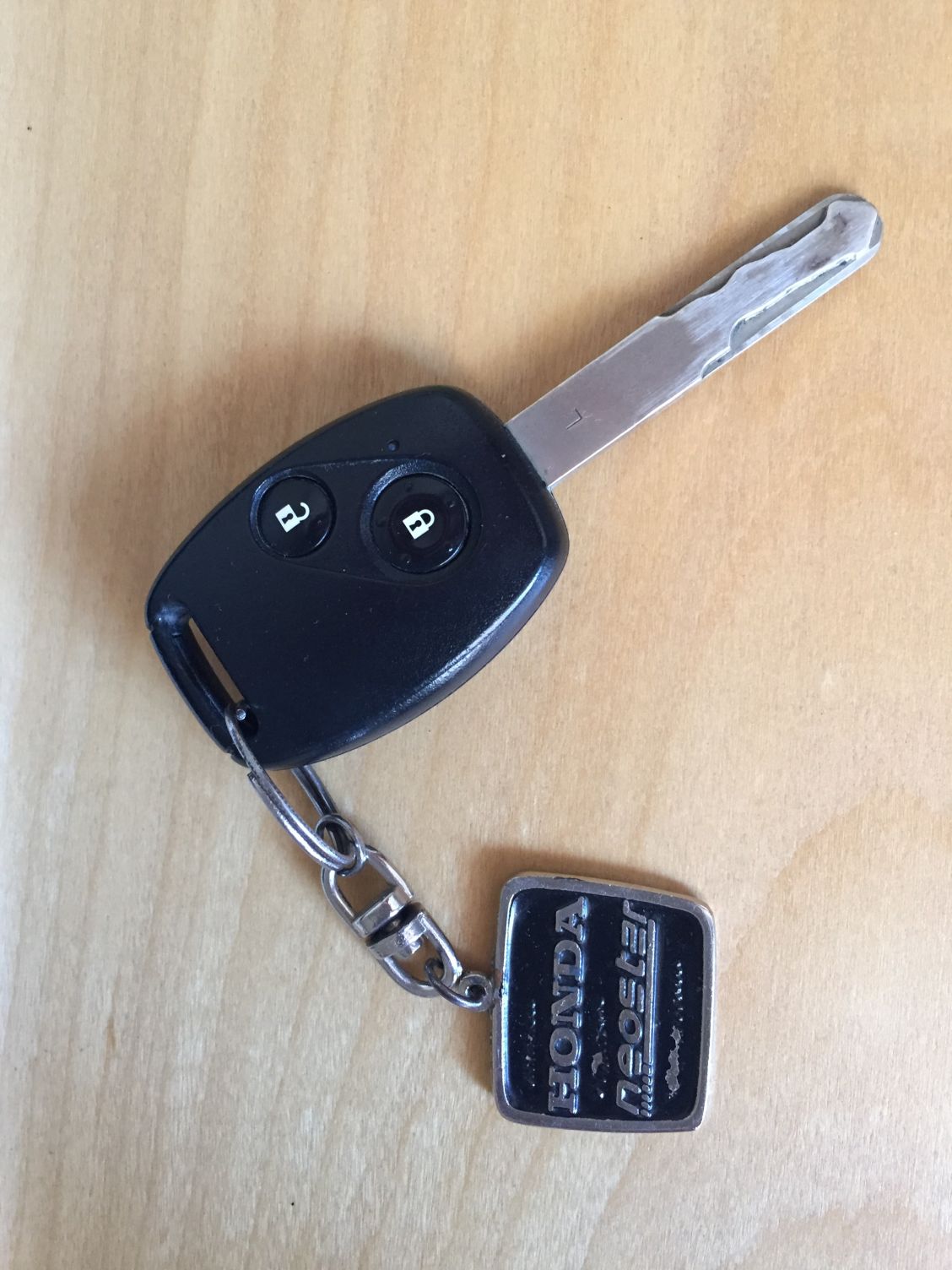

Can you upload a pic of your key fob?
Attached Thumbnails How to make stock Alarm make sound?-80-image_3152bbcd5fd8c45c6375279c33f05fb1646b69b7.jpeg

Originally Posted by Yakkter
Seems a little different from what most of us have. For example, my key fob comes with a panic button and when I lock the car twice with it it makes a sound.

Yep, that was i was trying to say, the key fob is not exactly the same, here in the user manual, found this two beautiful words "if equipped" when talking about the second press of the button that make horn sound, seems that theres an option some device or something that makes it work, its not stock, at least not on mine. Will have to make it manually if want to hear the horn, key lock fuse is the #14, but from there to find a cable that sends the signal of locking car and make it work for making the horn sound seems to be more dangerous and difficult that usefull, probably will not find someone trying to do this cus is stock there already, so if i do it will show you the results! Thank you very much for your help and answers!!!

The issue may be that your car may not have the 2nd horn for the Alarm/keyless entry. My FIT sport has two separate horns; the normal horn attached to the steering wheel "button" for expressing my displeasure with crappy drivers on the road, and the one for the alarm. It's the 2nd horn that makes the sound when the key fob button is pressed a 2nd time. IF your vehicle is not equipped with this horn (the security system horn) then the chance of it "honking" when you press a lock button is very unlikely as it would require honda to have rewired the primary horn in the vehicle.
The key button sequence mentioned above is the fact that you can program the car to honk the [security] horn when the car is locked using the fob, or only when the lock button is pressed a 2nd time. I don't remember how I did it but mine would honk every time and I changed it so it would only lock (and not honk) when I pressed the button. I didn't want to wake my son when coming home and for me, the locking of the car was loud enough for confirmation.
Search the forum for the Alarm horn to see if there are pictures of it's location. I believe it's in front of one of the wheel wells but I could be wrong. If you don't have the horn, you might need to do some special relay wiring - or it might be as simple as hooking up the horn if the wiring is already in place to the under-hood fusebox.

Thank you so much the reply, actually the car has 3 horns, there are two wired to the steering wheel (for waking slow drivers of course) one of them is acute and the other low, them sound together to make a better sound. The alarm horn is located behind the baterry a little back from the left front light, its there so it gets difficult to find it, that horn actually works, i repared it about an year ago, its posible to make it sound when opening the car with the alarm armed, but not with the key fob :/
