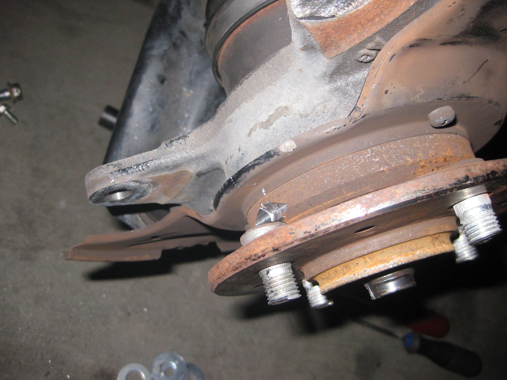

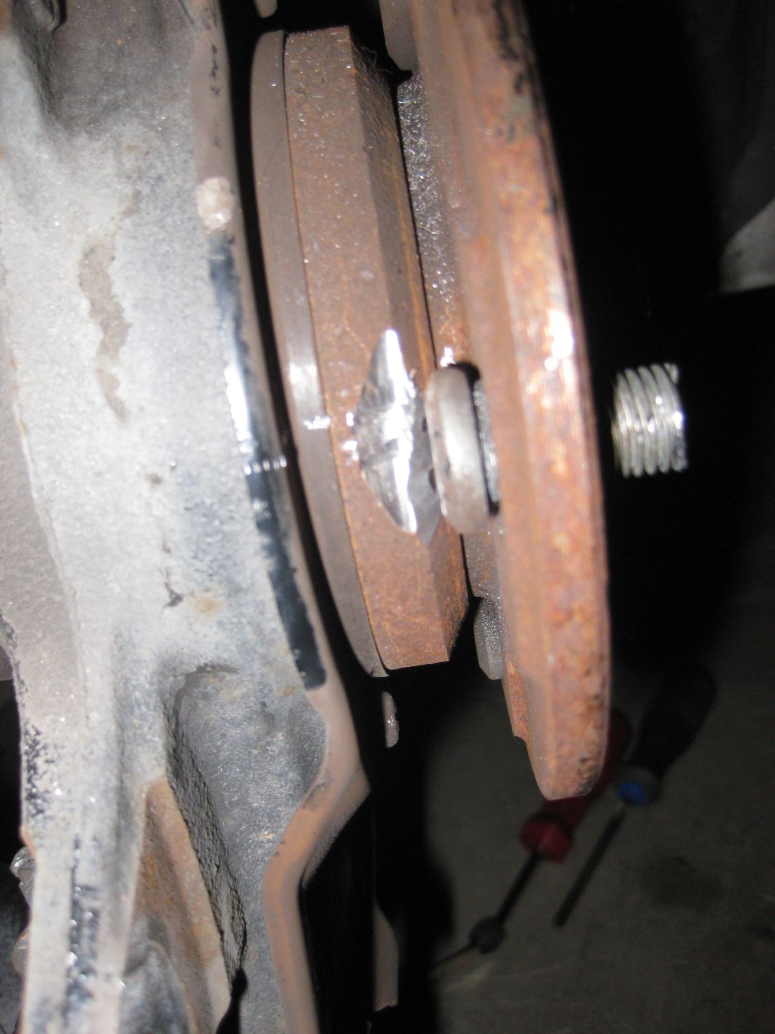

ok it really was stuck!! so now iam at the notching/grinding phase, how much am i supposed to take off? i don't see any pictures or old threads about how much to shave off. here is what i have shaven off so far, do i need to go farther? deeper? both?

Cut the hat off the stud, but you will probably find you can't get a new stud in place no matter what.
Remove knuckle. Remove hub from knuckle. Replace stud(s).
Probably want to replace wheel bearing at this point.

That's how I replace wheel studs for many cars, when clearances are tight (BUT you can't bend the wheel stud to get it into the hole!)
IF you can get the old stud out 85% complete, a new one can go in the same way.
I've even notched the knuckle like you did to make room in addition to cutting an edge off the stud. (don't compromise the strength of the casting though!)
But sometimes all that work doesn't help one bit.
Pretty sure you will find there just isn't enough clearance on the Fit.
If you have a hub puller you might be able to yank the hub loose after removing the axle nut, but it will separate the outer race from the bearing when it comes out.
