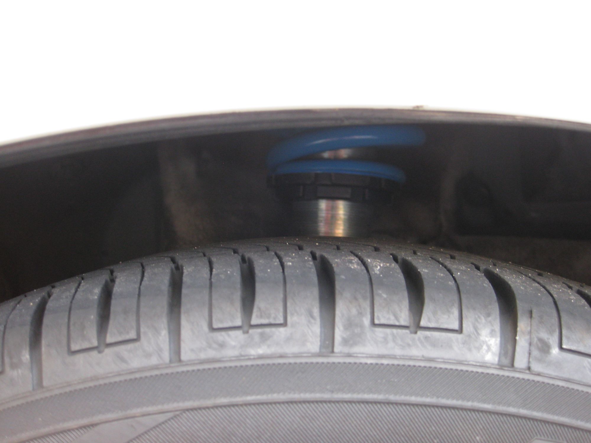

But, here is a picture of one of my fronts collars, and as you can see it has a bunch of thread that is adjustable, and I am assuming it can be dropped another 2 inches or so more.

what i do find odd is check out this picture of my rear springs!!! are 3 coils supposed to be touching like that?!
First, yes, the 3 coils on the rear do touch like that,

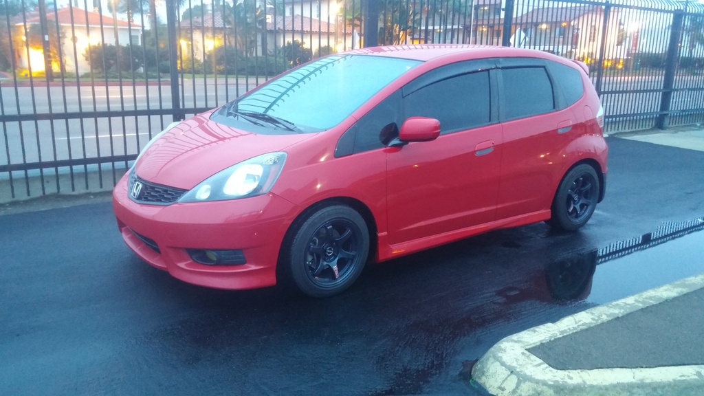

Now, let's compare to Connor car (and my car right beside Connor's car)
I think Connor's (and my) car already have less fender gaps at the current configuration than those hyper cars above,... don't you think this is already low enough?

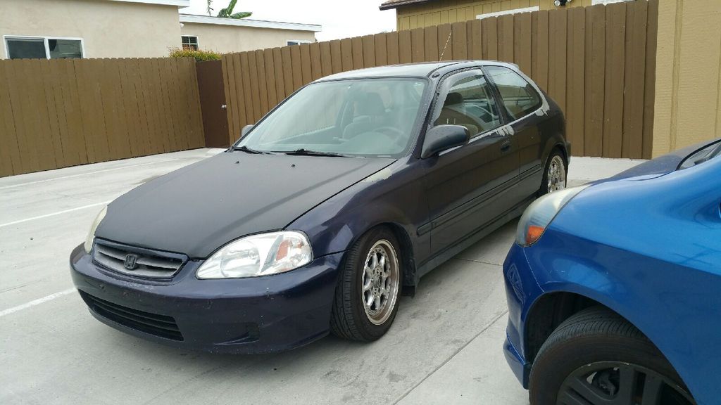

This is what I'm coming from 99 civic hatch...nothing fancy but it handled great and it felt like you were one with the road. Koni shocks and h&r springs with front and rear sways. Wheel gap just a little less than connors. Too bad some jerks stole it...but if they didn't I wouldnt be here talking to you guys
What really peeved me though was I literally pulled the motor and rebuilt it at 250k miles...then 2 months later it was gone. Loved that car.

Ah 205/45/17 (24.3)is similar to stock and clearly makes a big difference. Here is a side profile pic of my fit on 205/50/15 (23.1").
So that extra 1/2" in tire sidewall makes a significant visual difference. Just hope it doesnt make the wheel too small with that extra sidewall height.
