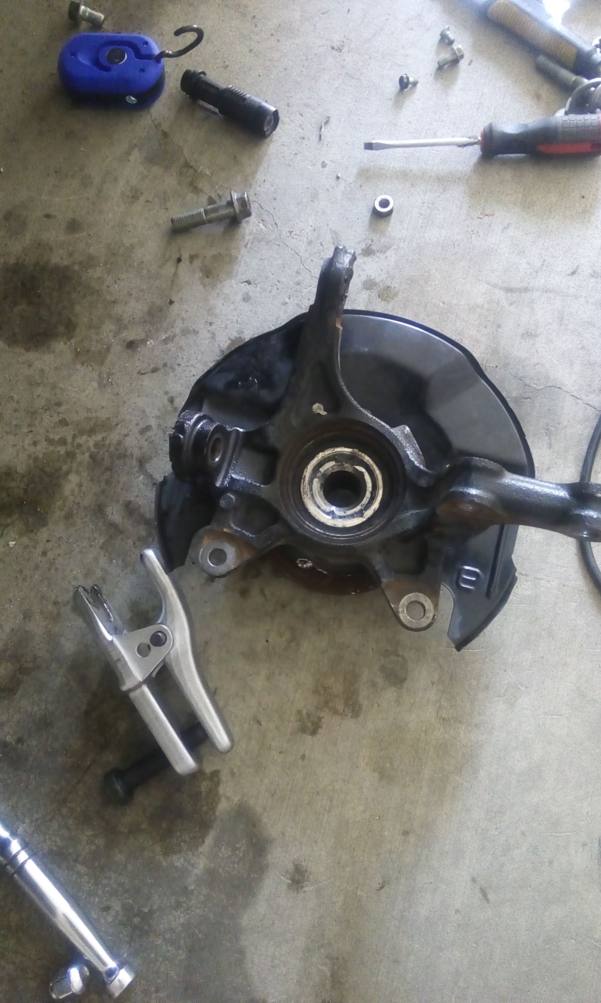

Trying to rotate my hub so i can take the wheel studs out
Hi Vash,
Please read this 2 threads of mine where it contain information on how to remove ball joint (when I change my lower control arms with Insight aluminum LCA),
and also when I change my studs with the stronger and longer ARP studs for my Brembo install that need spacer,
the links are below, it will show you clear pictures and all the tools (including Honda Special Tools) needed to do this properly according to Honda service manual:
https://www.fitfreak.net/forums/2nd-...ntrol-arm.html
https://www.fitfreak.net/forums/2nd-...i-rotor-2.html
i did exactly what ezone suggested. there just wasn't room on the fit to put the new studs in without removing the knuckle. on the plus side, my wheel bearing didnt need replaced like the Honda dealership said it would.
just wanted to update, i bought one of these tonight, and going to finish putting it together tomorrow and see if i can push out those bearings!

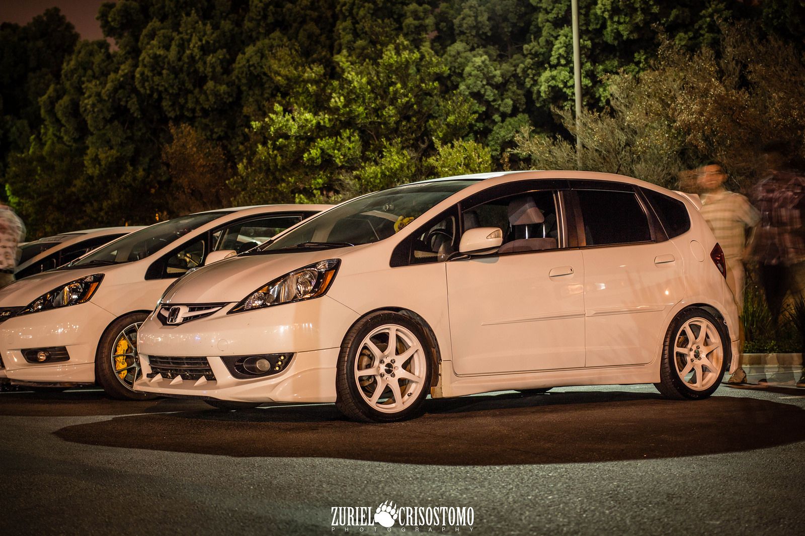

When I have Bilstein,
I had the front Bilstein Coil over slightly lower than middle setting on the collar.
I once lower it down more but it hurt the ultimate handling,
what I mean is when doing over 90mph on bumpy freeway
because the car become a bit bumpy due to less suspension travel...
but if you guys don't worry about the very high speed handling,
then you can adjust it to the lowest and be fine...
another trick to reduce the gap is to use larger diameter wheel / tire combo...
I used to have 225/40/18 and it really fill the fender gap even with the
Bilstein in the middle...
this larger wheel/tire have extra benefit which it making the car have almost as much ground clearance as stock,
so I can drive it anywhere without worry of scraping...

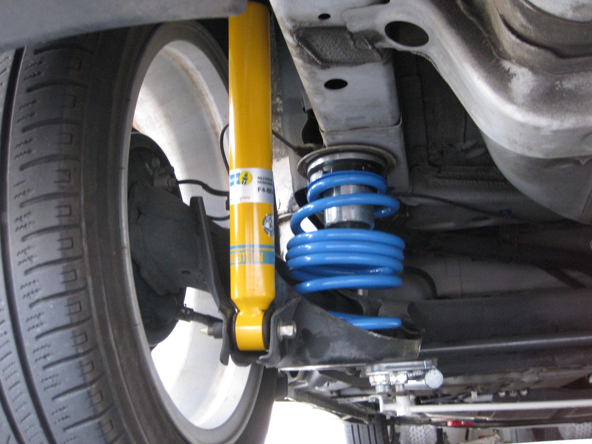

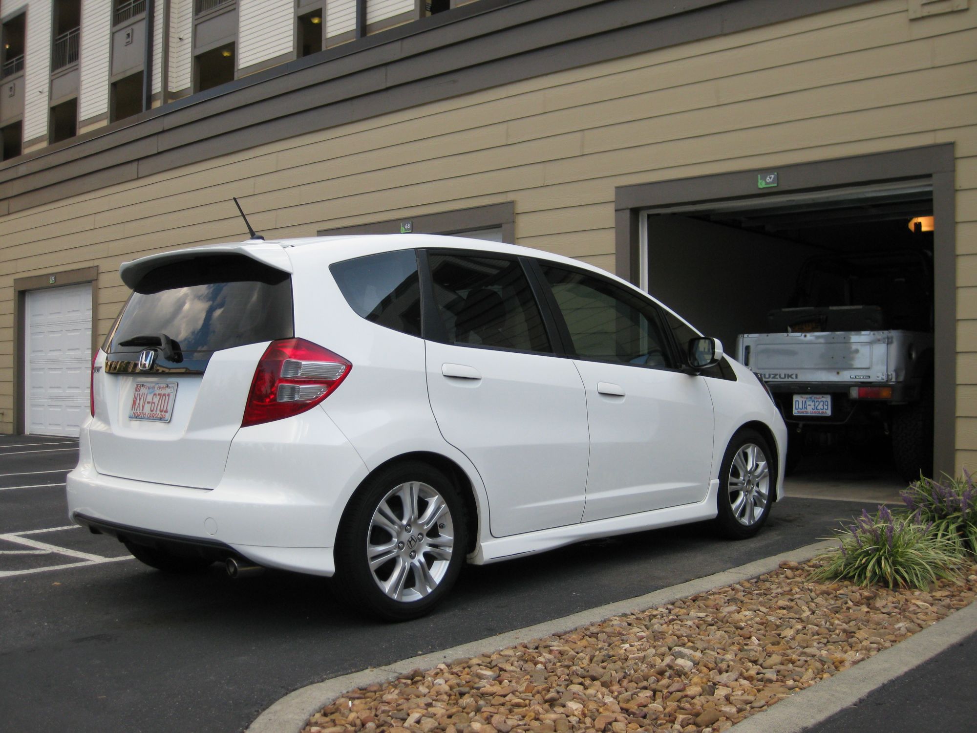

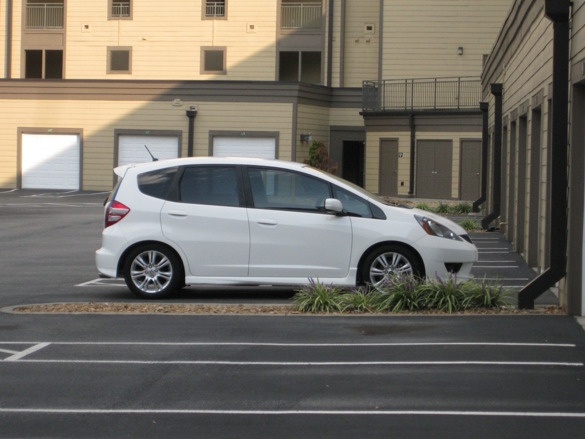

The back is at it's lowest if you look at other peoples Bilsteins it seems to be widely known that the rear's max still has a few fingers worth of space between the tire and the fender.
as for the front, you can lower that all the way down, I actually had it at its lowest setting at first, but it was just way too low for my liking and I don't wanna scrape everywhere.
damn is it really a wheel gap =( ahhh well I am more concerned about the front bumper hitting everything so I am ok with how it looks.. but yeah it can go alot lower in the front if i put the collars all the way down., right now they are almost all the way up, the passenger side I have them about half way.. I measured it pretty good as well, and both my front and rear should have the exact wheel gap's.. but... perhaps the pictures make it look like the front is much higher?
I do not believe this statement is true, but I did not test it to find out when i had the collars all the way down in the front.but it should be assumed that the ride quality will be the same at any height as long the maximum compression and extension of the shocks and struts are not reached, which they shouldn't because typically these coilover kits are paired together to work with the maximum compressed and extension rate of the shock itself... , so they are SUPPOSED to allow atleast an inch or so of compression for it to feel normal. I don't exactly know.. because I didn't drive it around when i had the collars all the way down in the front.. I just knew it was way too low for me to feel comfortable driving around, so I raised it up by ALOT in the front.
what i do find odd is check out this picture of my rear springs!!! are 3 coils supposed to be touching like that?!

Yeah those dead coils are for when the suspension decompresses from say a dip in the road. You dont want the spring to pop out in the situations haha.
Looks like it might be possible to lower another inch or so in the rear if you took that collar out though would the spring fit in the stock rubber bushing? Does changing the height affect the ride quality/spring rate?
And do you have pics of the lowest height in the front?
