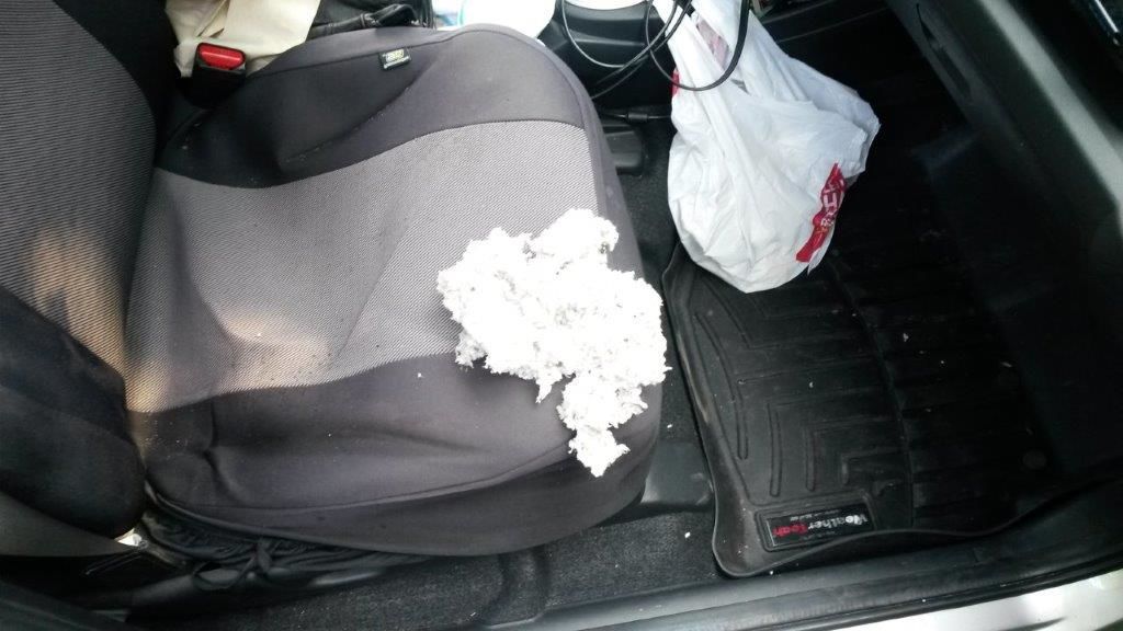

Not sure if this is a problem either but my recirculation slide switch would stop at midpoint. Upon folding the glovebox down to look at the cabin filter, I saw that mice had built a nest on top of the filter from the insulating foam on my firewall. That mound of stuff (other fibers, seeds, etc but mostly white plastic) was preventing the recirc flat from opening (prevent recirc).
Attached Thumbnails AC Button-80-2011_fit_mouse_nest_2015_06_10_6f7123896a3a9dd645e339adc0e5f5b860657fa4.jpg
