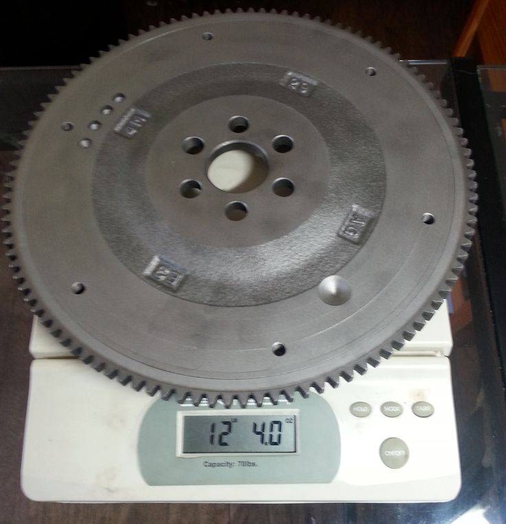

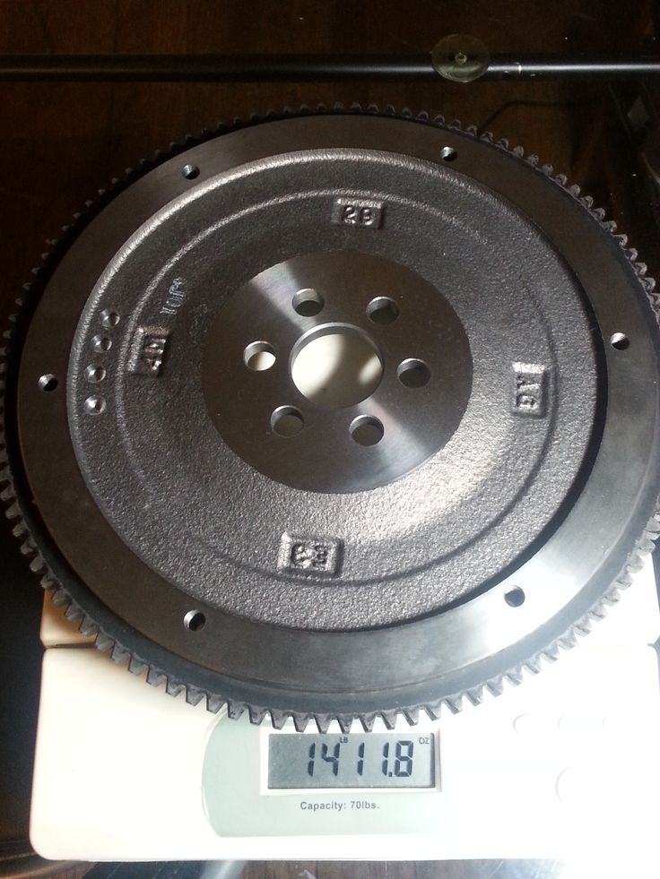

The lightened stock flywheel lost just over 1kg (2.4lbs). Lightened flywheel wheel works if the unit is balanced with the clutch. That is what is needed for it to not throw a CEL.
Stock flywheel
Lightened by Carlquist Racing
Attached Thumbnails GE8 Clutch and flywheel recommendations?-stock_flywheel_zpsyejtxc3h.jpg   GE8 Clutch and flywheel recommendations?-stock_lightened_zpsny9uzekk.jpg
