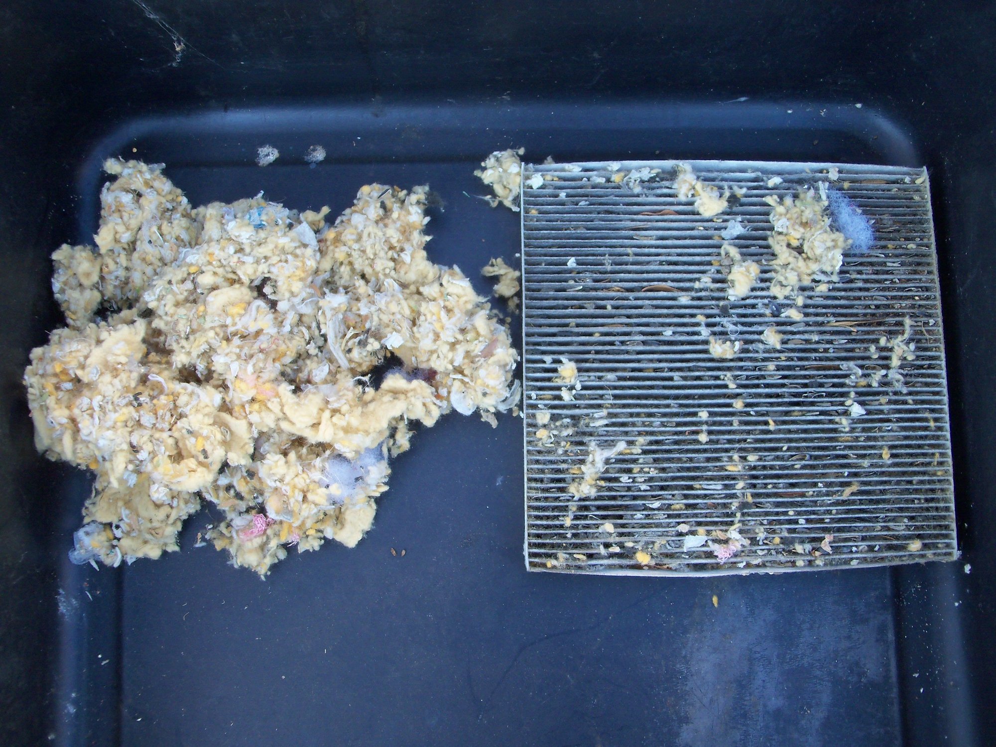

Check out the engine air filter and cabin air filter. Mice love Hondas or at least mine
FIT - Plastic sound dampening material from firewall on top of Cabin air filter
CIVIC - Cabin air filter
