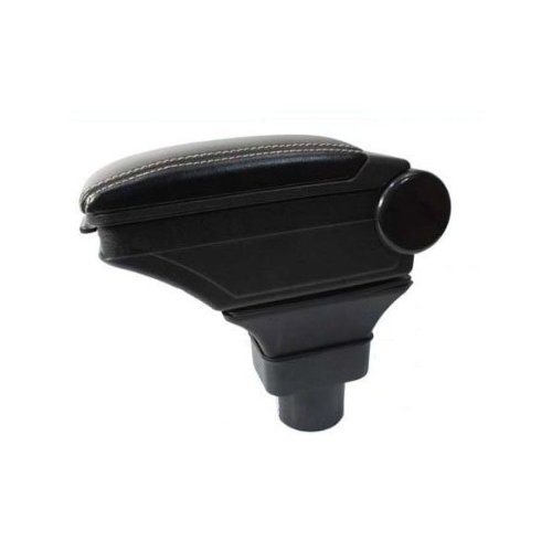

Yeah, mine didn't have an armrest. It's a 2010 base, I think only the sport came with one. I bought one on Amazon the slips into the rear center cup holder. It wasn't the best fit, was a bit wobbly, so I had the rubber pads you stick on the bottom of furniture/chair legs so you don't scratch up the floors. I stuck them around the armrest insert and now it doesn't move or wobble around.
