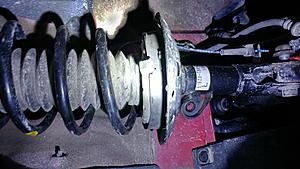

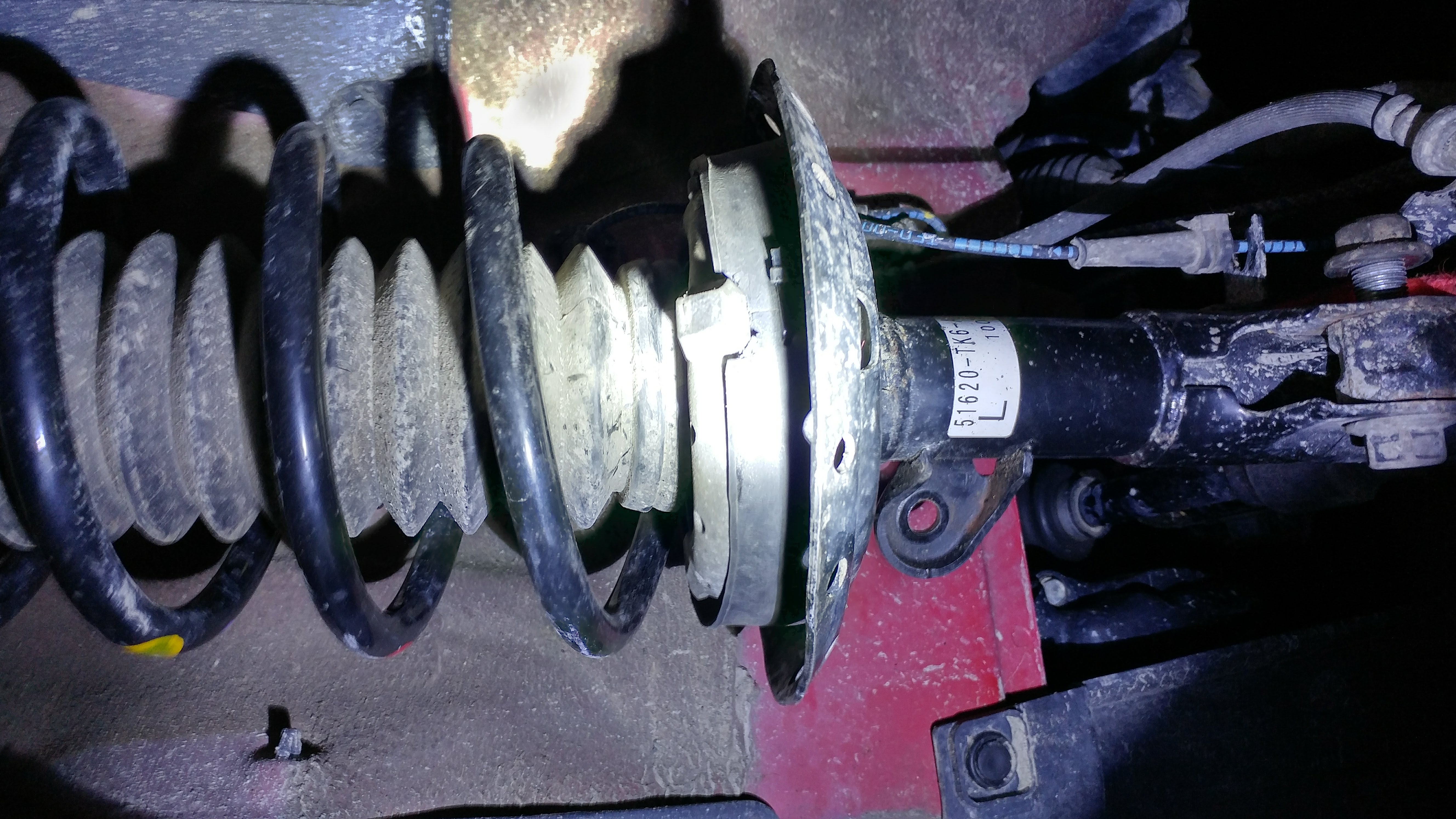

I installed universal spring spacers in the front (Mr Gasket 1285, for a 1" lift) a few weeks ago and have been driving around without any noticeable negative effects. I also ordered the 30mm rear spacers from tema4x4, which I'll report back on when I have them installed.

Some pics with the front spacer

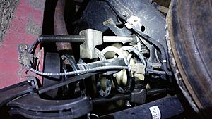

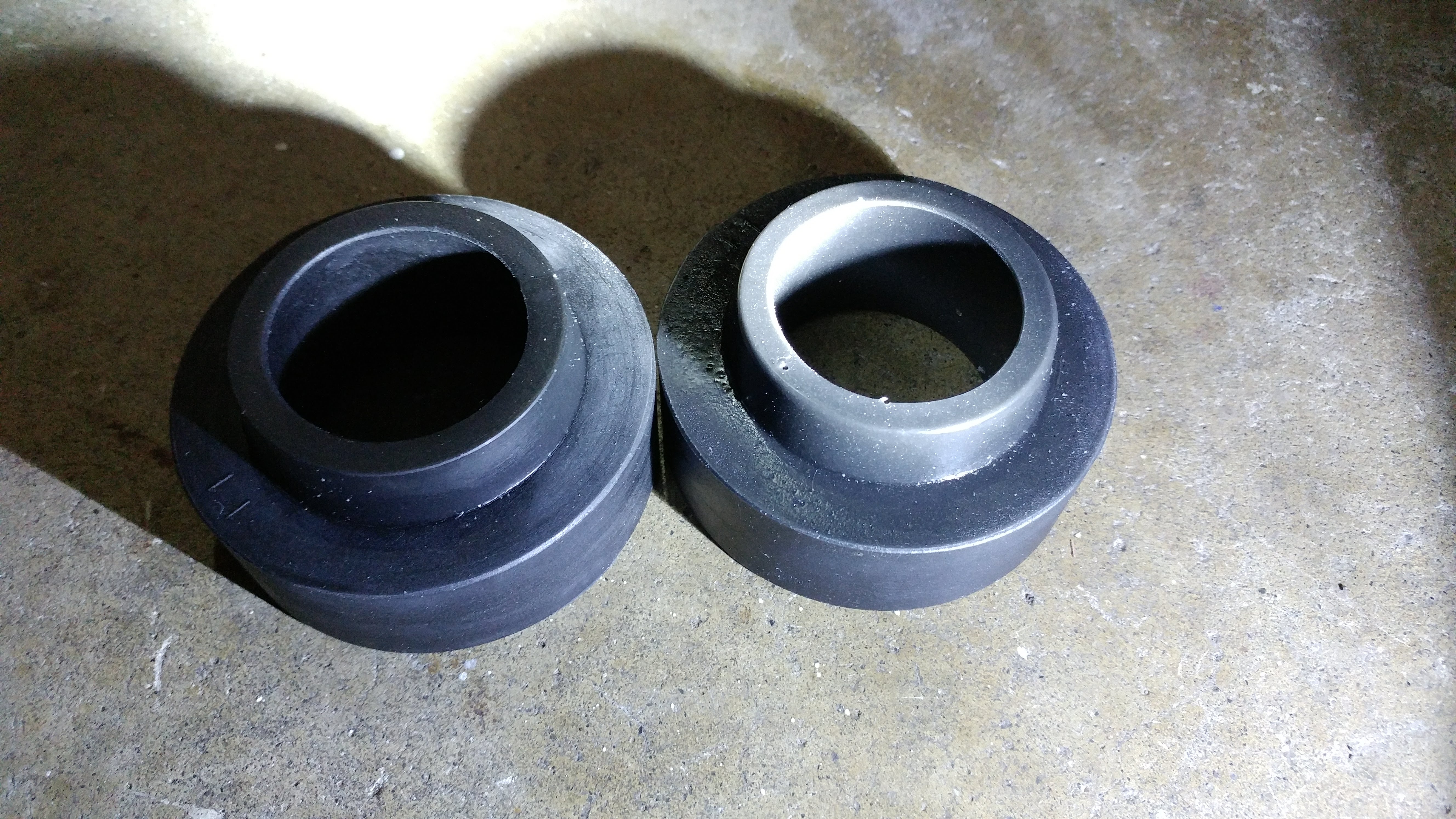

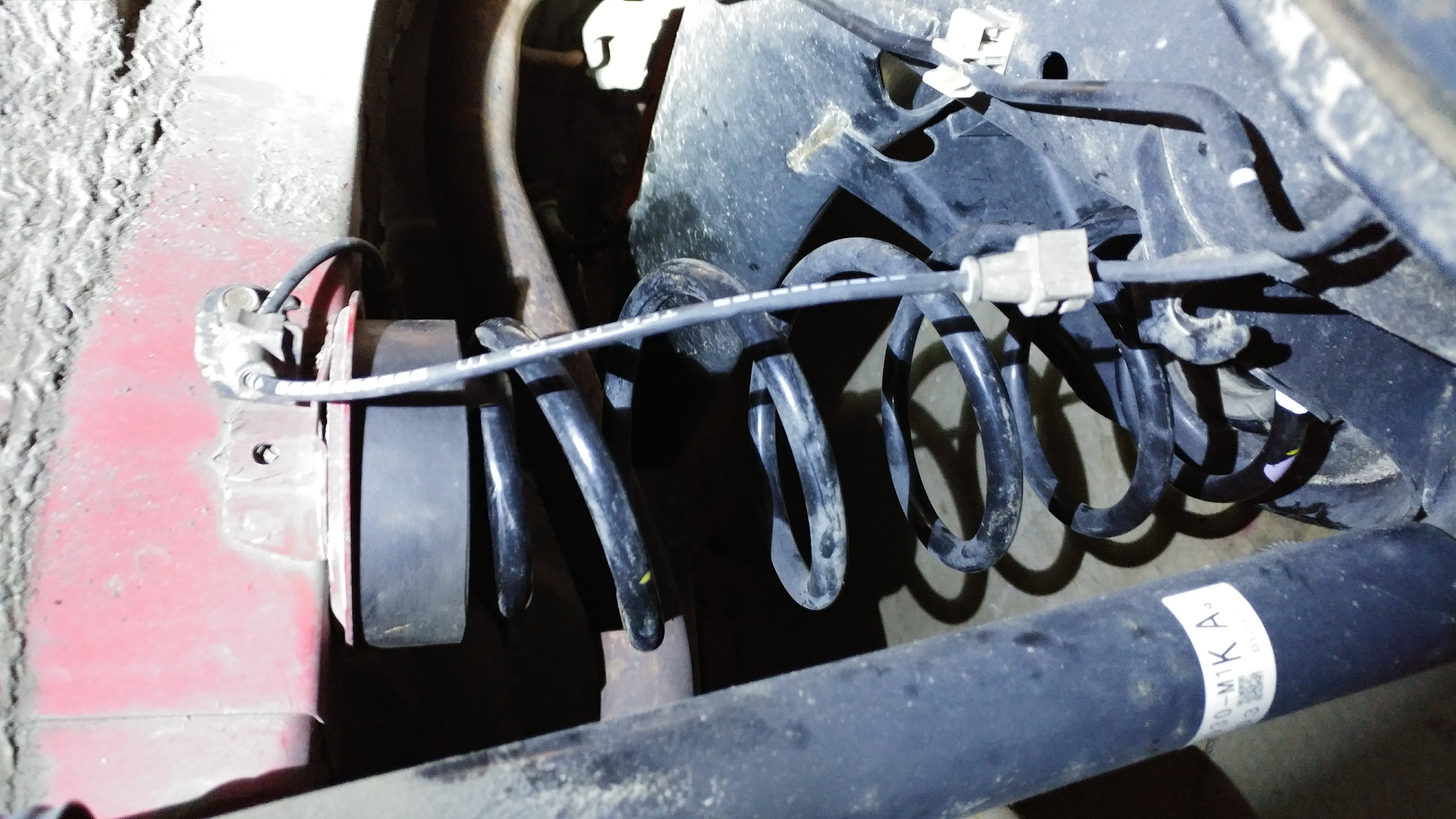

The tema4x4 rear spacers arrived today, $42 shipped from Russia. One turned out to be 29mm and the other 31mm, but not a terribly noticeable difference.
I wasn't sure if it was supposed to go above or below the spring, but it seemed to fit most snugly at the top. The center hole is a bit larger than the hole in the stock rubber endpiece, but the outer diameter seems to fit within a lip with very little play.
Install went smoothly with a tad bit of spring compressor shenanigans (pictured).
