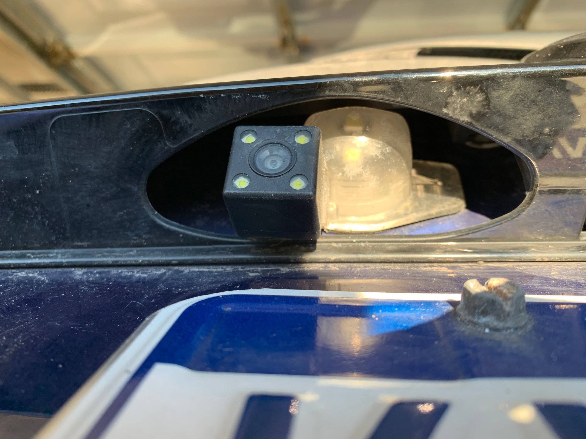

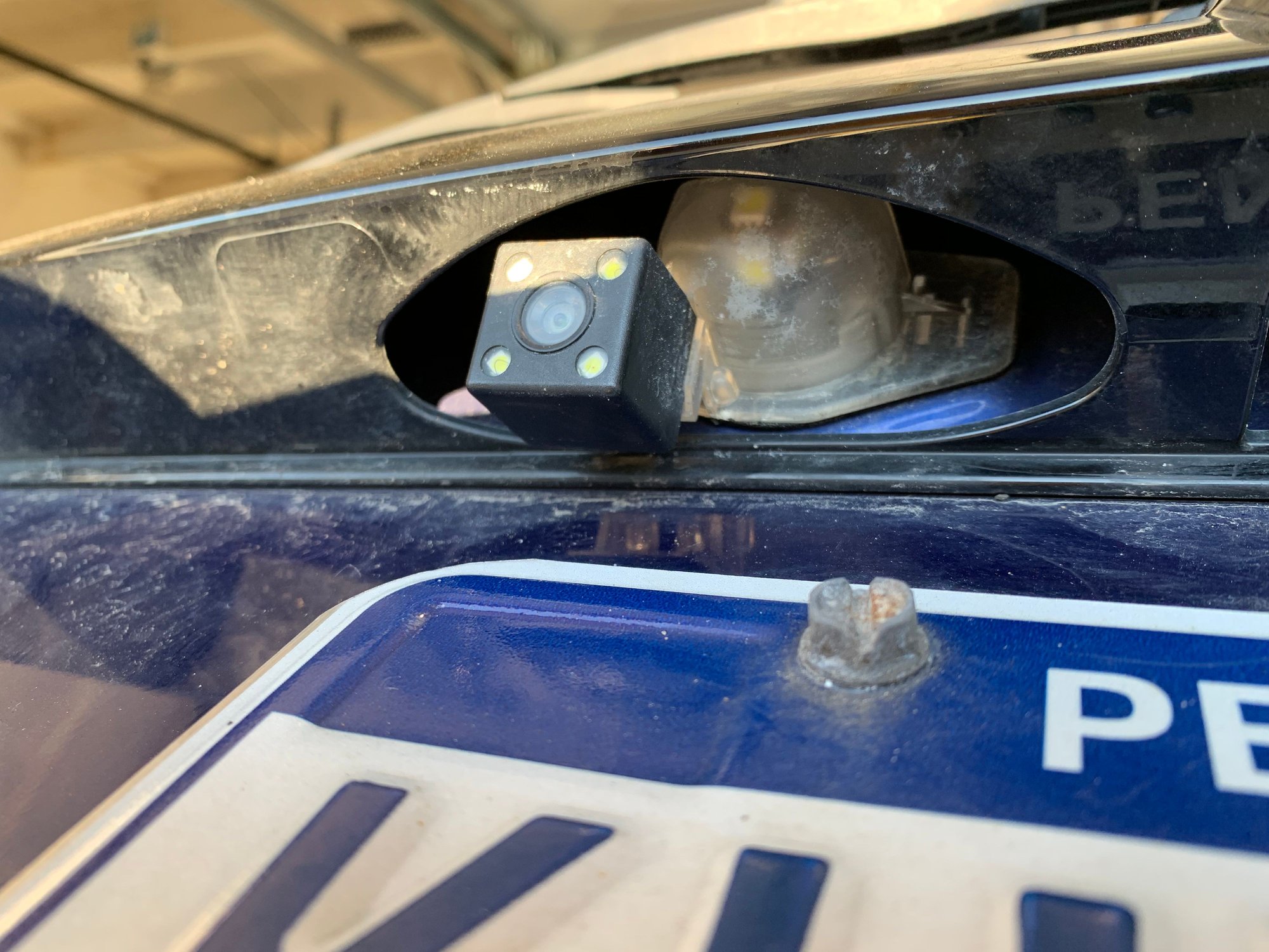

Originally Posted by jthai
Sorry to bring up an old thread but do any of you have pics of what your reverse camera looks like installed? Specifically the ones that have the integrated camera to the clear reverse light housing. How low does it protrude and does it have a decent angle? I cant find any pics online of this style actually installed. Thanks.
it protrudes a couple inches below the light cover. It doesn’t protrude out beyond the vertical plane that defines the back of the car. The view angle on my camera is very wide so I can see the entire width a car behind me even when I’m very close. The camera I bought on eBay is feom
china and is really terrible quality. I’ve thought about buying a new high quality one and trying to figure out how to install it.
Photos below.

Nice! Thanks for the pics Bucho. There’s a camera on Amazon by company called Navinio that I’m thinking of buying. Does your setup change the light pattern of the parking lights when on at night? What I mean is do the two rear lights still look uniform?
