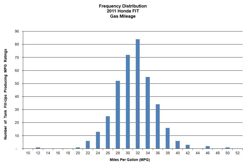

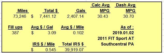

I'm running 205/50-16 tires on 16x7 wheels, significantly reduced highway miles (better MPGs) to work, increase local miles (worse MPGs), inching my way to a solid lifetime average of 30 MPG at 73,000+ miles. Also note, that "on average" the dash MPG meter and the hand calculated MPG do closely track one another but individual tank fill ups can produce deltas of 1-4 MPG. Disregard the IRS calcs, which can change annually. I was just looking at reimbursements on trips but interesting to note what IRS considers the cost to drive, insurance, maintenance, etc per mile and life-time of ownership. ***Please note that the "as of date" should be 2019.01.02 ****

Correct "as of" date / 2019
