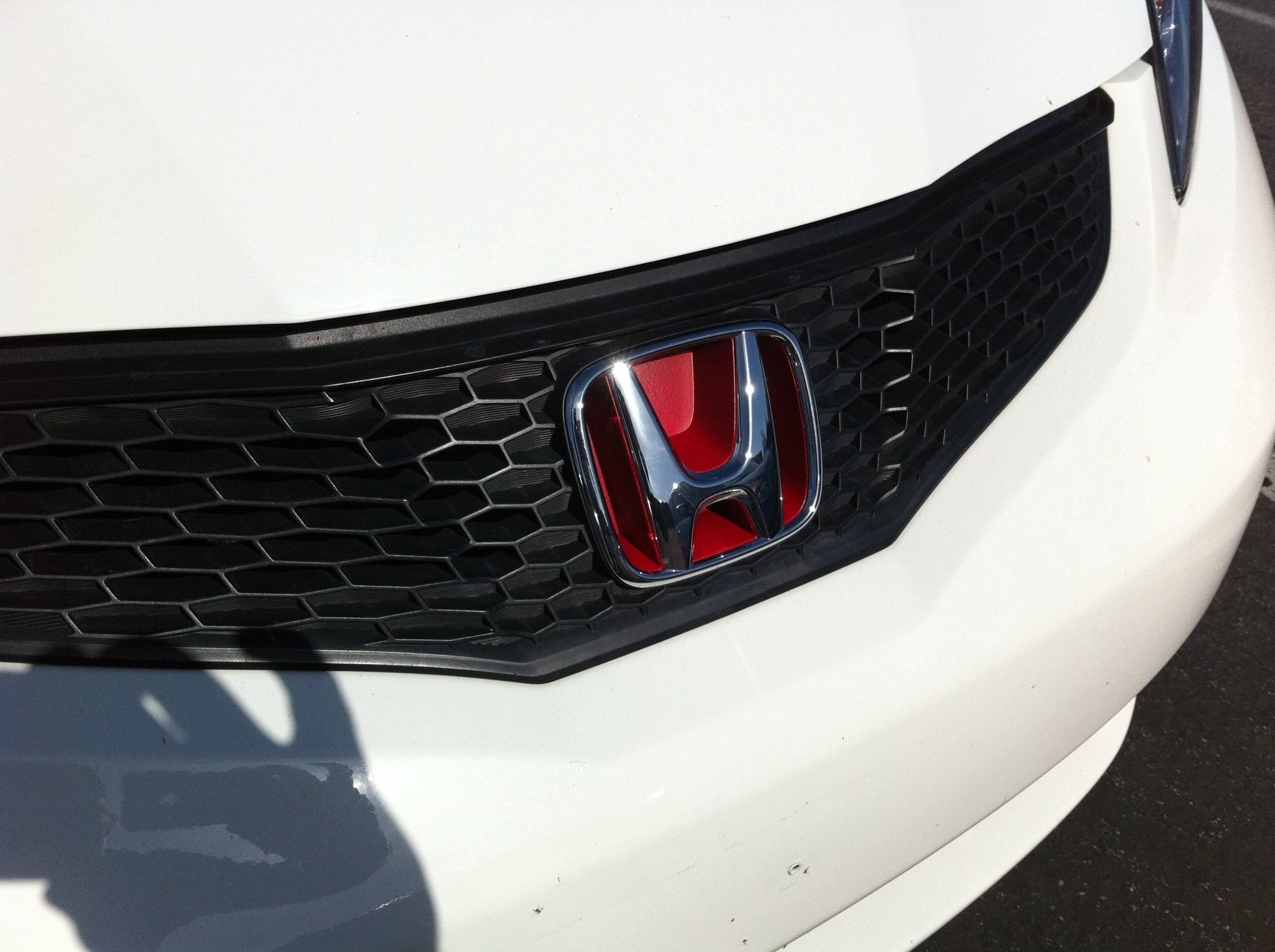

Sorry if this is heavily covered, but I am new the the boards and wanted to share.
I just got a 2010 White Fit Sport Navi and love the car, but found the color to be just too plain and simple.
I am in process of adding red highlights across the car.
First I added red iVTEC stickers to the back door panels (similar to the civic si, but with the SOHC instead) and now I have changed the logos to Red.
I don't think the J-logos are worth the high price so I went Plastidip red instead.
I think it turned out pretty nice.
Whatya think?
Before:
During:
After (Still have to clean up some of the overspray):
The front looks pretty interesting as the background is recessed. It has a bit of the prius' Toyota emblem look, but cooler.

They look pretty darn good

Look just like some of the ones I've seen for sale! The front really pops. Nice job.

GJ, the front looks really good.

Looks good, excellent masking work
I admit when I saw the second picture I was skeptical

Originally Posted by connor55
Dumb question, but how do you remove the masking without accidentally peeling of some of the plastidip? I had a really hard time with this when I plastidipped my rear bumper appliqué.
I did about 5-6 coats. First coat is a very light brushing.
Wait about 20-30 min between each coat.
After you wait the last time, look carefully at the seams.
I had a sharp exacto knife (razorblade) and ran across the seams just to confirm.
Then just carefully pull.
If you mess up (I did the first time), remask everything and start again .
I hate painting, but plastidip makes the mistakes so much easier to repair.
