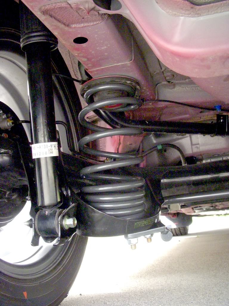

I just installed progress springs, I'm wondering if I have the back on wrong. I oriented them with the sticker they had, but ride height is like the same no difference
here's a photo

it seems to have settled better, so I think i'm good.

hope you cut the bump stops

No I didn't cut the back, I will though, just beat after the install.

So what of you don't cut the rear bump stops?????

So I put my spring in upside down to yours. Who is right???

does the springs contact the swaybar mounting fasteners at all? if yes, then chances are it is might be reversed? not sure, probably best to check with progress.
i remember back in the day when i tried their swaybar on my GD, i had to get low profile screw heads to mount as the tanabe DF210's were sitting on the bolt heads. i think they made their springs so that i makes no (or minimal) contact with the bolts.
No they don't. the new rsb bolts are Allen head. If the springs are upside down, well it still rides good! Lol
ahhhh, thanks for the info. hahahahaha.
im guessing that the progress springs have same coil wind diameter as stock as it still uses the bottom rubber mount, right? that's good to hear they fixed this problem on the GE application.

Yup I used both rubber mounts. No problems with rsb an springs. But he question remains. Witch way does the springs go? Does it even matter?
if it fits correctly i dont think it really matters. but usually progressive coil wind goes on top in a lot of applications ive seen and done in the past.

Doesn't matter which way the springs go.
