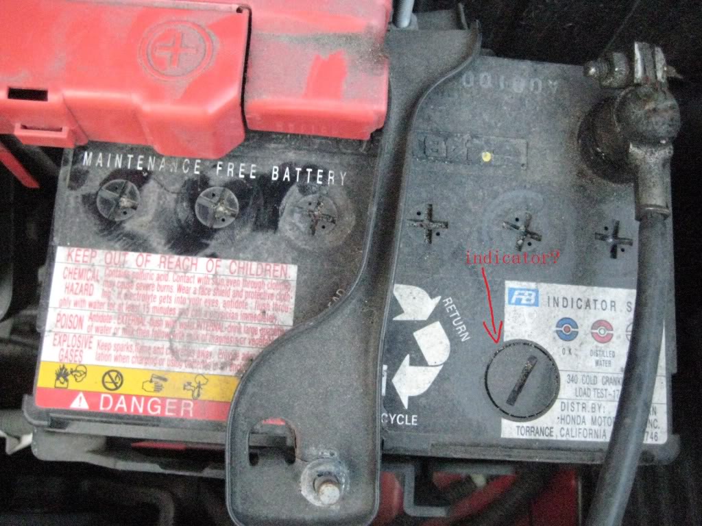

I did a jump start this morning and was advised to change the battery. I checked the manual and then for the first time noticed that there is a battery incidicator as described. However, I did not see it on my battery. A picture of it is attached. The ridiculous thing is that the indicator instruction label is there but no indicator.
Is this normal? This is the original battery since I bought my 09 fit sport as new from dealer. I bought it in 1/09, so it already passed the warranty.

The indicator is under the cap, just unscrew it and look.

thanks for the info. I thought it was under the cap, tried to unscrew it with a quarter, but it seems to be very tight. so I gave up as I did not know what it is for. Now I am going to try again.
