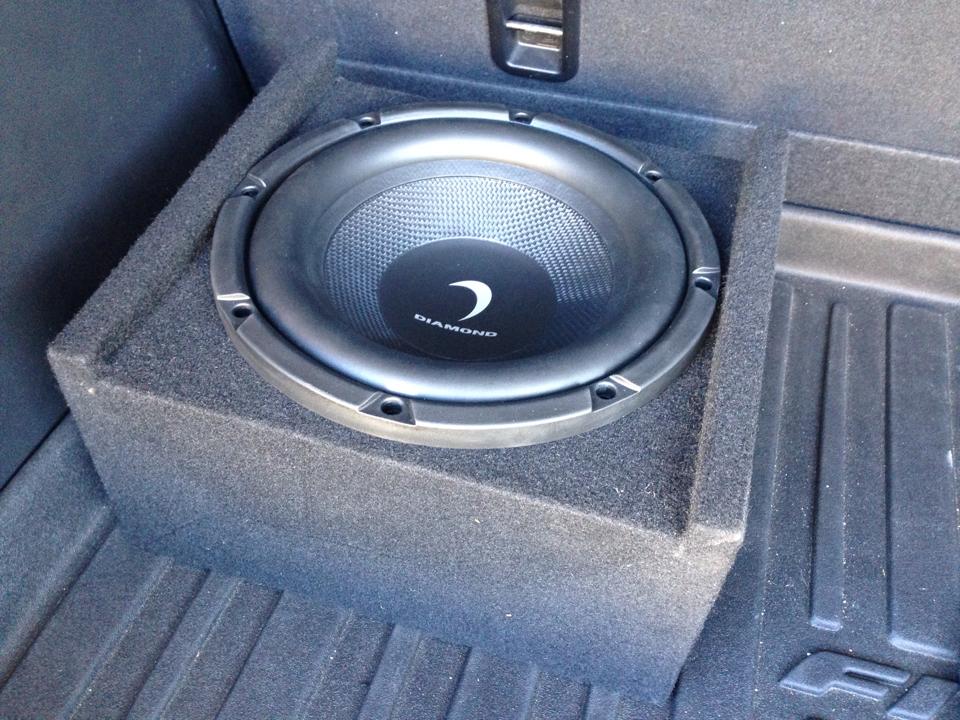

I really do not like large subwoofer boxes since I regularly utilize the trunk space. I debated on having a custom fiberglass piece made, but decided that a $35 box for now is just fine. This box is only about 5 inches high. I didn't really need to secure it either since the weight of it on the rubber mat keeps it steady. The shop created a nice harness for me so I can plug/unplug it whenever I want.

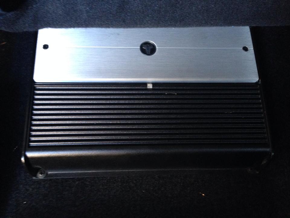

Sorry for the dark iPhone pic. Best I could do from inside the car in my garage. This is the JL Audio amplifier mounted under the driver's seat. Perfectly sized.

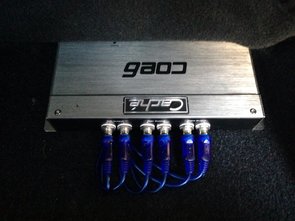

And here is the Cache COE6 sound processor mounted under the passenger seat.
