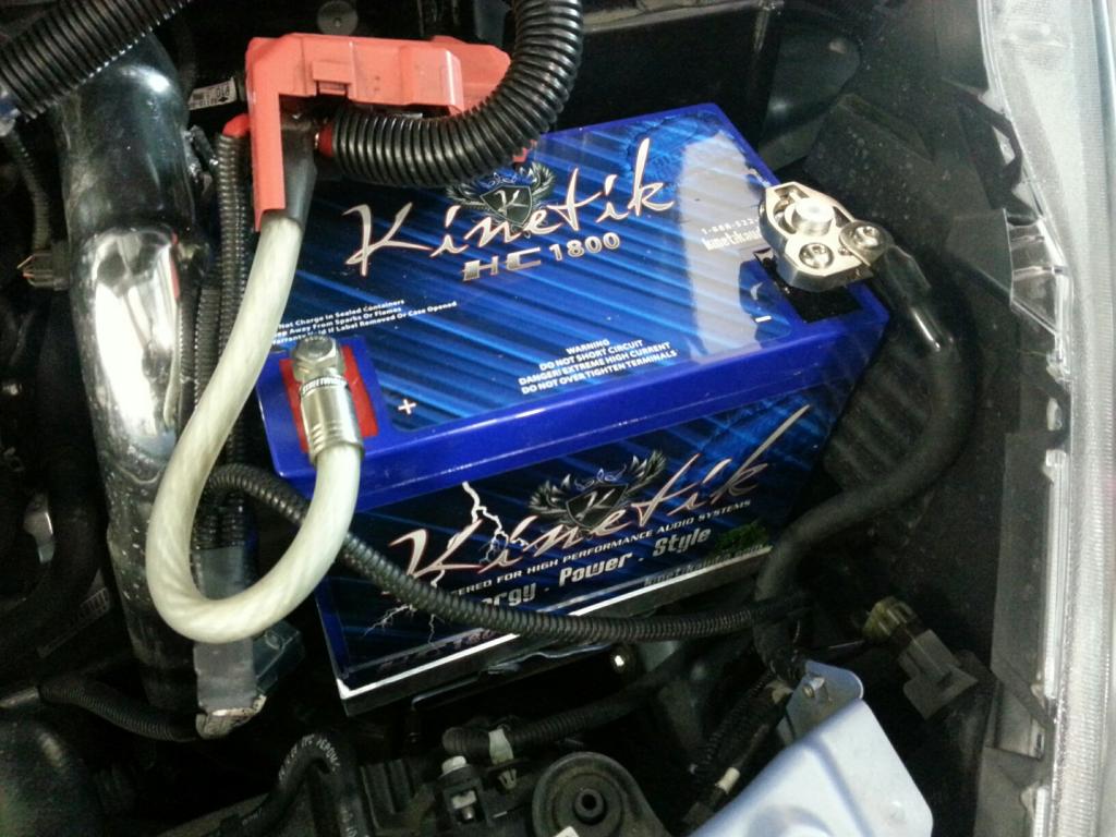

My little battery...LOL

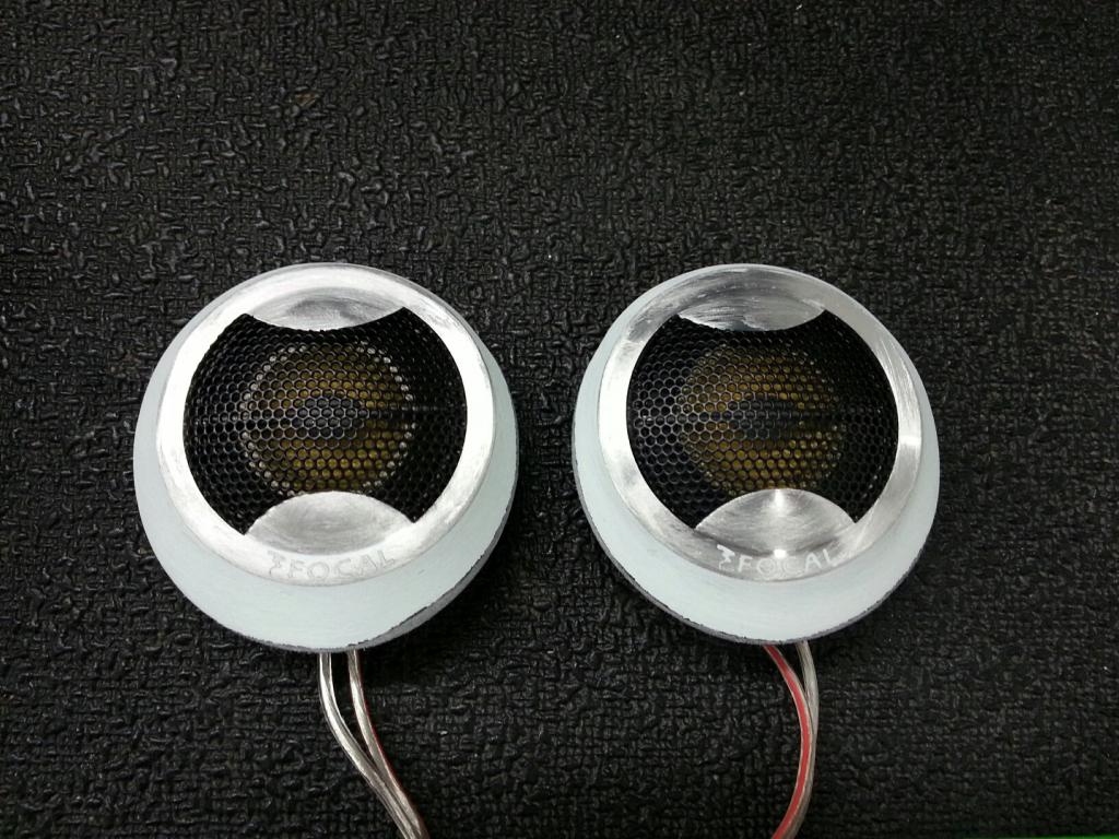

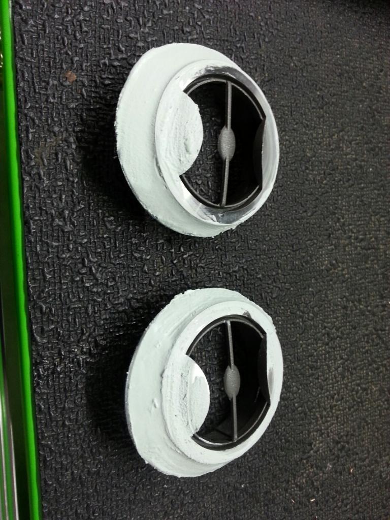

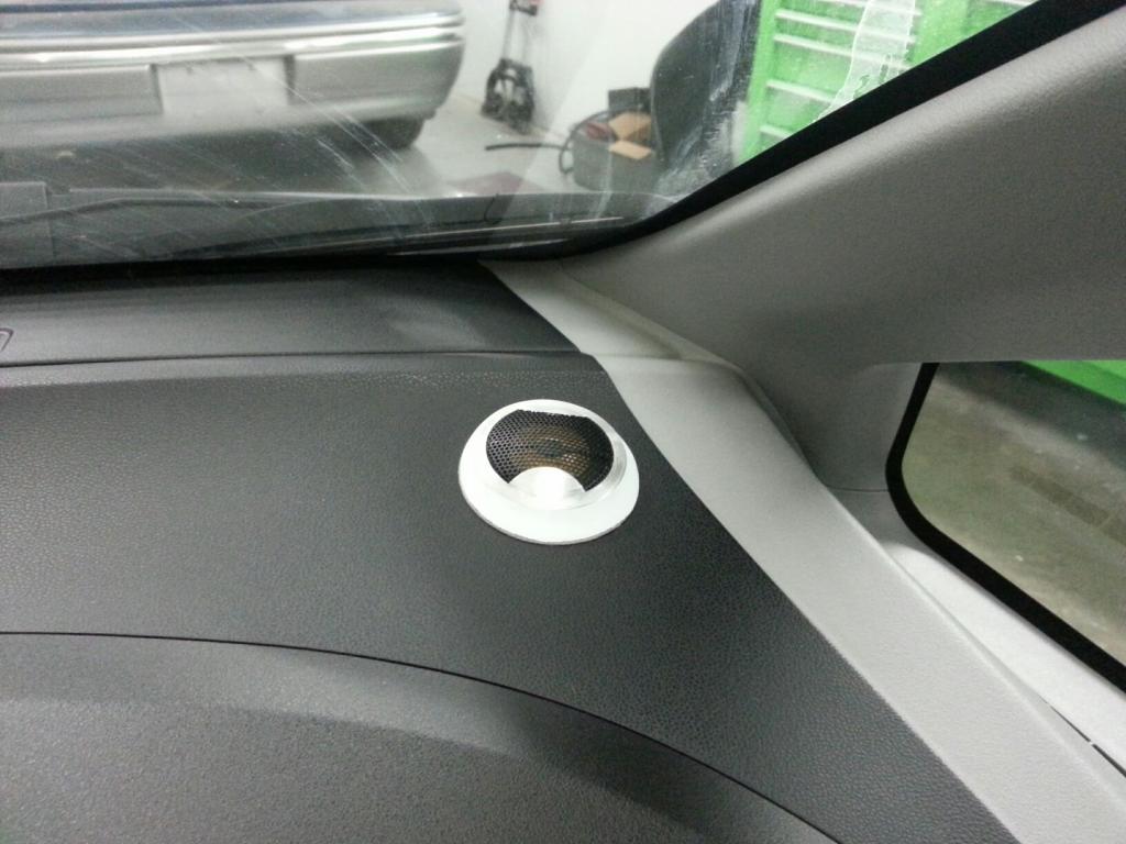

Starting up the tweeter 'pods'. The KRX2 tweeter cups fit in the grille area of the factory tweeter after I cut it out with a dremel.
I filled in the Focal logo because I wanted the pods to look somewhat stock:
A little test fitting...looking pretty good!

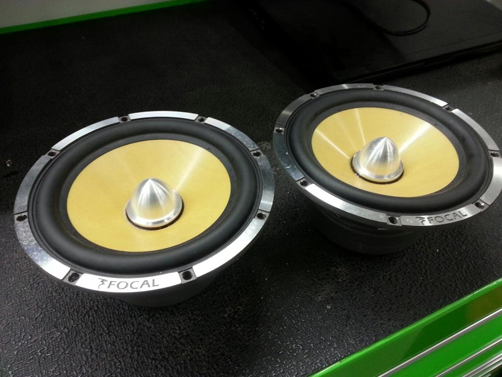

The mids are next. First I wil need to sound deaden the doors.

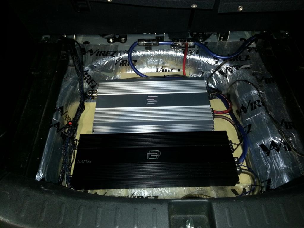

The amps are all wired up and bolted into place. Lots of nice, clean power!

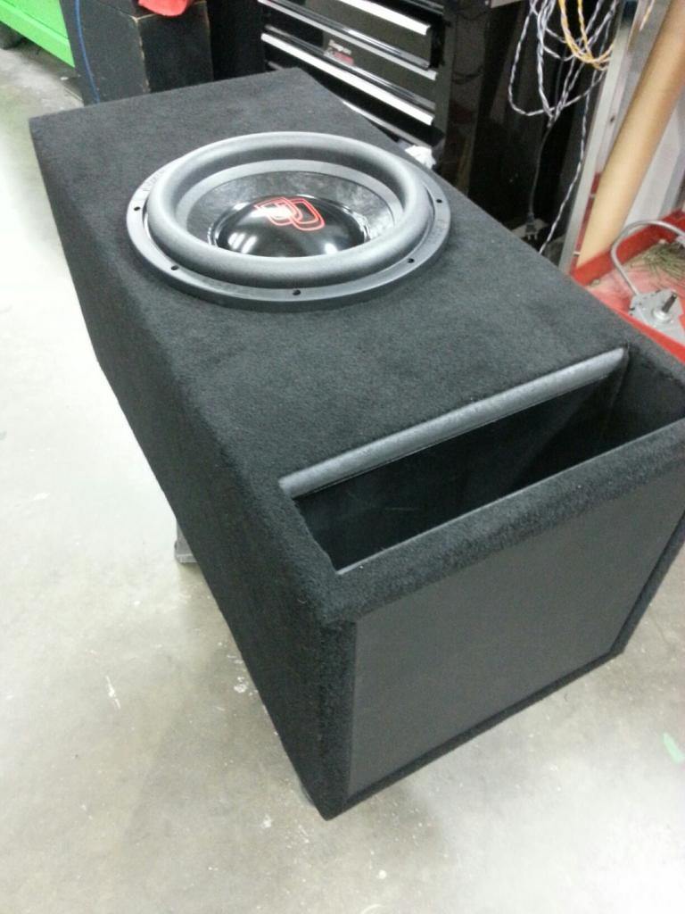

Here's the beast of a sub! It absolutely pounds like you wouldn't believe. I figure it's hitting about 144 or so DB. Still, this sub and enclosure were meant to sound clean and smooth!
