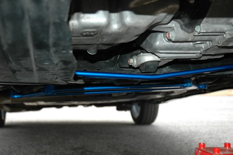

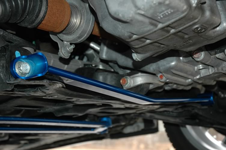

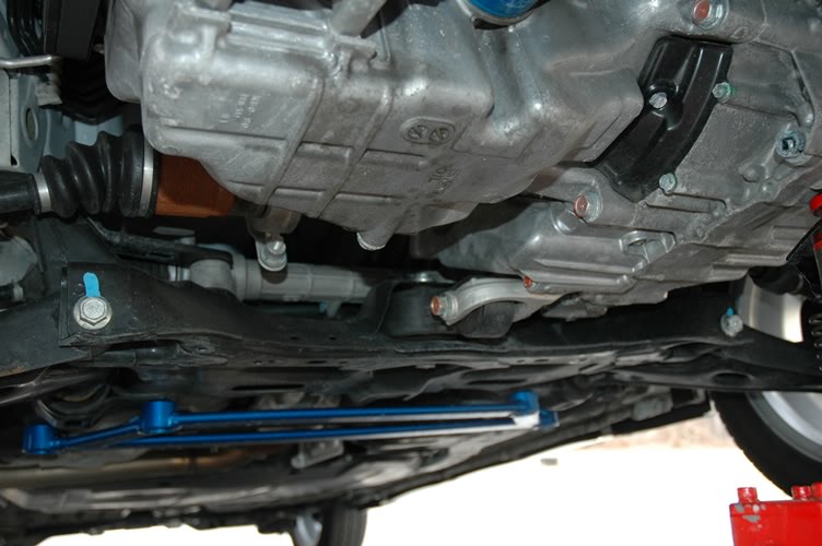

Accessory: T1R B-MAX LOWER A-ARM BAR
Part Number: 74350-ZFA-T1R
Manufacture: T1R
Cost: $76.50
Install Time: 30 Minutes
Installation Instruction
1. Remove the splash shield (A)
· From the wheel arch on both sides, remove the clips (B) securing the front splash shield and the front inner fender (C) to the body, and remove the clips (D) securing the front splash shield to the body.
· From under the front bumper (E), remove the clips (F) and the screws (G).
· From under the body, remove the clips (H).
· Release the hooks (I) of the front splash shield from the front inner fender, then pull the splash shield out.
· If necessary remove the screw (J), then remove the engine under cover (K) (for some models).
· NOTE: To remove the clips, pry the inner pin up at the edge near the line (L) on its head.
2. Install the splash shield in the reverse order of removal, and note these items:
· If the clips are damaged or stress-whitened, replace them with new ones.
· Push the clips and the hooks into place securely.
