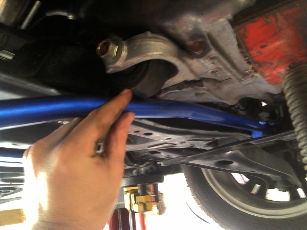

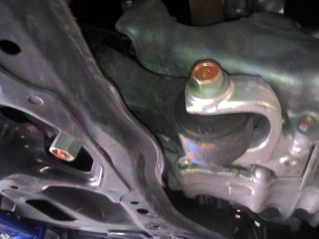

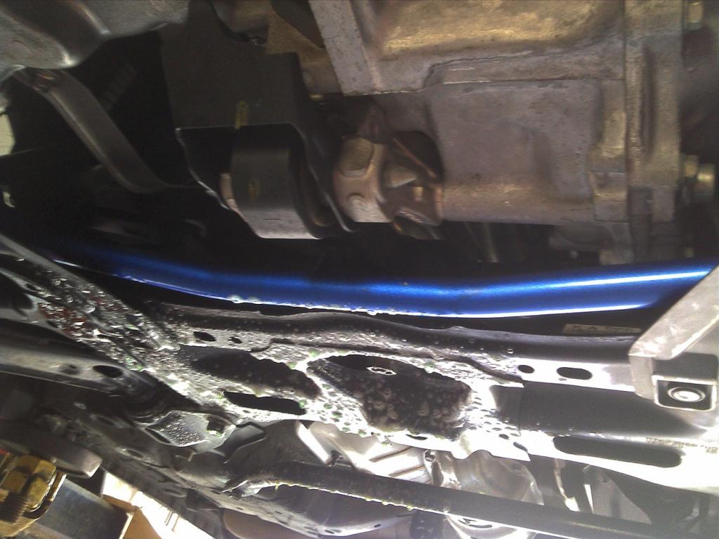

UPDATE: SAD MODE ACTIVATED

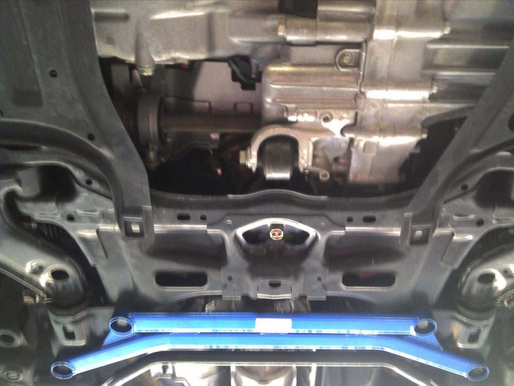

So it turns out that the Cusco 2-point brace (part#376 475 A) does NOT fit the automatic GE8. The transmission mount is in the way. However, it fits perfectly on the manual, which has the mount farther towards the front of the car.
On mine:

On Matt's (swflej1):

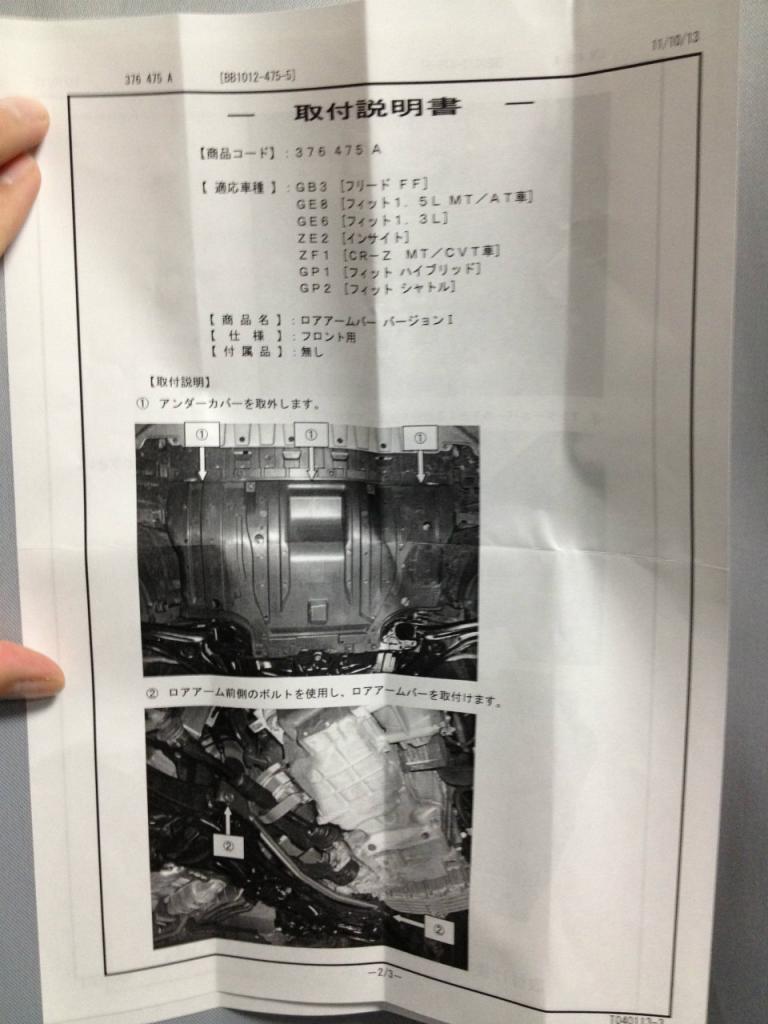

The documentation that came with the brace indicated that it fit both the manual and automatic:
I'll shortly be getting in contact with Spencer at BeanGarage and let him know. We are also looking into the T1R brace and whether or not if fits the automatics. If someone with an auto has one installed, feel free to chime in.
On a side note, when I placed the order from Bean Garage, Spencer informed me that the 376 475 A part was an updated version made to fit both the ZF1 and the GE. I was informed Cusco no longer made the original one, which is 386 475 A.

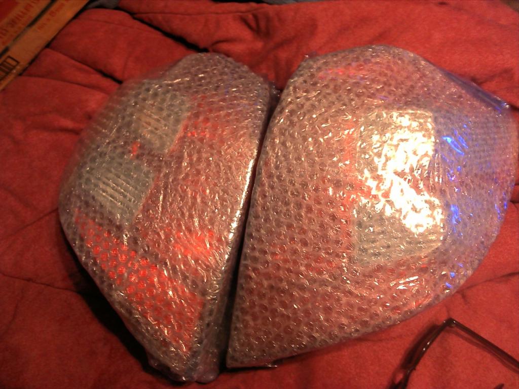

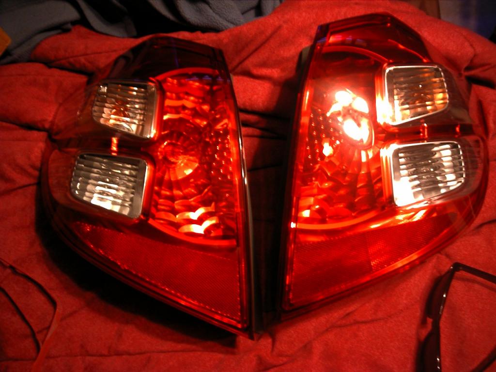

Just came in from our overseas friend Danny Pal:
Gonna try to install them today, but my wrist is all fucked up and full of tendonitis or something.

I sent my payment on January 13th and got my tracking number on January 21st. So total time about 19 days from payment to arrival.

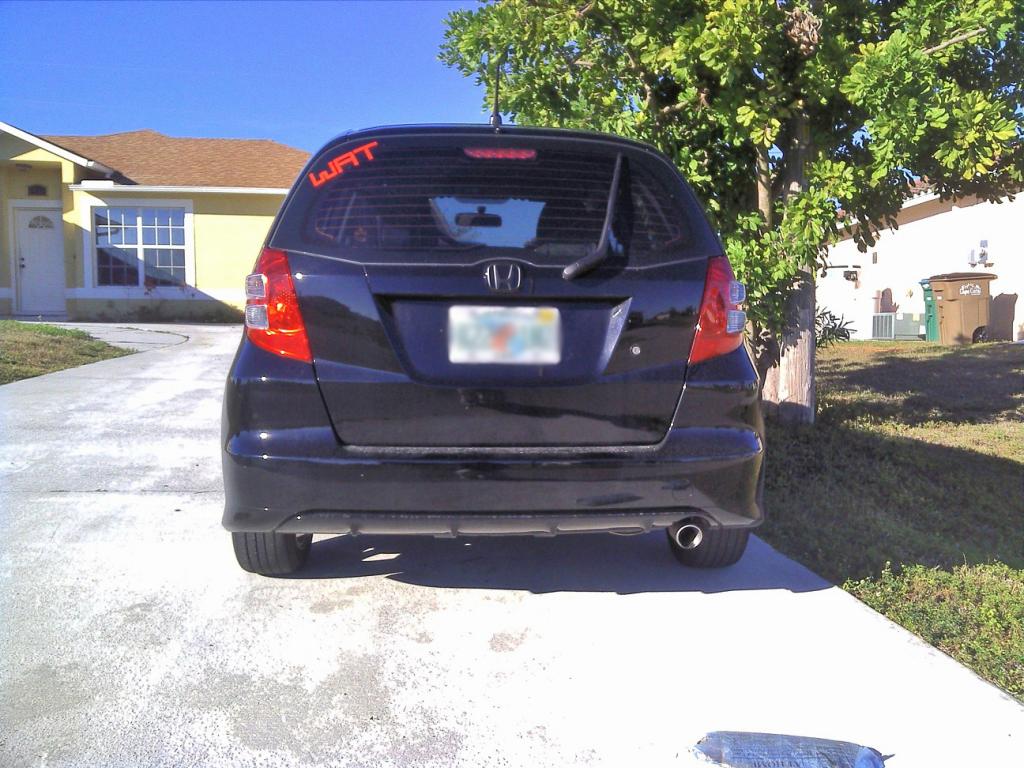

Got them installed, with a little hassle from my stupid hand:
My god, she needs a bath.

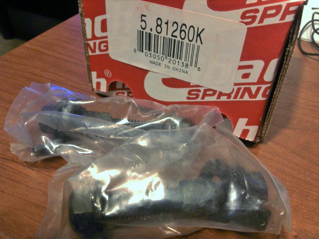

Small update, but a precursor to the large one that is about two weeks away:
I'm sure you can infer what the big update might be.
