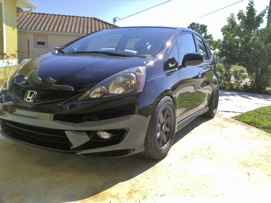

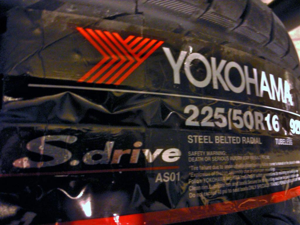

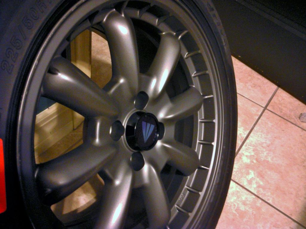

New wheels arrived today. 16x8 et25 Enkei Compe wrapped in 225/50 S.drives.

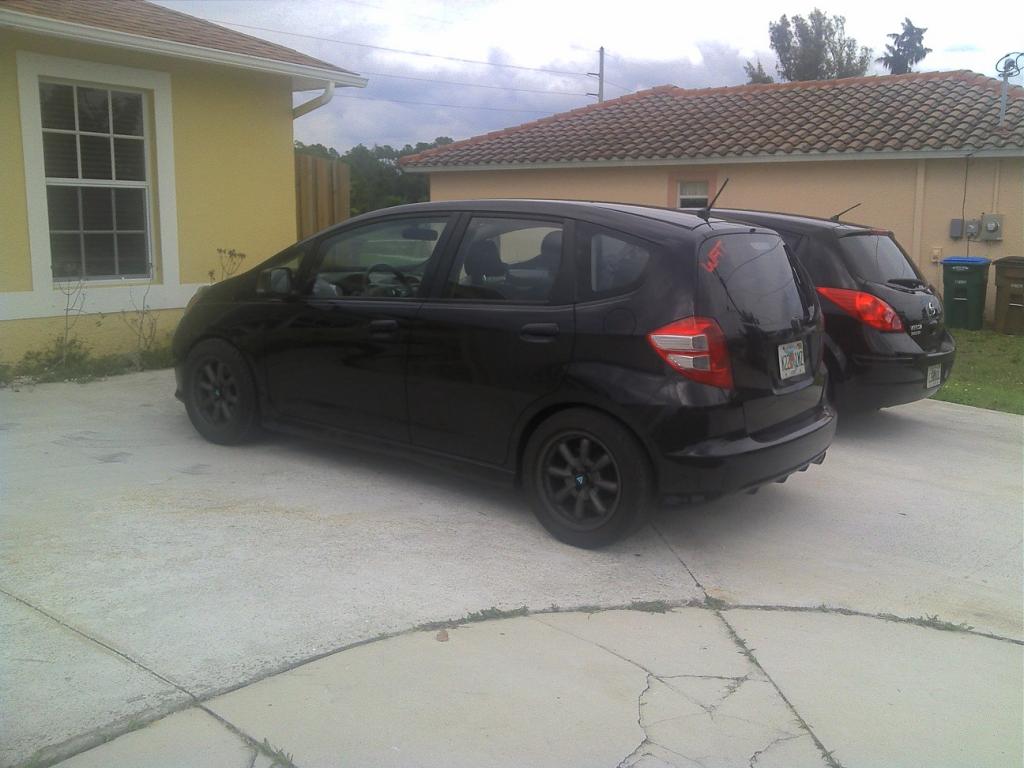

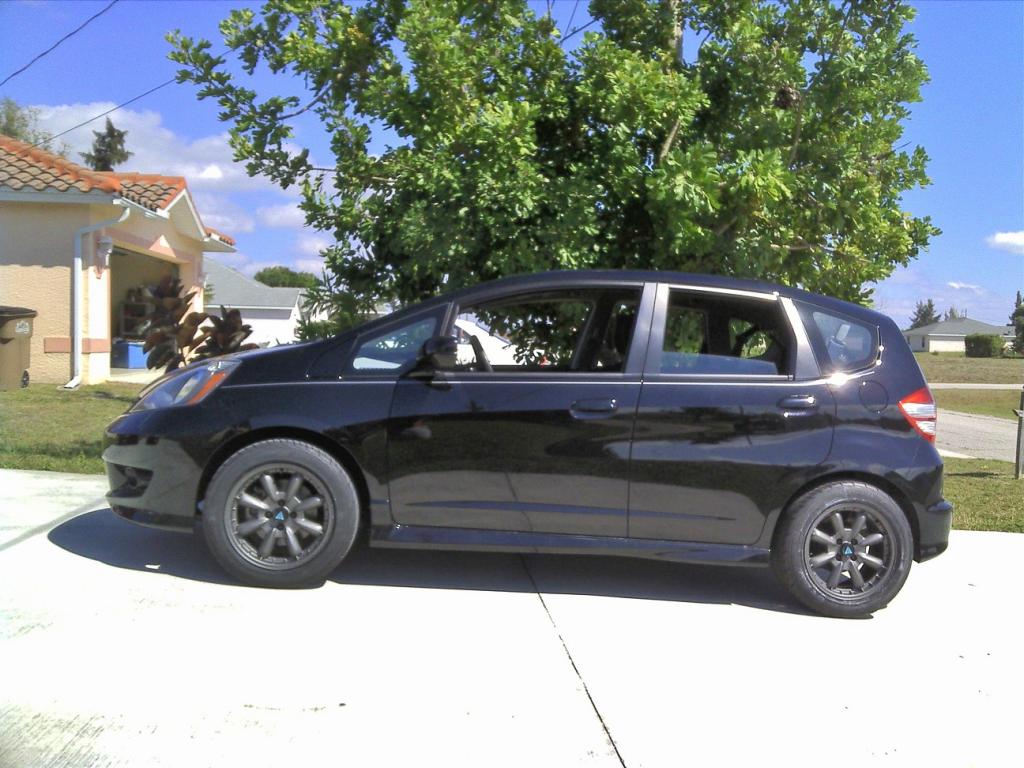

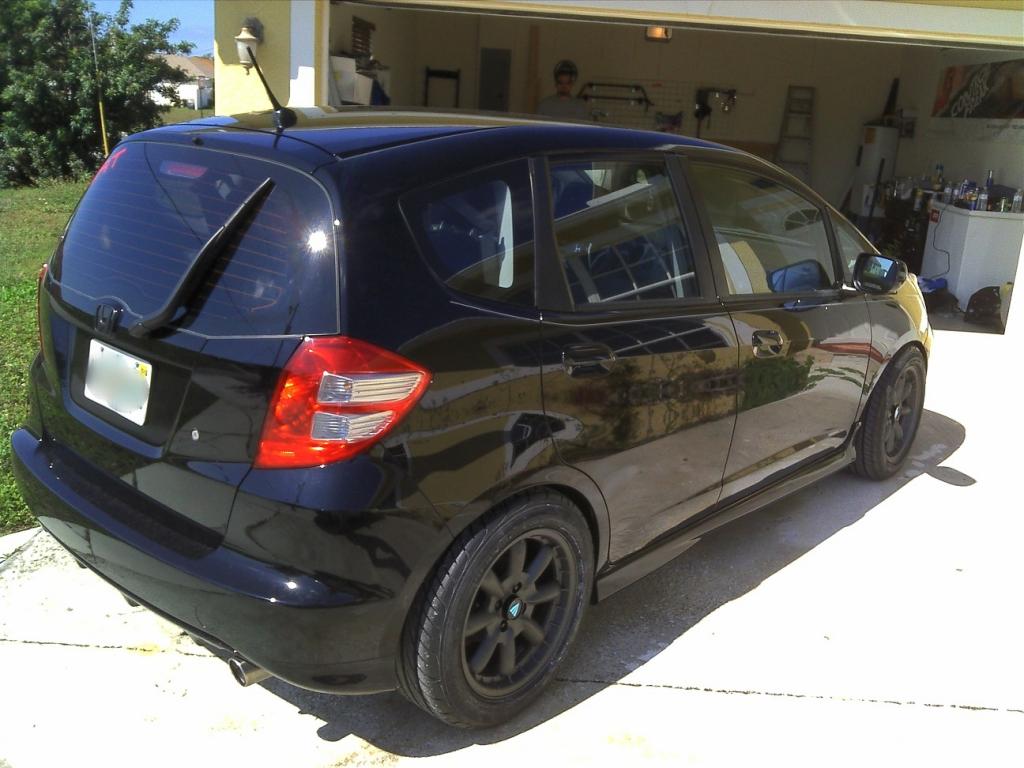

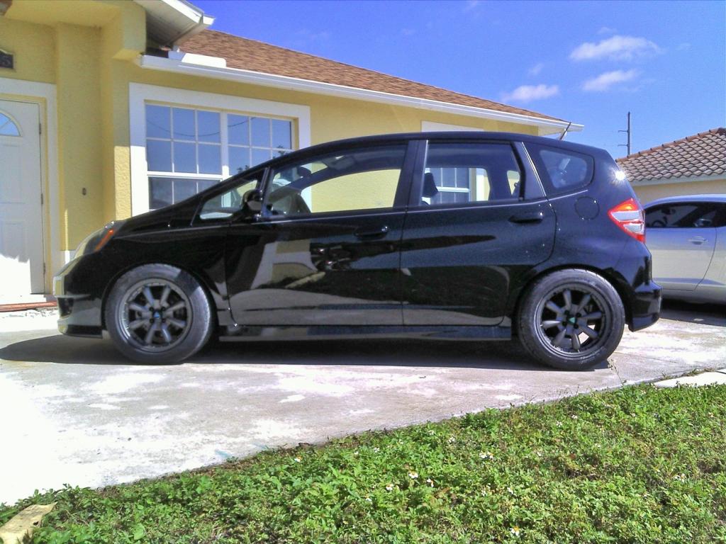

Well, after two solid days (including day one ending at 1 a.m.) my friends and I finished work on the car.
Now for the bad news:
They didn't fit
There was way too much rubbing both front and rear, even with spacing the front fenders out almost an inch, rolling and pulling, and camber bolts maxed out (so far as we could tell). They were also rubbing on the inside of the wheel well while turning, and on less than full lock. It was just too much meat with the car lowered.
We even ended up hammering and grinding the inside of the well where it was rubbing and cut most of the fender liners away.
So we ended up taking out the B&G springs and putting the stock ones back in. SMALL SUZUKI-ESQUE 4X4 MODE ACTIVATED:
At least the wheels look fucking great. We figure going with 205/50's or even 215/45's next time around would resolve a good chunk of the rubbing issues. I'm just glad it's drivable now.

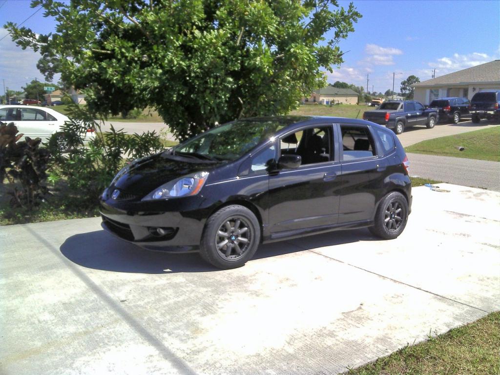

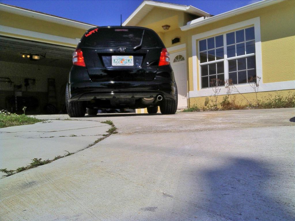

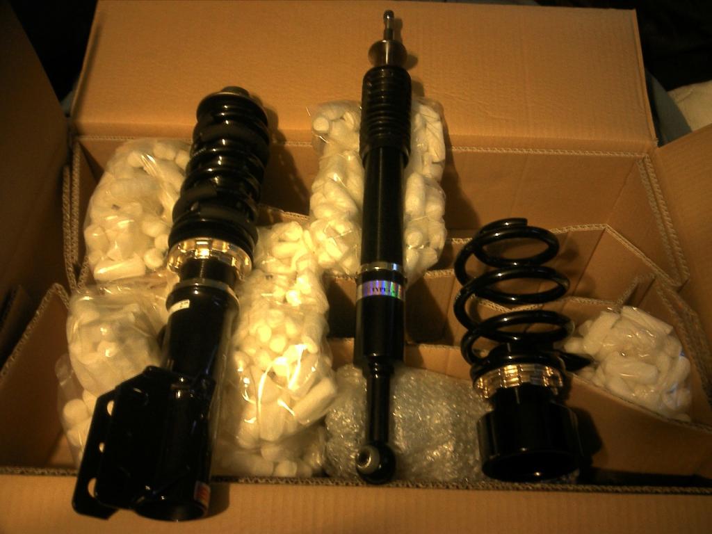

Coils in! Sorry about the shit-tier pictures, and the stank nasty car. Tomorrow is detail day.
I have the dampers set at 15 clicks from soft, and I only rub with four people in the car while taking corners aggressively. It can still go a tad lower without increasing the rubbing too much, but I'll keep it as-is until I get some less meaty tires on.
The BC's ride quite nice as well. Again, the dampers are set at about medium stiff, with 7k/f and 6k/r spring rates. We first tried 5 clicks south of full stiff, but it had that bouncy effect. It rides a lot better than my B&G springs, that's for damn sure. Also, body roll is almost completely gone.
BCRacing gets a thumbs up as far as I'm concerned.
