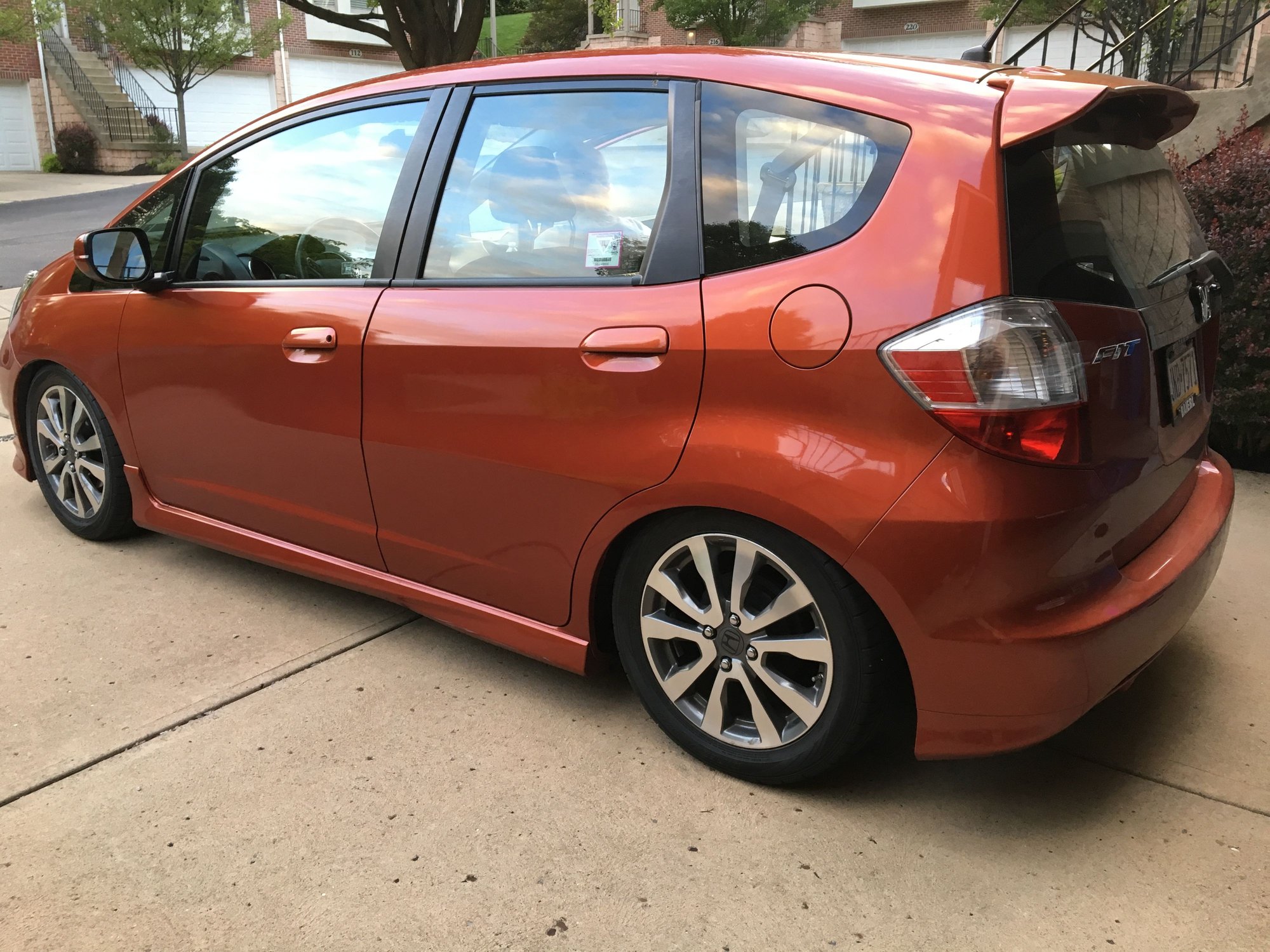

Hey guys! I've had great luck with this setup so far and just wanted to post about it. There's slight rubbing near the fender clips and, after adding about -1.5 degrees of camber, there's no rubbing at all. The car sees track work on the regular so it's holding up pretty well!
Dunlop Direzza101 205/50/R16
Megan Racing Coilovers with a 2" drop, firmness at 22/30
Stock sport alloys
