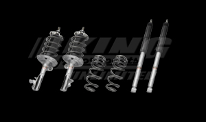

from the pictures above, does it mean that the rear spring is now located on the shock absorber and no longer separate like the normal set up? which one is better?
and
I see that King Motorsport sell this, but the price is kinda high...
any other place that well this Mugen Coil Over in US?
don't want to order from Japan...
Old Feb 5, 2013 | 10:57 PM
  #32
BMW ALPINA's Avatar
Joined: Jan 2013
Posts: 2,449
The pictures on King motorsport website is different..
it has the separate rear spring and shock setup...
which one is correct ?
Old Feb 5, 2013 | 11:42 PM
  #33
Posts: 7,624
The latter.
