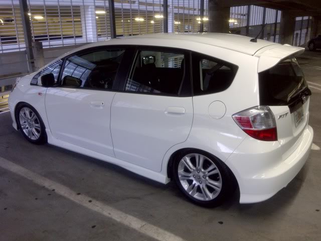

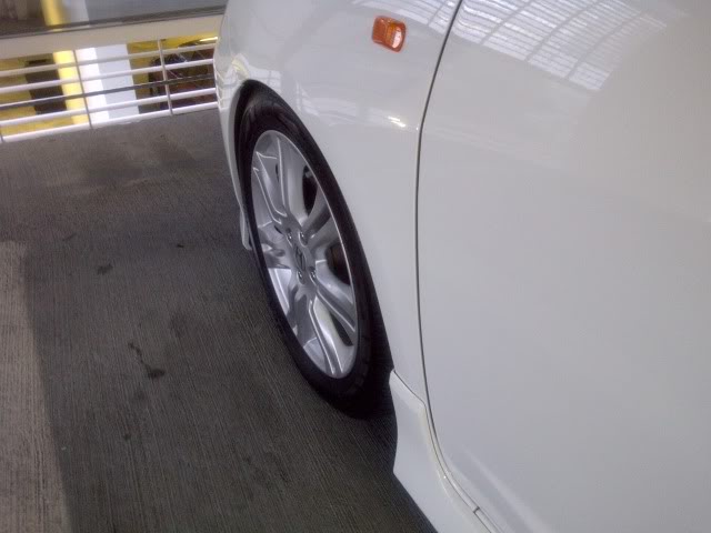

Hey guys,
I love my Fit and I especially love my drop.
BEFORE ANYTHING
All your help, knowledge, and insight on this is definitely appreciated. So thank you in advance.
Suspension
Buddy Club N+ Coilovers
Question
Has anyone here, preferably with a GE8, ever experienced positive camber when dropping their car?
Fact?
Normally when lowering a vehicle, a negative camber occurs. Notice my question mark on Fact. LOL. But I have read on lowering vehicles and the effect on tire positioning when lowering, messes the toe alignment and the camber alignment in a negative position.
In My Case
A positive camber occured. Not to a crazy degree visibly, but its still positive.
Solution?
Camber bolts must be the solution. If so, which ones? Please dont ask me to search it as I already did and members are all over the place as to which to go with. I have seen everything from using GD3 camber bolts to using Si camber bolts. Has anyone actually tested, with proven results, any camber bolts for their GE8?
Answers to your Possible Questions
1)Have you gotten your alignment after your drop and in what time frame? Yes, after putting 100-200 miles on the new setup.
2)How low did you go on your new setup?
2-2.5 inches in the front. 2.5-3 inches in the rear.
3)Is that a Toe alignment issue I notice on the picture you provided below?
No. That is my steering wheel turned oh so slightly to the left when I left the car in park.
4)How did you go that low?
PM me.
5)Can you go lower?
In the front, yes. About another inch. In the rear, no.
6) <BLANK>
Left blank for future questions. LOL.
Pictures
You probably cannot see the positive camber from the pics, but some of you maybe interested to know as to why my wheels are so straight with such an aggresive drop.

Sorry, but this is impossible with the GE, or any other suspension design unless your coilovers have adjustable camber correction. I don't know how you could install them wrong for this to happen either.

I understand why you would be confused too lol. But there is no camber correction on any of the coilover kits offered for the GE8. But what i do know for a fact is that i installed the suspension correctly. I am very familiar with coilover setups and installs on many applications. Fortunately, those other applications had camber adjustment from the camber plate. Unfortunately, the GE8 dont allow them on the coilovers themselves. Camber bolts will be necessary, which just arrived and I will be installing soon.

It is unclear how you know you have positive camber, because it looks similar to other lowered fits...
Do you have the spec sheet from the alignment shop that shows the positive camber, or are you just going off of how it looks?
Also, you can get honda camber bolts for the civic that work as well on the fit.
