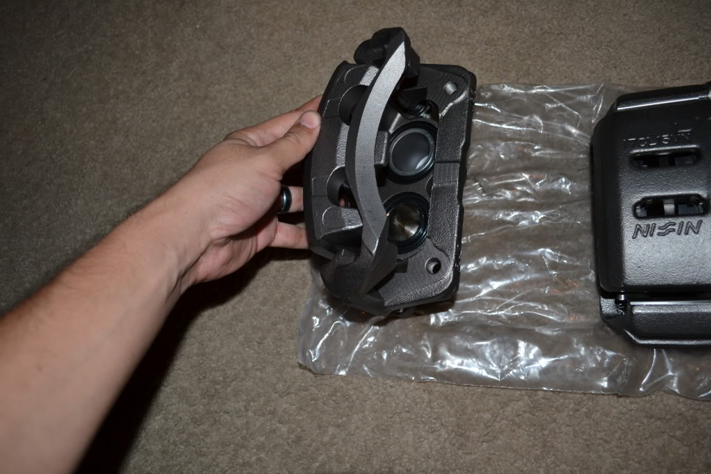

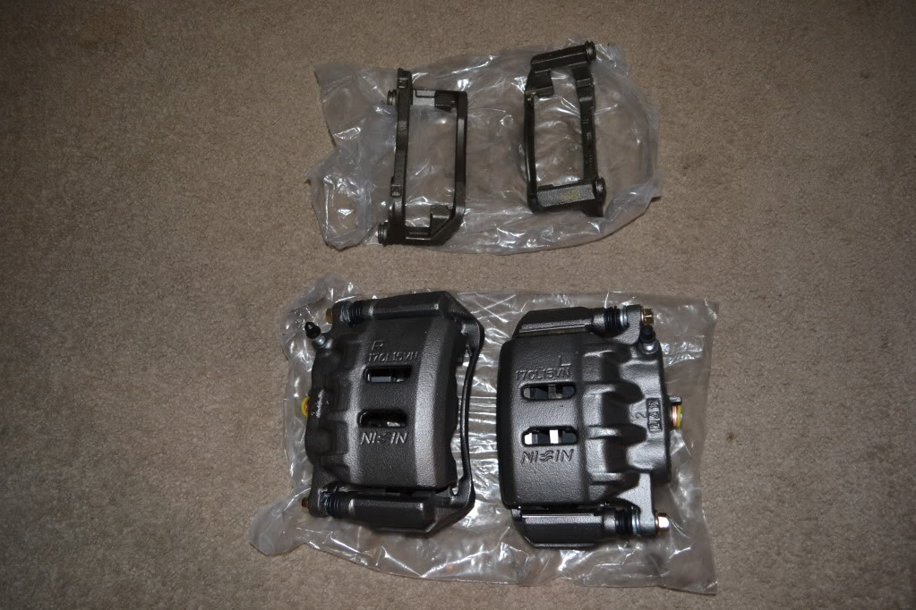

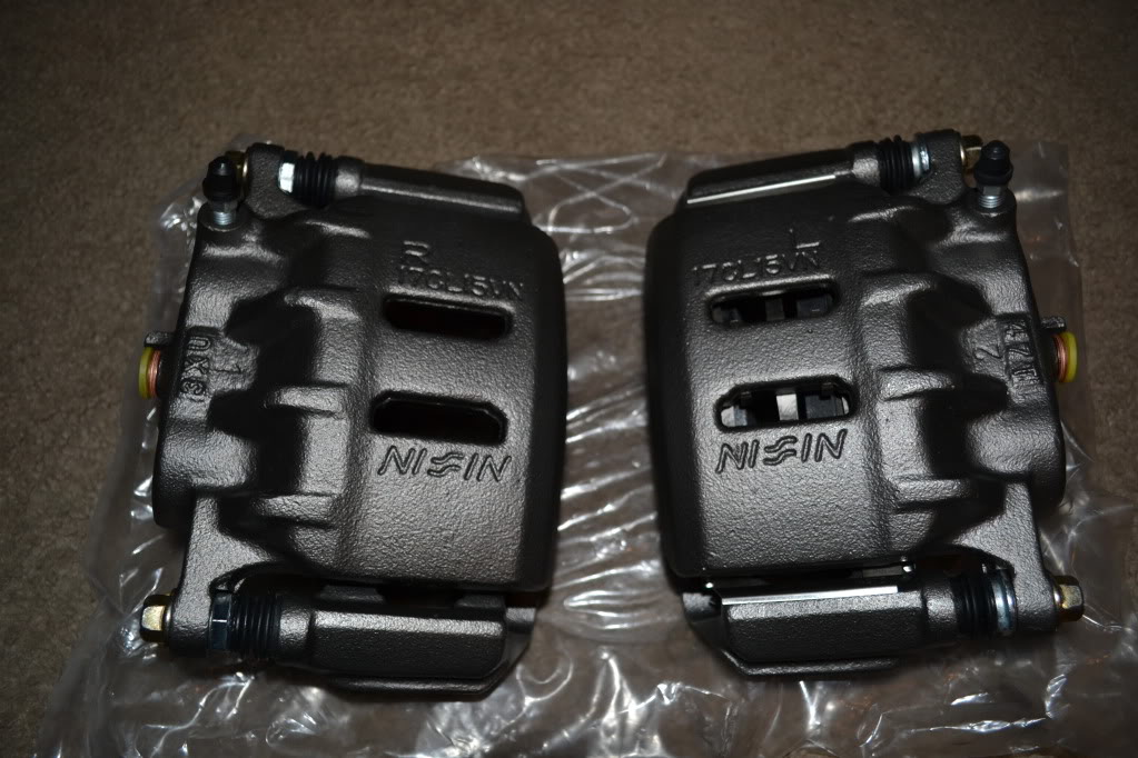

I have a EJ1 that I was going to build, but I just don't have the dedication or time to work on it, and I keep wanting to Mod my Fit since it my DD and come to the conclusion to drop the EJ1 and just work on the Fit.
So here is where the Over Kill part comes into play. I was checking out fastbrakes.com and saw a 11" Front BBK for the Fit, It comes with ITR calipers and modded brackets with 11" rotors and brakes lines. So I stop to
think I just got some ITR Brackets and some Legend calipers, I'm waiting on a e-mail back from fastbrakes to see what rotors and adapters (if any) i need. So tomorrow at work I'll be doing a test fit to see and I'll be posting
pics I also need to get some new wheels .
I know its over kill I do plan on doing some auto-X soon and I plan on going back up to the dragon this year as well, so I do have some what of a reason. So comments are welcome good or bad.

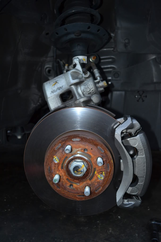

I didn't Have the right parts what i thought was itr brackets were gsr brackets and doesn't fit Legend calipers

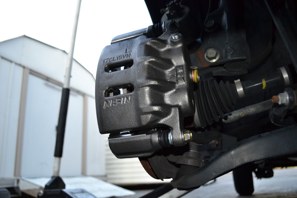

O.K. So today at work I had some free time and got to play with my Fit. So I test fitted the Legend calipers, Both the T23 and T28 brackets bot on no problem. How ever the T23 bracket I thought would bolt up to the new caliper, I knew it needs to be modded, but I really don't see how its going to work. So I tried it with the T28 bracket with the caliper and it looks fine. Then I realized the T28 sticks out to far and would hit the wheel (something else I have to pick out a long with rotors). So as of right now I'm stuck I did just fine Jodele write on his Type R upgrade and I'm going to read that thread over and hope to get some info. BTW here are some shots

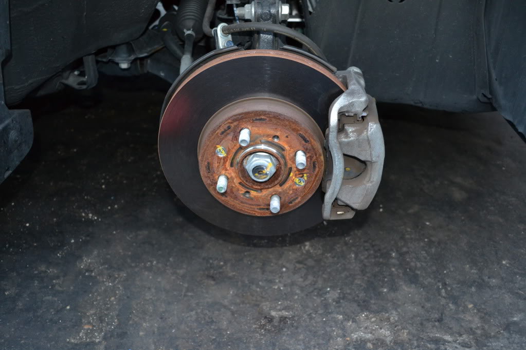

Stock set up--

Here's some with the legend calipers on

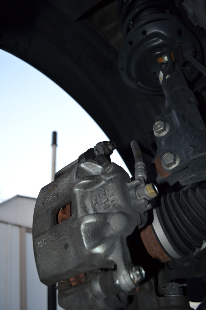

here is one of my problems I'm running into

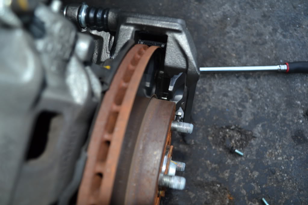

and here's another angle

Ok So I think I messed up I didn't order the ITR brackets I got the GSR one so i'm going to re-order them in the morning. Also I found this
Our rotor
BrakeBest Select 96087RGS - Brake Rotor | O'Reilly Auto Parts
07 mini rotor
BrakeBest Select 980606RGS - Brake Rotor | O'Reilly Auto Parts
So i'll be ordering them as well. Unless you guys think i could use T28 brackets
