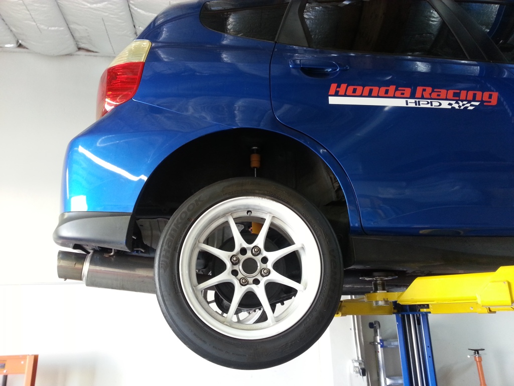

Ah ok, no problem with that really and it's convenient, I was just curious how much droop travel there was on the shocks. I expected them not to be captive, but was thinking maybe the adjuster took up some of that slack.
That is better IMO than some "JDM" coilovers that have very little droop.
Well as far as droop...

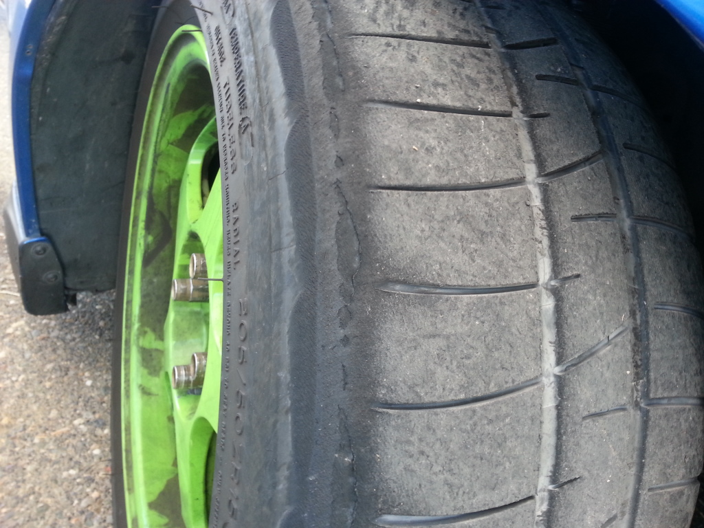

I actually removed my rear bar to also assist in cutting back "doglegging."
There is more to the story, but I was WAY overloading my outside front tires..
