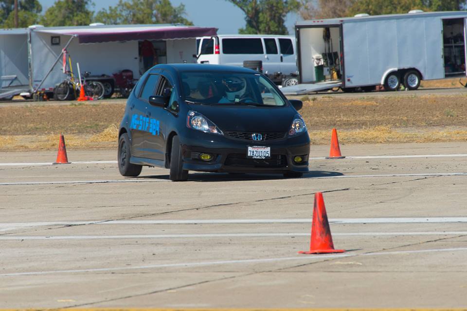

I am not the best driver. (Obviously) With about three different events with this setup I am still not used to driving the car at its limit. Running the Koni's on full stiff along with the stiff rear springs really just plants the wheels on the ground.
During my first event out in the car, I had to keep adjusting my lines through the course as I was still underestimating what the car could do.
I still have a lot to learn to fully take advantage of what this suspension and tire setup can do.
Just to put things in perspective.
Me
DoYouFit?
TPColgett
Both users TPColgett and DoYouFit? drove my car this past weekend at Crows Landing autox event. We all ran the same course in my car. Both of them beat my time their FIRST TIME in the car and TPColgett did it with VSA on...
I'm sure they can chime in and give a better description of my fits handling characteristics than I can.
Needless to say the suspension setup along with the tires/wheels is worth EVERY penny. I only wish I had gotten the chance to have a setup like this in my GD.

Hahah, that launch of mine was AWFUL. I think at around 0:47-48 in my run is when the VSA started grabbing at the brakes and its a good thing the camera wasn't in the car due to my copious use of "colorful" language
Car feels AWESOME. I'd still change a few things to set it up more to my liking (MUCH stiffer rear springs at least,) but for a GE owner, if your looking for a high performance suspension setup...
THIS IS IT!!!

Oh and if folks are wondering why go with a FSB:

I actually was a massive anti Front Sway Bar person. I thought it would only add more push and as I had worked so hard to dial out the understeer I was like WTF would I want to put it back!?..... Then I drove a near stock GD with a front bar and IMMEDIATELY "got it." I now have the T1R FSB on my car and the change in both effective spring rate and the dramatically improved turn in is EPIC
