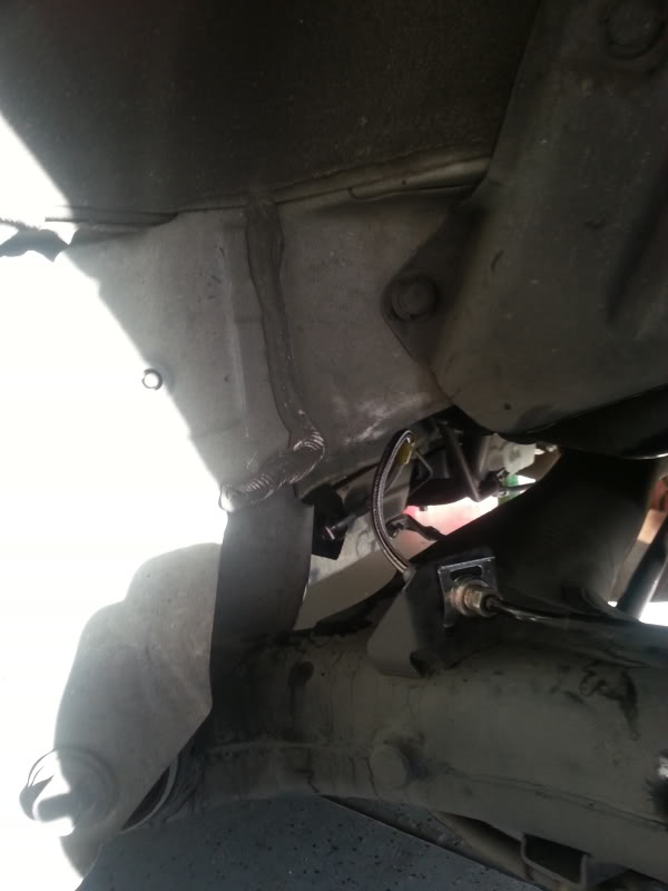

I haven't looked at the links, but here are pics of my SS line setup for the rear, I actually took some interesting enough:

Old Jan 15, 2014 | 04:34 AM

Now by looking at your lines setup for the rear, there are 2 lines/cables. Does the SS Brake Line goes directly to the drum brake? or is it still that black/rubber line that goes to the drum? Or am i missing something? LOL
Don't know how to view your picture.. Not sure if its upside down or what.
Much appreciated!

That's the top of the rear beam, the SS brake line attaches in the middle to the hard lines on each end. When you get your kit and go to install them you'll see exactly what you need to do. It's a straight forward install, hardest part is bleeding the sytem to make sure you don't have air stuck in the lines.
