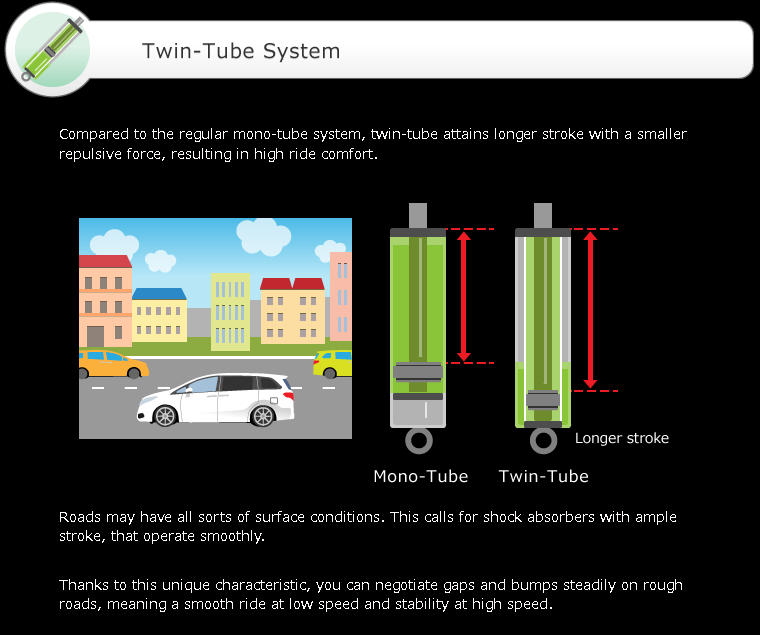

ultimate test. Are they comfy with passengers/loaded. Are they comfy over cracked roadsAnd are they comfy on the freeway. BTW are tein coil overs monotube?

these are not scientific by any means but, I'll share anyways:
-are they comfy with passengers/load = this test may never take place, as the car rarely ever sees rear passengers
-are they comfy over cracked roads = using my every day commute as a baseline .... YES
-are the comfy on the freeway = please see previous answer
-are they monotube = https://www.tein.com/products/street..._z.html#spec02
So you're saying GD3 front struts + Swift Springs are the pefect setup for GE8 owners?
