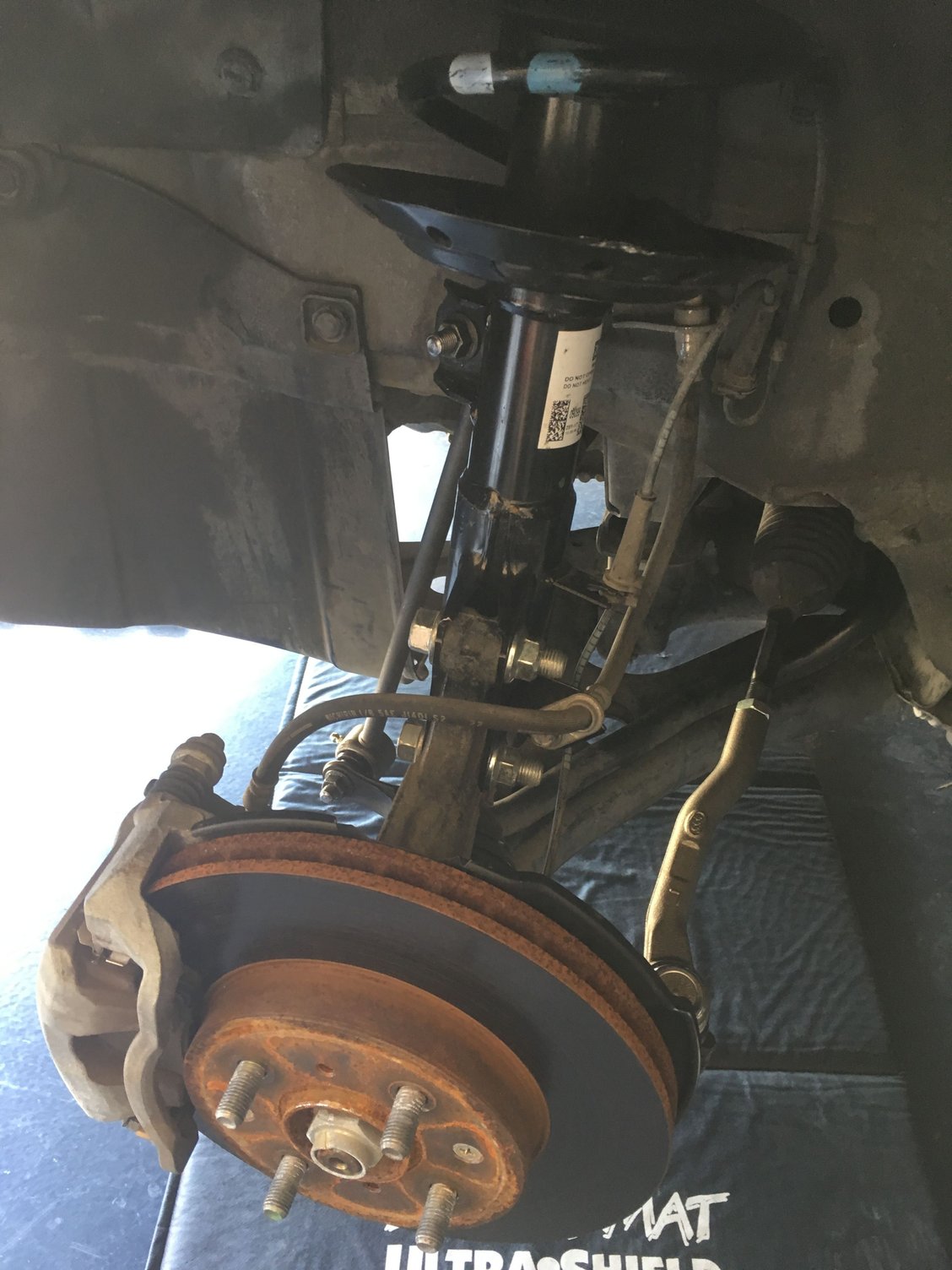

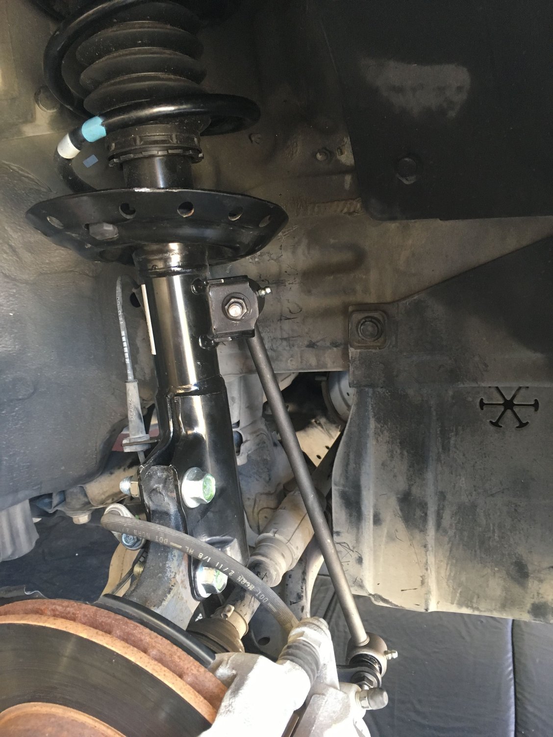

Update - I'm in the process of installing the 2018 front struts (ZF-Sachs OEM Honda take-offs) on the 2011, and they are the same size as the 2011 GE8. They fit near perfectly. There is a slight difference in the mounting point for the brake line, it is clocked just a bit, but the brake line still bolts on, and also a slight position difference for the wheel speed sensor plastic clip, which you can carefully adjust along the wire. Other than that, it is a bolt-on, works perfectly, all the hardware is the same, as are the strut mount bushings.

Here’s a picture of the install. They are exact same size, only difference is angle of the brake line mount and position (slightly lower) of the ABS sensor mount.
