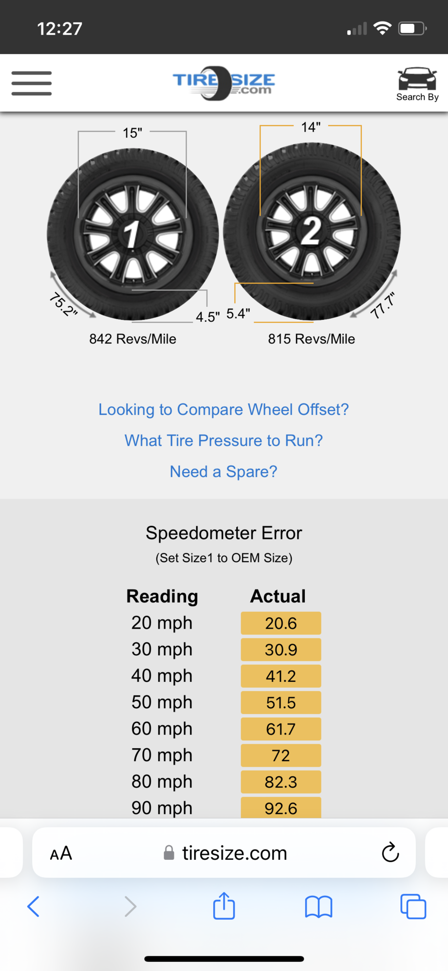

I’ve got a 2013 FIT with stock Steelies/tires (175/66-15)
does anyone know if there would be any issues fitting 14” steelies on the FIT?
many issues with the brakes?
looks like it’d only throw my Speedo off by less than 2mph@60
