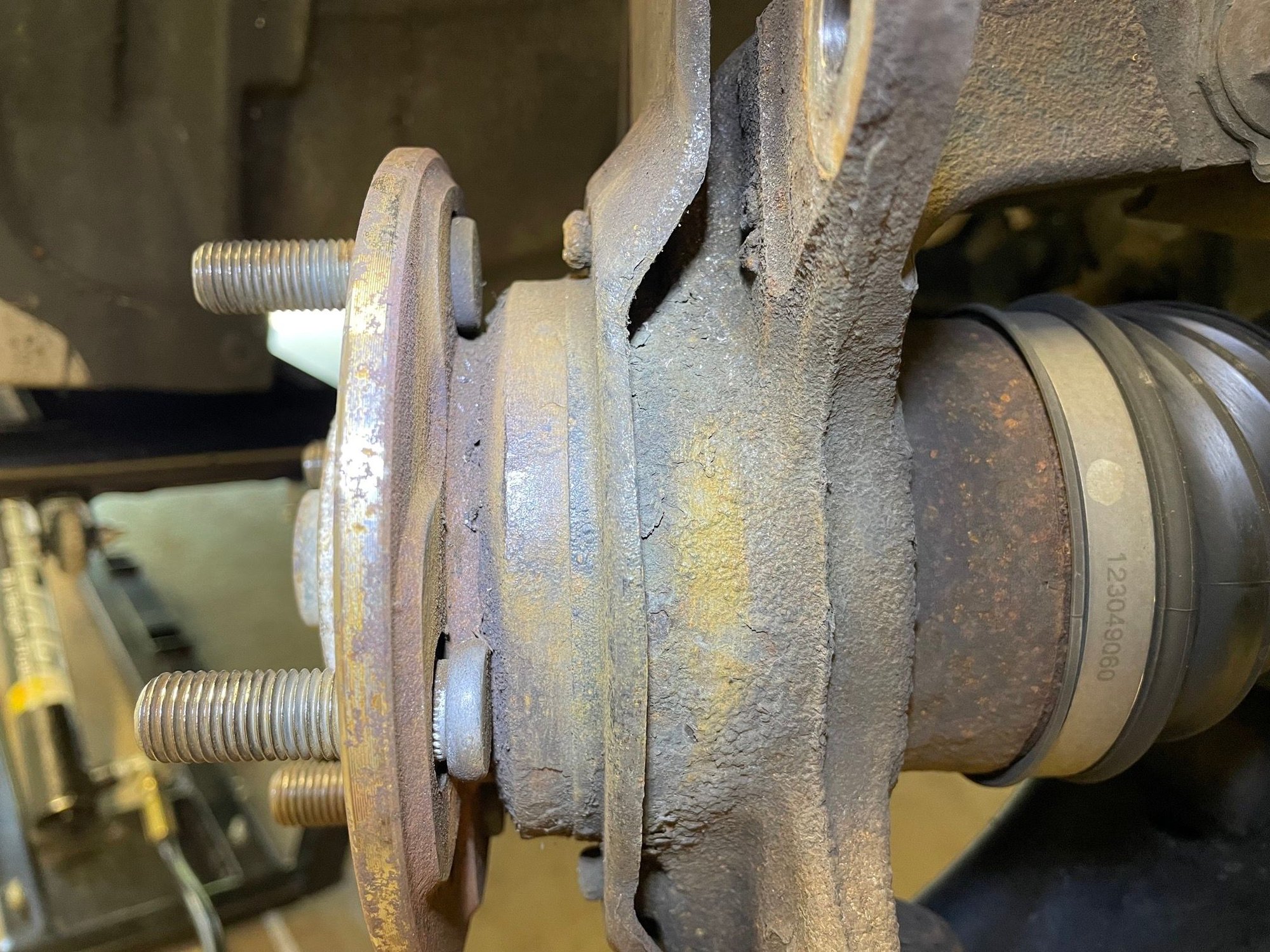

For the sake of others still doing Fit service:
ONLY WORKS FOR GD
Originally Posted by 13fit
no need for different studs unless going with longer ones to account for wheel spacers.
Next time you have a stud break on the fronts, remove the brake caliper and bracket. There is a spot there to pop a stud out.
Same with rear drum. remove drum, there should be a hole for popping a stud out.
For a GE (2009-14, and likely later also) you can NOT just bang the front stud out. There's a video of someone doing it on a GD (2007-08) and clearly there is room. So ... generation matters.
Here is me trying to push out a stud on a 2010. There's no way to grind the stud to make more room, and I do not want to attempt to grind the knuckle either.
GE 2010 wheel stud won't come out.
Sorry to ressurect old thread. Fits last forever.
