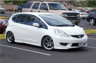

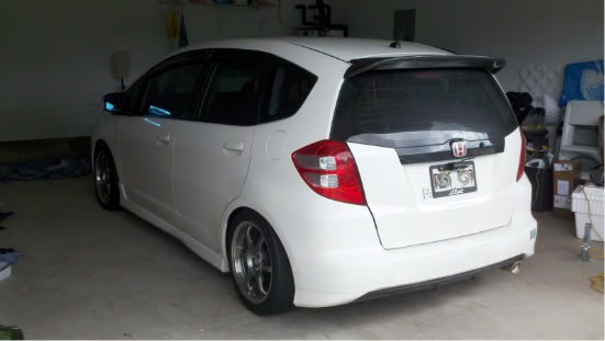

beangrower's Avatar
Posts: 620
From: Honolulu, HI
running 205/45 w/ 16x7" +35 on buddy clubs. no rubbing...sorta flush. u should have no problems if ur gonna run t1'r's.

Old Nov 6, 2010 | 09:47 AM
JDM-Taffeta-S's Avatar
Posts: 152
From: Miami , fl
Thanks to all the help to each and every one of you. Great pics beangrower. Keep the pics coming maybe of similar setups. In my case i dont understand im on t1r but i rub and im on stock wheels with upgraded 205 50 16 tires.
