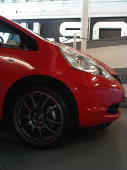

Anyway, this is 17x7 +42 CR Kais with 205/40/17 tyres.
To me, it seems like the gap is HUGE!
Obviously I want to decrease it so I'm thinking of lowering it on springs but the thing is I heard rolling on 205/40/17 tyres will make the ride super bumpy as the tyres are thin.
So I'm thinking, should i go 205/45/17? (Actually do I need to stick with 205 in the first place?)

I think the cr kai's look great on your car man! Personally i roll on 205/40/17's and love it, especially if you lower ur not going to want a thicker sidewall. I am awaiting coil overs for mine and it should still be ok. I reccomend swift springs for you if you dont want coilovers, everyone with them thinks they are perfect for a modest drop and comfort.
a thicker sidewall will proportionately close your gap a little but it will also raise your car in the process... so that is something to think about.
as far as those axis wheels fitting ur stock tires. I am not too sure about that, of course the diameter will fit but your stretching a 175 which used to be on a 5.5 or 6" wheel to an 8" wheel. seems a little sketchy to me but im not an expert on stretching so you may want to reach out to others for answers on that.
