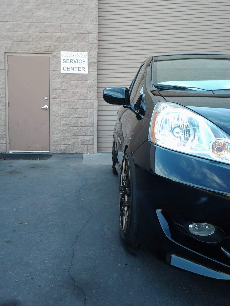

From: Gilbert, AZ
18x8.5 +45 215/40/18

Originally Posted by VRsean
I like!!!!!!!!! Like the stretch too!! How much work was put on the fenders?

honestly the fronts scared the hell out of me when I first bolted them on because they stuck out a good 2 inches, but now fenders are pulled about 3/4" in the front and the camber bolts saved it for sure. The rear is a really good fitment to start with but does take some rolling and pulling to work. If I knew then what I do now, I would run a 205/40 to save some of the bodywork
