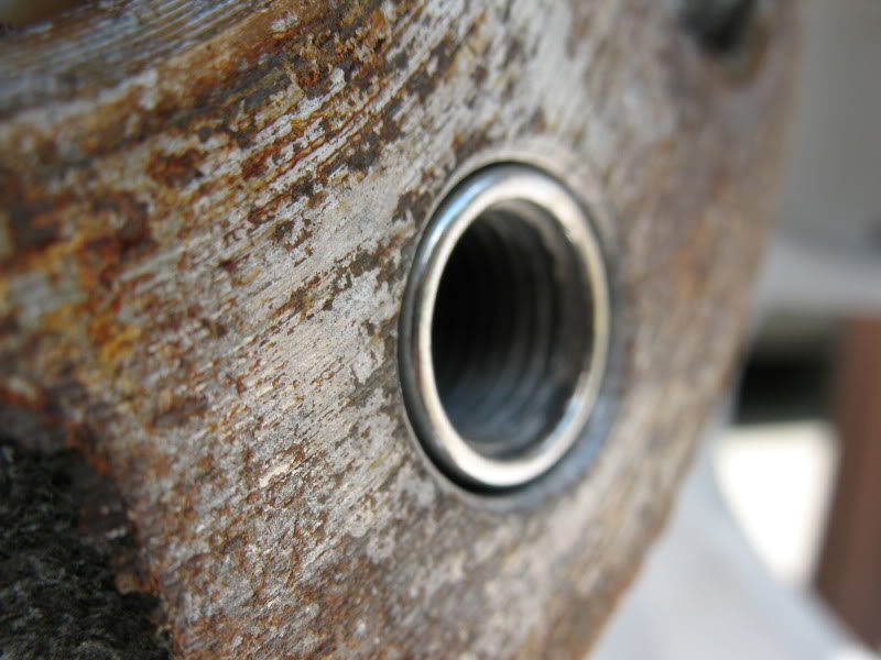

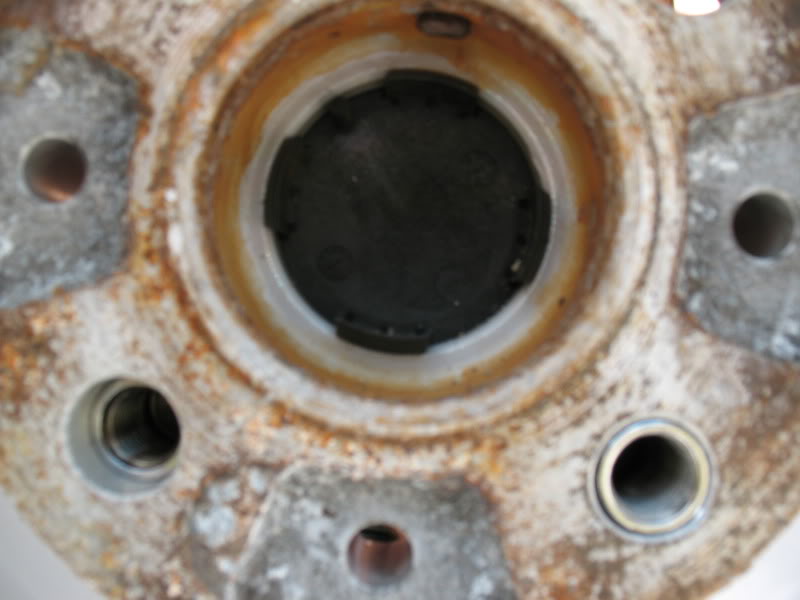

Just picked up a set of Mini Cooper R85's.
Yeah I know they're boat anchors! But they were cheap!
Thought I would let everyone thinking about running Mini rims that you need these lug nuts to get enough threads on the studs and to properly seat the rims. With these I'm getting 14 complete rotations on the studs and with a stock Honda rim & lug nut I'm only getting 9.
I plan on getting some 8mm spacers for the rear, I put some washers that spec'd out to 8mm and I still had 9 full rotations!
They can be found at Jegs for $5.99 for 5 or $21.99 for a set of 20 that has locks and valve stems. HERE
Look close at the difference!

No pictures, she's all tucked away for the winter!
But I did throw them on real quick and it looked good!
Stock lugs=ball/radius type
Mini Cooper take conical/tapered lugs
So the answer is NOPE!
