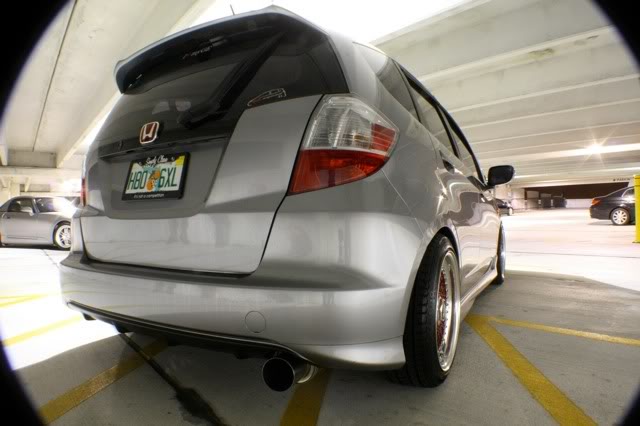

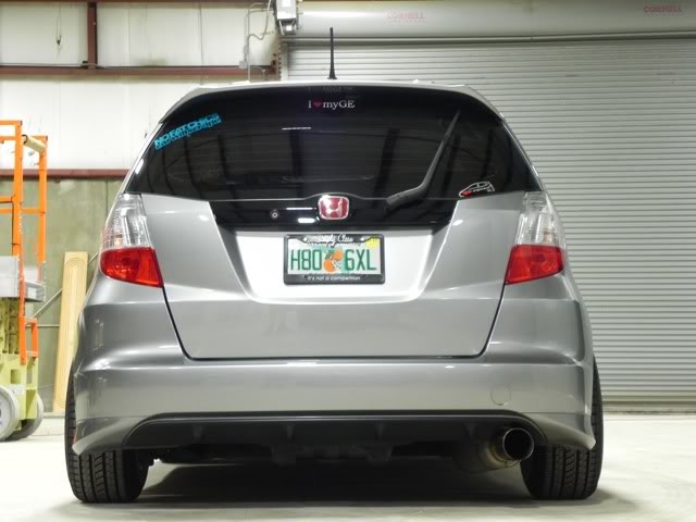

well when it comes to the rear, im running 16x8+24 offset with 195-45-16, and i rub on dips and when i got peope on the car.. im planning to get my fenders rolled more but for the most part, ur offset shouldnt have that problem. but u being 8" wide.. u might rub... but here is how the rear is looking
as for the front im not sure but im thinking of getting bigger lips so i can have the same specs all around.. but hopefully more people would chime in
