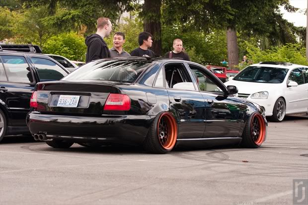

OP, do not buy these wheels please, in any lug pattern. If you are this unsure of what you are looking at, you will not be able to pull it off with out it looking terrible. Below is a handy illustration:
What you THINK the fitment will look like:
What it will actually look WORSE than:
If you want to run a wide, aggressive wheel, I have good success with 17x8" in the et35-38 range, and 17x8.5" et42-48.
And don't run a tire wider than a 205 if you plan to run an 8" to 8.5" wheel.
