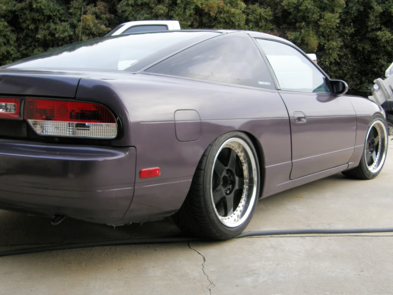

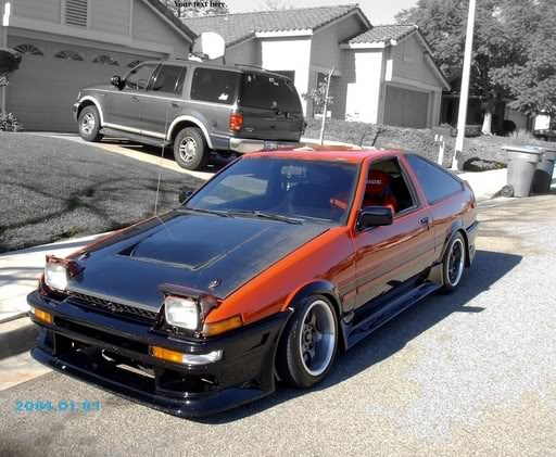

Old Dec 16, 2012 | 10:32 AM
  #34
pandapandared's Avatar
Joined: Mar 2012
Posts: 69
From: san diego
are u on stock suspension ? ur car looks great
i got lower springs and want to get my wheels flush like my drift cars but not go to crazy cuz its my daily.
Me? Thanks man. I'm on Buddy Club coils. This is it now, but w/ 16x7 et42 205/45 all round. Still same spacers.
