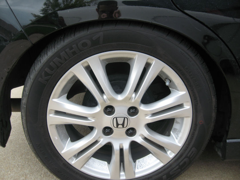

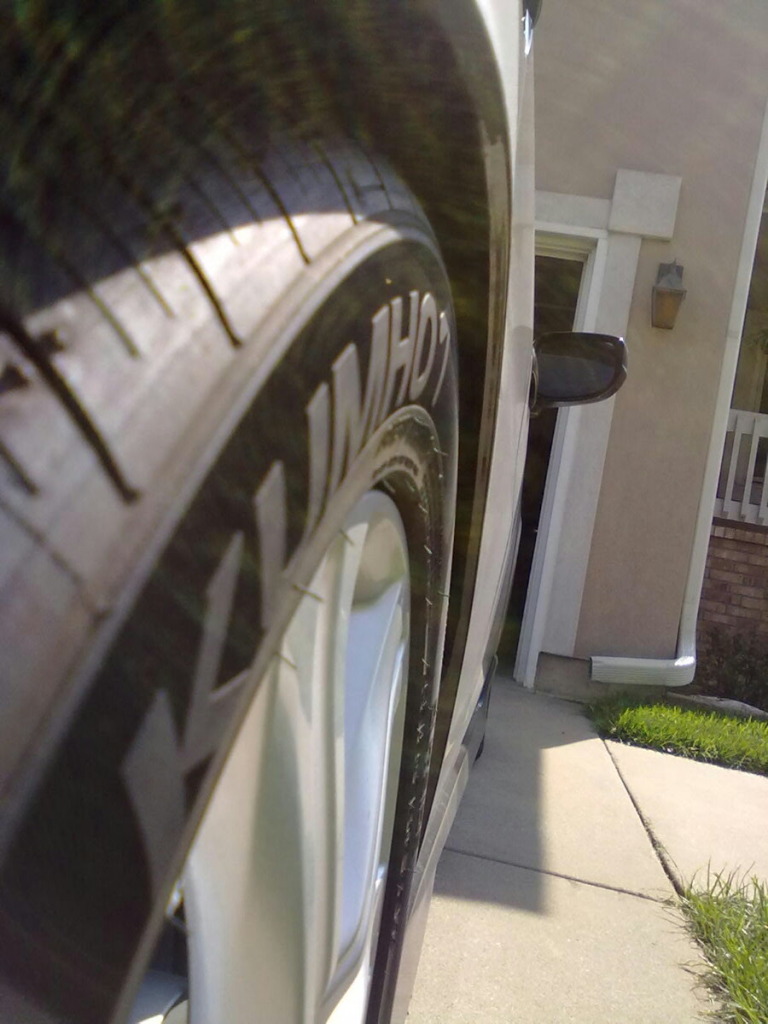

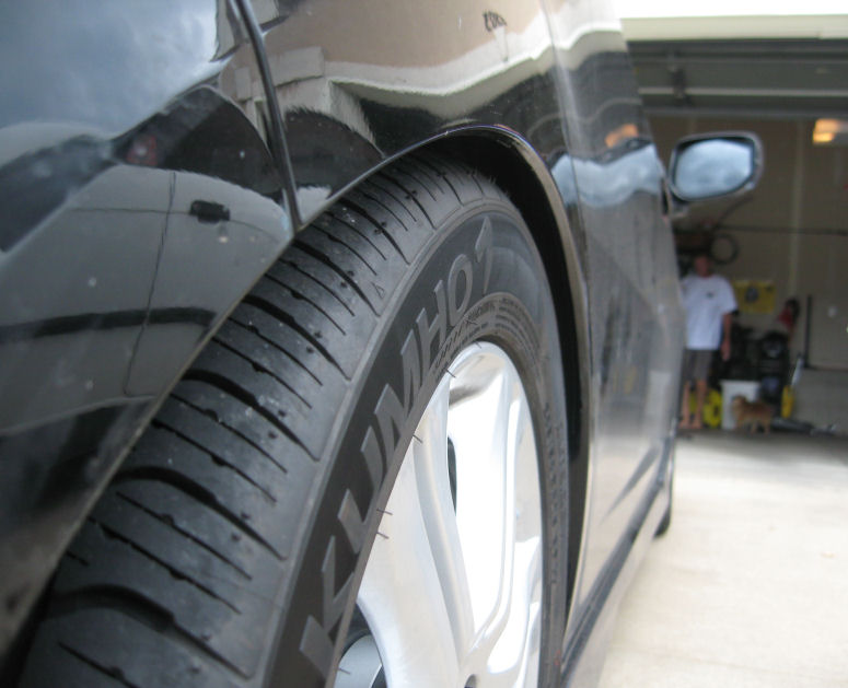

Originally Posted by MEATBABY
Here's a few quick pics for reference. 205/50/16 with 20mm spacers. Fenders rolled. It's not slammed or anything, but when I put on the 15mm fronts I'm going to take a collar or maybe both out from the back. Will post more pics of front and rear when I do that. You can see in the last pic tho that the tire has just enough room to tuck behind the (rolled) fenders. I compressed the suspension when I had it on jack stands to confirm this. So right now on bumps there is no rubbing at all, and it will be the same story when I drop it more.
Attachment 23359
Attachment 23360
Attachment 23361
Nice! I hear the fitment is the same for GD3. Is that true? 15 front and 20 back?
