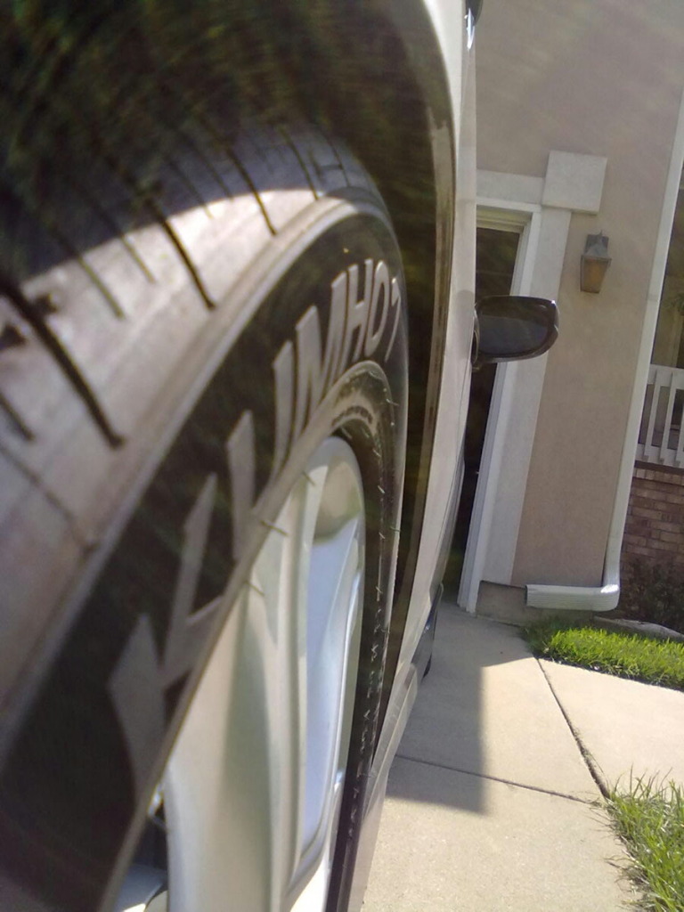

Here's a few quick pics for reference. 205/50/16 with 20mm spacers. Fenders rolled. It's not slammed or anything, but when I put on the 15mm fronts I'm going to take a collar or maybe both out from the back. Will post more pics of front and rear when I do that. You can see in the last pic tho that the tire has just enough room to tuck behind the (rolled) fenders. I compressed the suspension when I had it on jack stands to confirm this. So right now on bumps there is no rubbing at all, and it will be the same story when I drop it more.

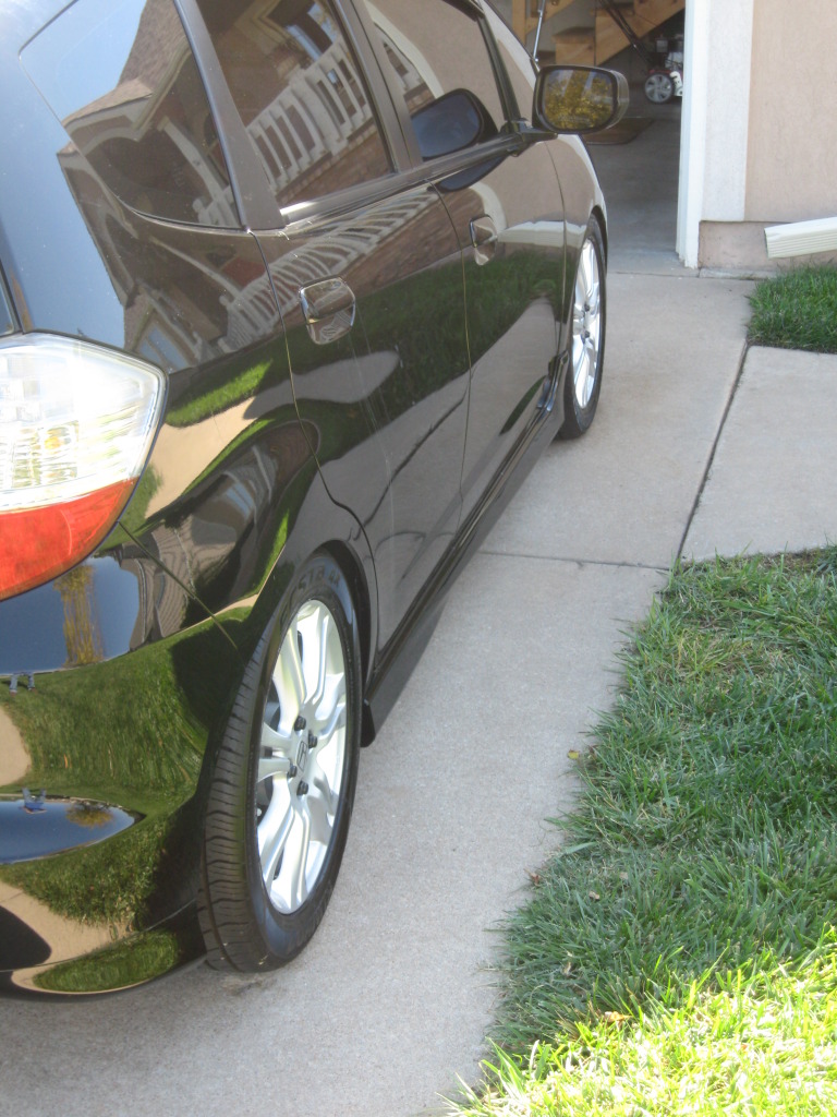

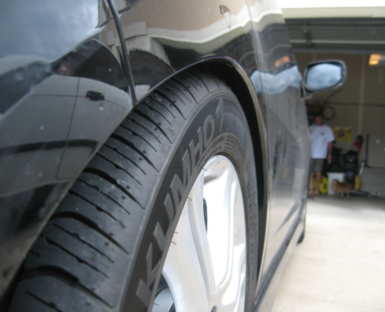

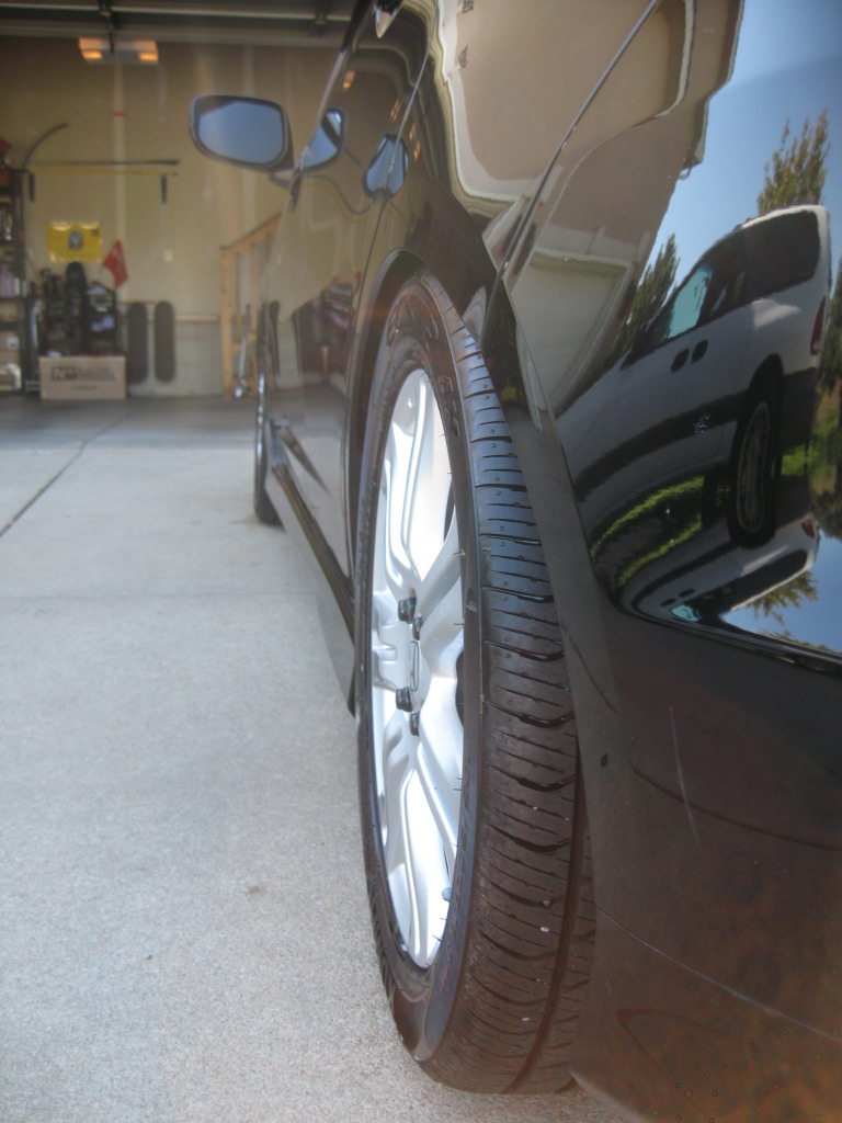

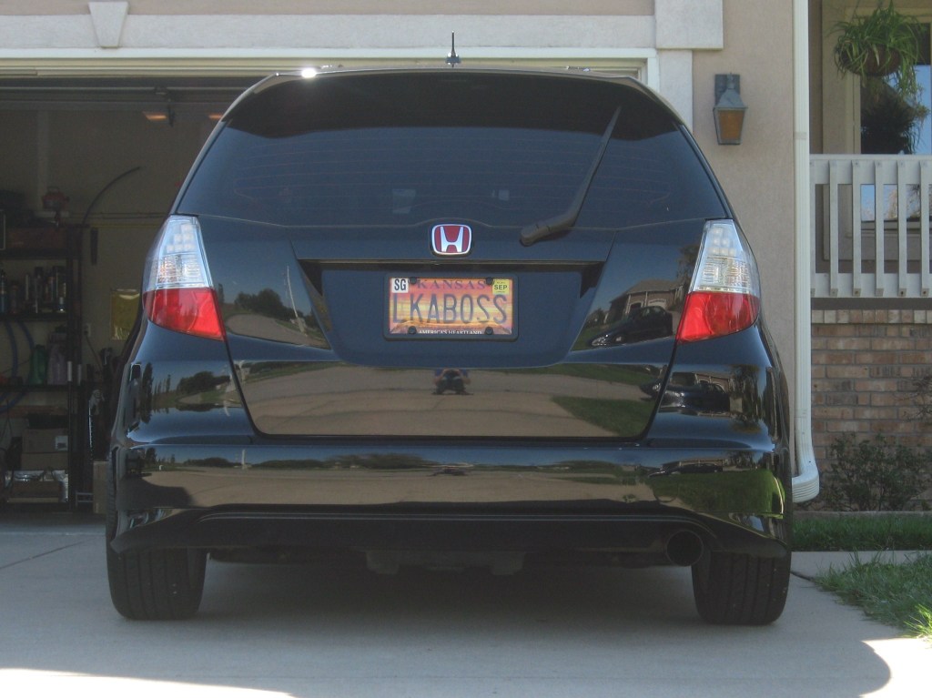

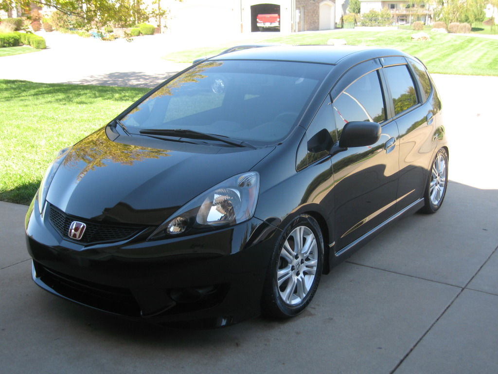

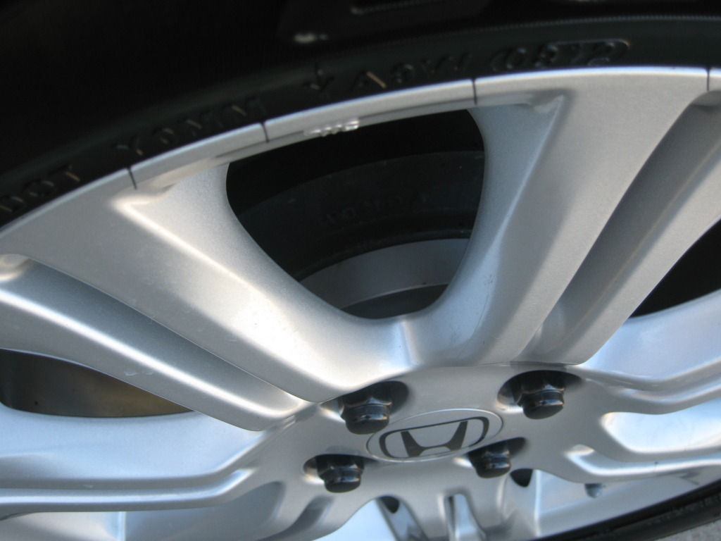

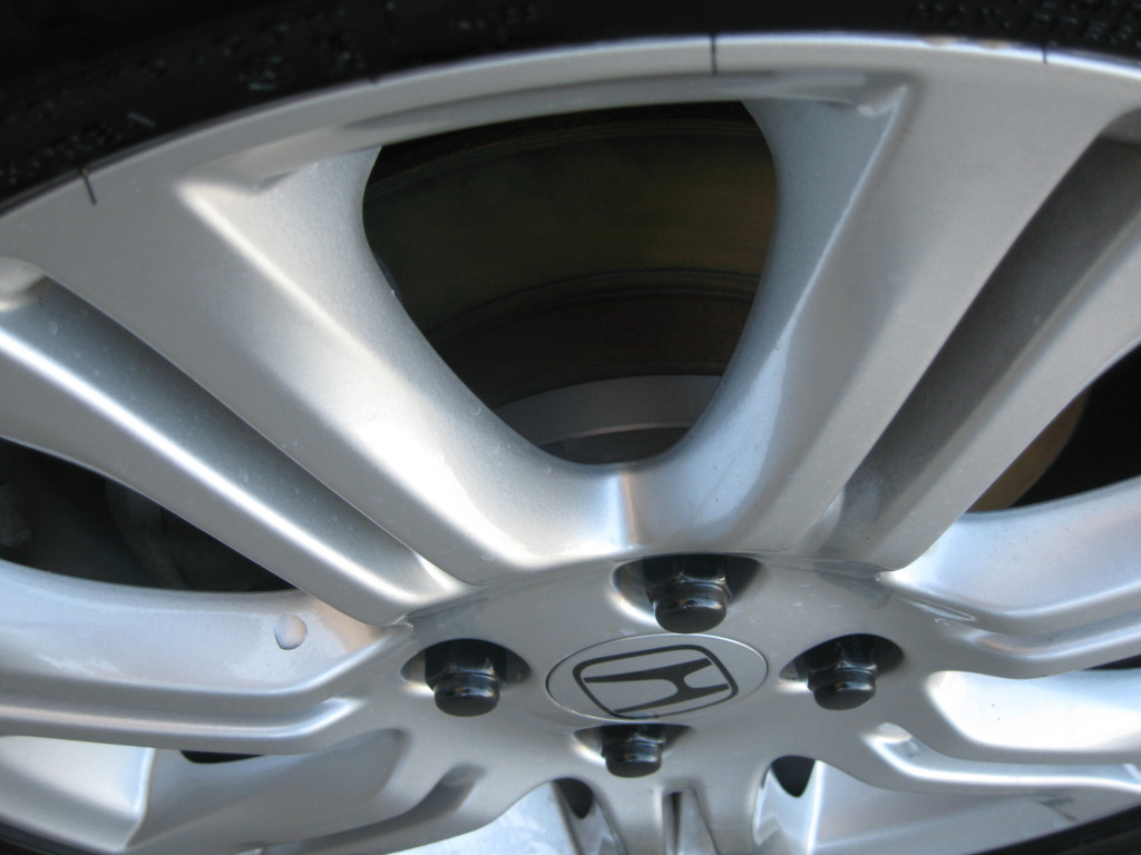

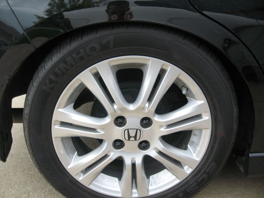

Finally had time to wash the car and take some pics. Tires still a little milky from the tire foam...20 mm spacers on rear and 15 on the fronts. 205/50/16 tires.

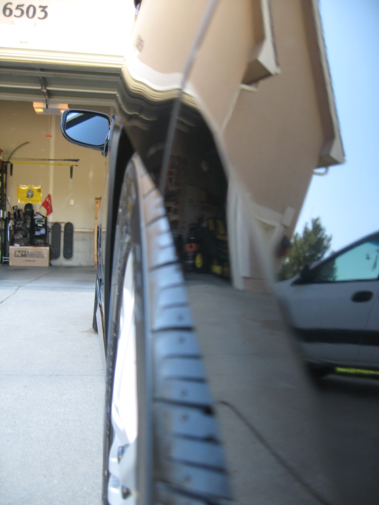

See the lip? Didn't think so...

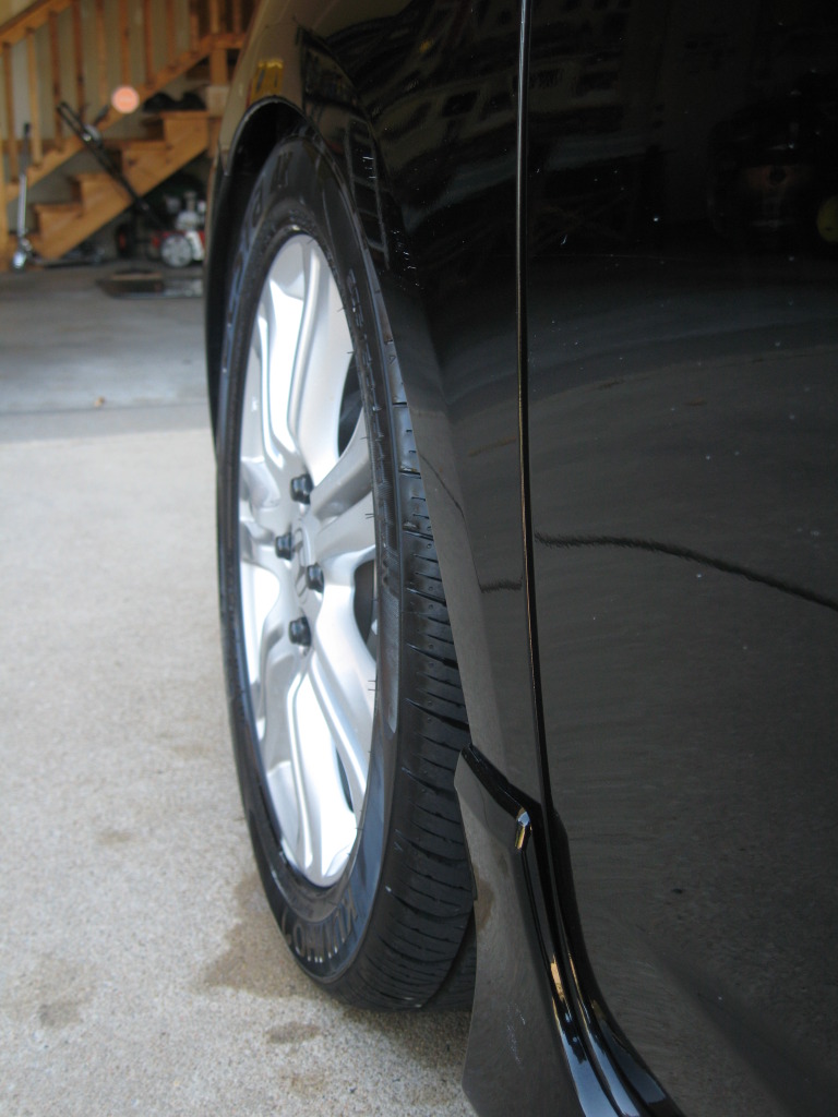

Front...
Didn't have to roll the fronts. Just cut the lip of the actual fender liner off and bent back the tabs on the fender lip.

15mm spacers...
20mm spacers...
