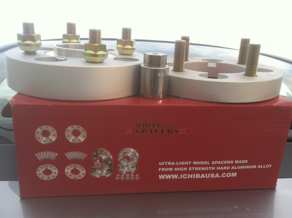

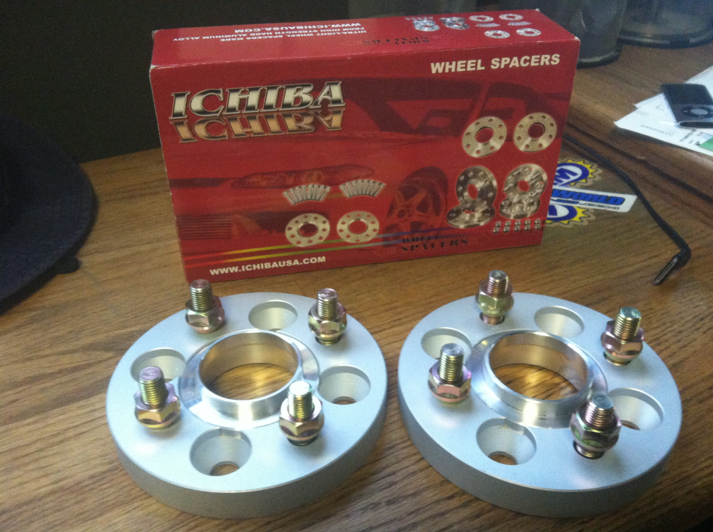

The Ichiba's arrived. I'll try them out tonight for fitment.

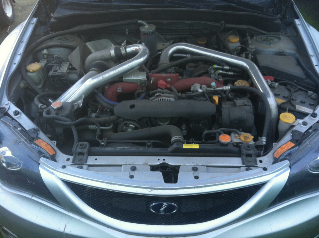

Ahhh, someone who knows my pain. What part of Ca? Here's a pic you might enjoy of my STI. FMIC, Garrett GT35-R, 530 AWHP.

With the Ichiba V2's, the weight of the vehicle is supported by the hub, not the lug stud/nuts. There are dedicated studs built in so the issue of having lengthened studs is mute. The issue of bearing loads always comes up but I've never had a single issue with decades of experience with hubcentric spacers on and off the track.

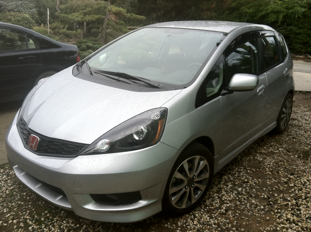

Pics 20mm offset
The 20mm offset looks fantastic with no rubbing, even on a bouncy dirt road. I will keep the 20mm for the front and go 30mm for the rear (ordered). Name:  nospacer_zps0ec05706.png

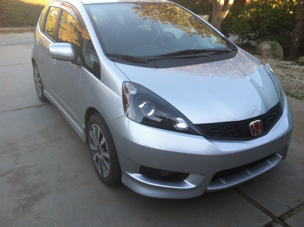

And here's a pic with 20mm offsetName:  spacer_zpsa63d2076.png
Looking good. I run 20mm spacers on my GD3. Pretty much the same kind. It's been almost 2 years with no problems. You're lucky ur fenders stick out more, jelly.
Very nice D! Mine's all stock. Just upgraded hoses and brakes. I'm just north of you.
