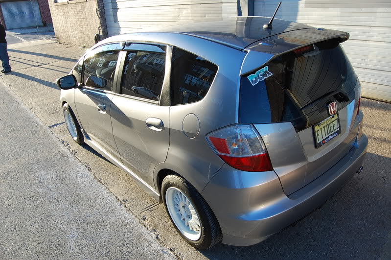

There are several user's on here running 15's, FitDEEZ is one example https://www.fitfreak.net/forums/2nd-...ssm-ge8-2.html
"15x7.5 +32 .. 5mm spacer in the rear 205/50/15 in the front and 205/55/15 in the back .."

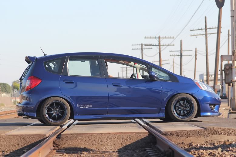

pig_pit as well ran 15's https://www.fitfreak.net/forums/2nd-...new-car-3.html

"15X8 tires are 195/50 F"
15's on a GE seem to work as long as the car is VERY low, at least aesthetically speaking...
Either of your options should work, depending on how low you are, and the difference between +35 and +38 is not HUGE. If your going to run the meatier 205 and are low, I'd go +38 to be safe

Based on Fitdeez above specs and pics..he's running .5 more width and offset is lower so realistically these options should fit and not stick out..
