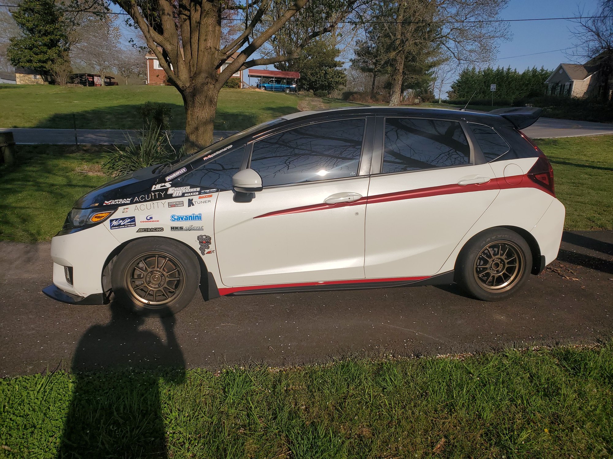

I put my "stock" GK5 throttle body and RZ crew manifold on to tone down any issues with the S2K throttle body before tuning. I was able to run her for 10 minutes between 2000 and 3500 so the cams should be broke in (10 to 15 min rqmt). Here's a video and a few pics showing MAF (bought a new one today for troubleshooting). Also I added back the EGR canister to connect back into the wire loom in case an open there was causing a race condition in the software. That helped with the S2K TB still on there. Also added a mishimoto oil catch can while u was switching manifold...
EGR BS
MAF hole and air from intake to valve cover.
Back to basics GK5 TB until tuned
Mishimoto oil catch can
A bit more aero sneaking in
Porsche whale tail club here i come!
Another

Holy shit it’s running leeeeannn lol. Sounds great though. It’s weird, the intake pipe looks wider than stock, so MAF should be reading low. But if you’ve tripled the fueling that should a make up for the extra air. I know someone changed the MAF housing, they said they did an easy Ktuner fix to get it metering air correctly. Do you happen to know the difference in diameter between the old MAF housing and the current intake tube diameter? Maybe if you compare the two then it’s possible to math out the difference of airflow to fix the MAF tables in your tune.
(MAF Settings)
I’m curious what the STFT and LTFT readings are. Is it trying to trim out the lean mixture and eventually giving up? Please let us know! This car looking and sounding good already! Holy crap thanks for sharing Z06!

I will see what I can find out about the MAF settings. I did nothing to the fuel other than add some torco so probably have 95 octane approx in there right now... makes sense it is running super lean.
BREAK BREAK
Anyone find instructions for filling the radiator from empty? I'm nervous I have an air bubble in the block. The coolant temperature has not risen above 170, and that was at the end of the 10 minute run... it took less than 2 gallons to fill from empty...

It was the MAF calibration table. I found the radio between the og MAF cross sectional area and the new intake (1.9) and multiplied it across the table. Started right up, good idle. Drove it 16 miles last night.
