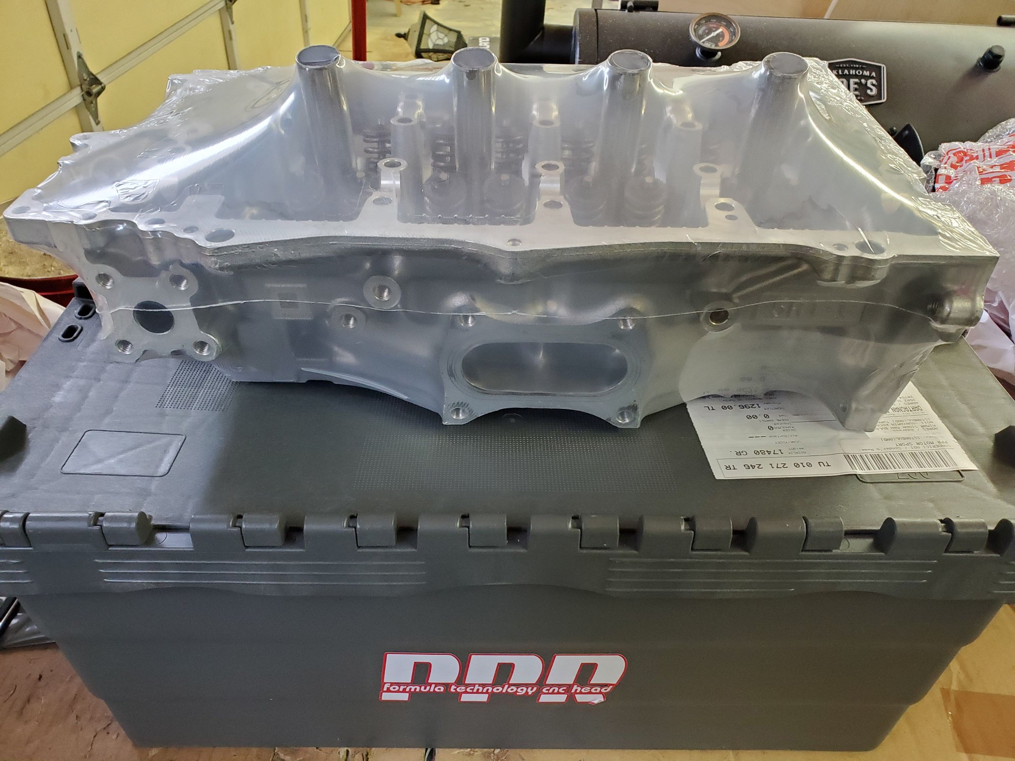

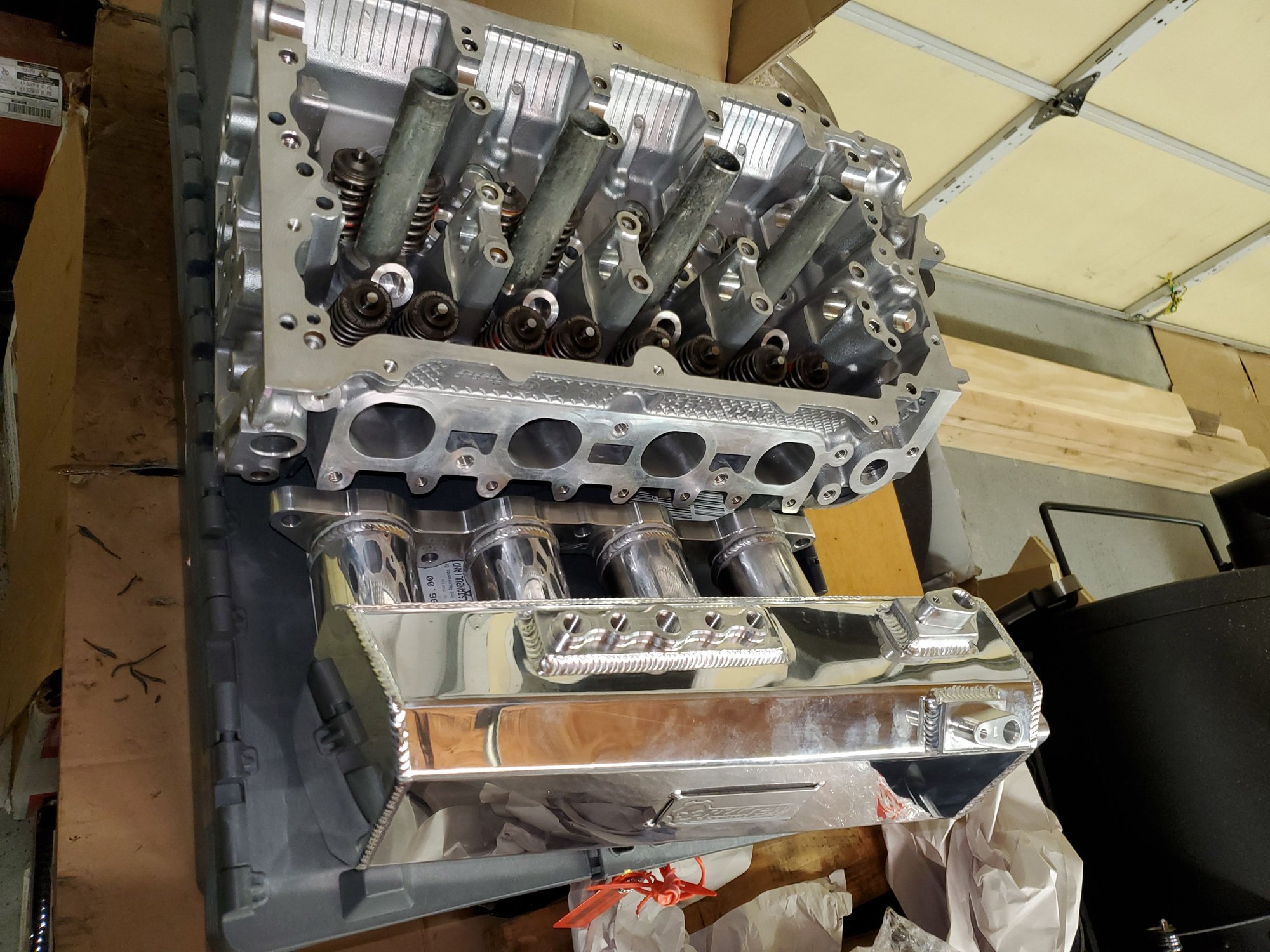

Cylinder head back from Turkey!
Well packaged
Vacuum sealed for freshness
Stickers FTW
A gift of Turkish coffee
Intake side looks good. I haven't taken measurements yet
Very smooth intake porting
30mm intake 27mm exh. Unknown if they decked the head... probably just cleaned up.
Top view. I have never reassembled a vtec valve train. Any pointers? Web cams said buy all new but my donor engine only had 13k miles on it so???
Great Port on the exhaust side, they made subtle channels to direct air flow, not just maxed the port. Plus i heard there are water channels to avoid so glad they did it, vs me...
They used their own retainers and springs, pretty nice!
Head is back from Turkey. RZCrew intake manifold has cleared customs. Should be in this week. Block is still at Golden Eagle. The Brian Crower L15 rods are only for the civic which are shorter than ours by a couple mm, so I found some GK5 rods by @MaXpeedingRods they also have coilovers and turbos so... who knows what could happen??? which should be good enough... they say they're good for 600hp, so we'll see when I go turbo forced induction . I have asked GE to assemble the short block there. They're taking a stock head gasket and opening it up to support the larger diameter pistons. They will also select the correct bearings for each crank journal and connecting rod. I told them I'd use plastigage and they said that's for ameteurs, so in for a penny, in for a pound

This head looks good, but the exhaust port can be bigger, because you can see the old carbon build where the gasket was...
Other then that, it looks nice !
What is your power goal ? I'm really interested to see your results ! Keep the great work !

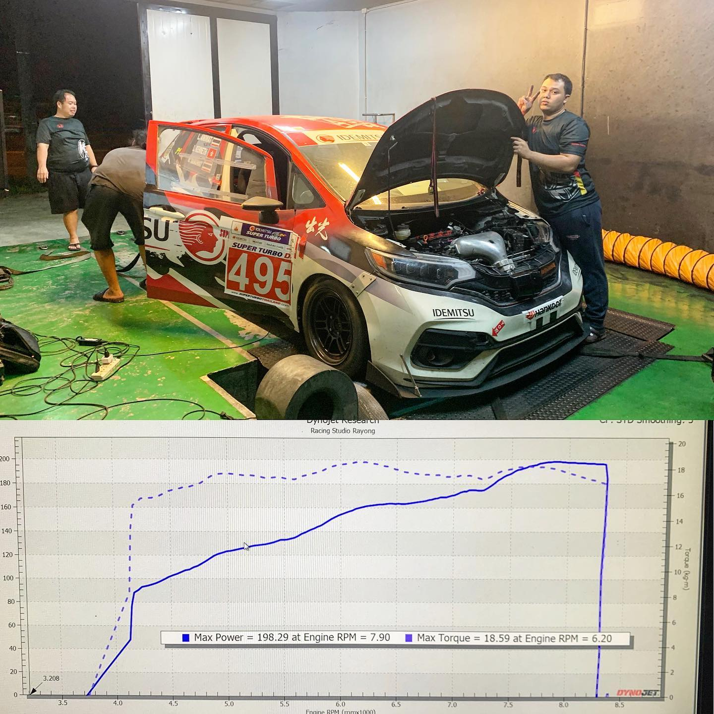

Old Nov 4, 2020 | 11:04 PM
takuyaSH's Avatar
Joined: Apr 2017
Posts: 12
From: Malaysia

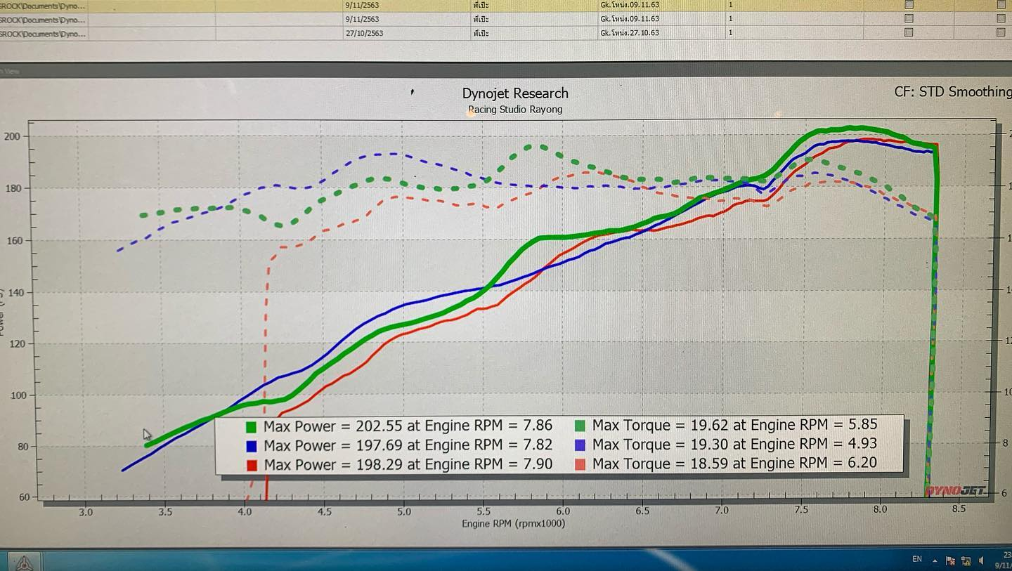

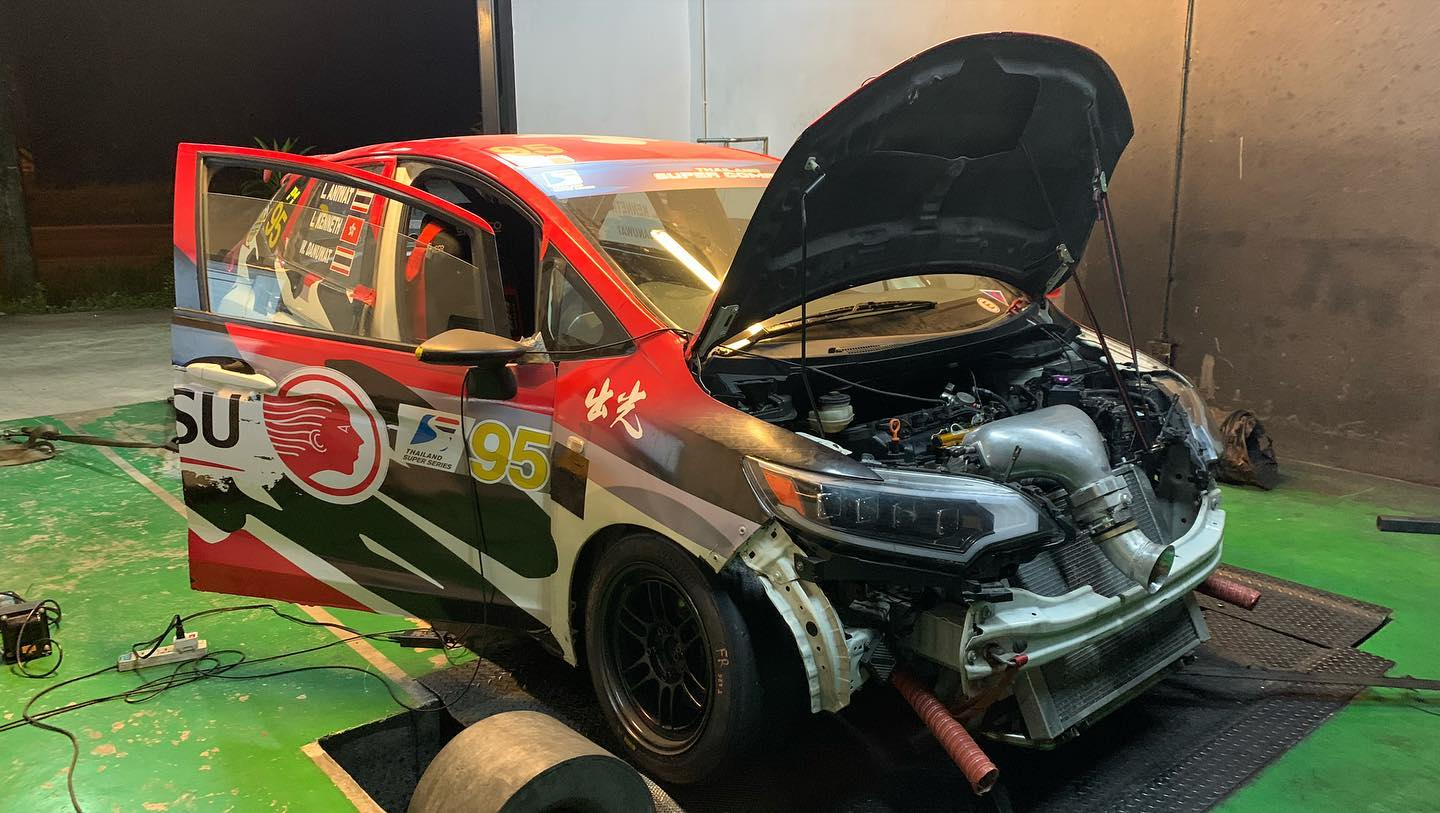

Here's a motivational photo
200 is certainly doable!
Can you please post the link of your thread ?
It's not my car, I got it off a wireman/tuner based in Thailand off Facebook.
https://www.facebook.com/blacksheep.dangerous

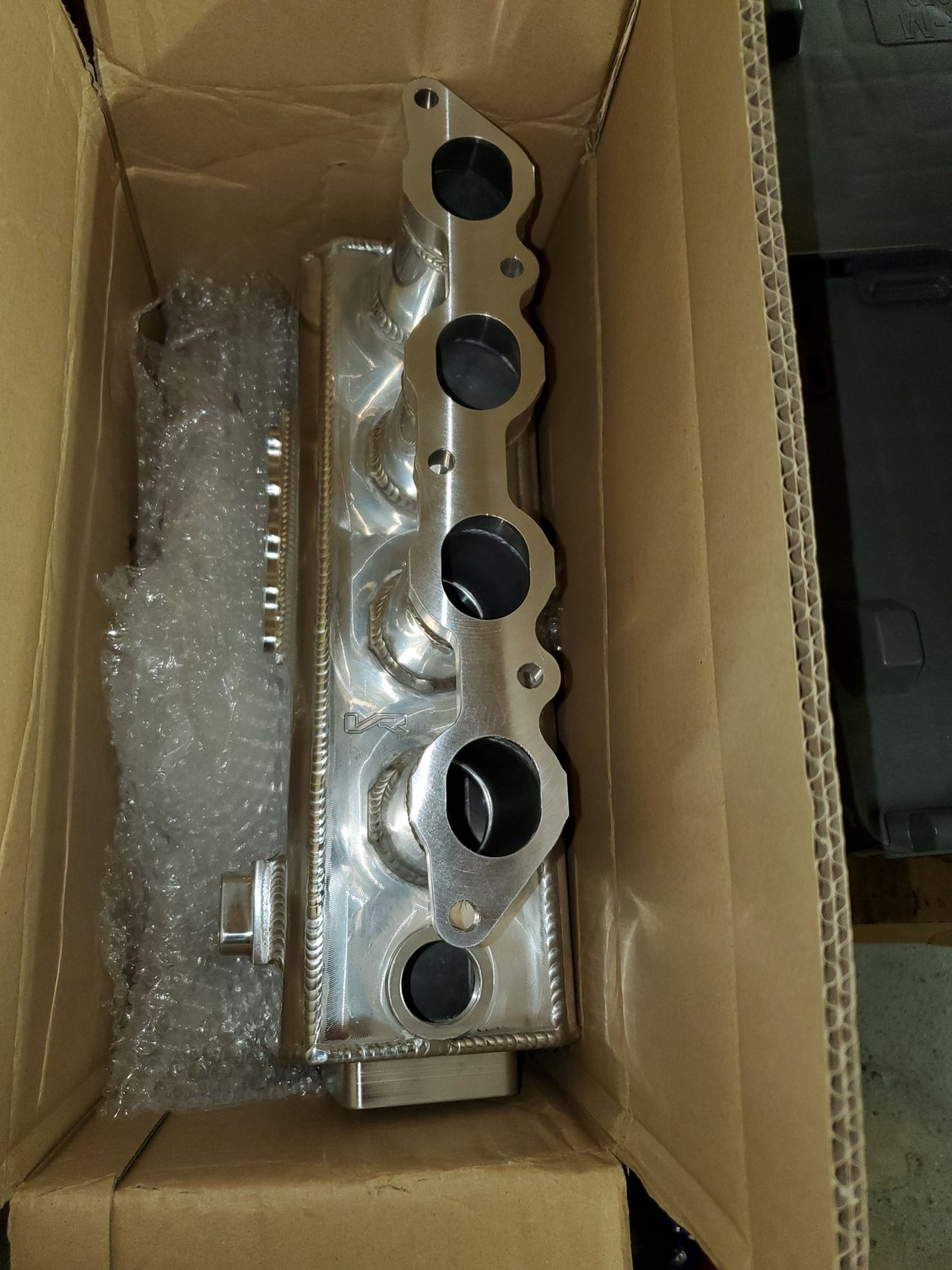

RZCrew GK5 intake manifold
Got this in from Singapore. Only problem, I wanted a wide mouth 70mm tb opening but I got the GK5 oval. I'm going to try it out on my stock engine and am asking them to build me another one with the 70mm S2K TB opening...
Real engine porn

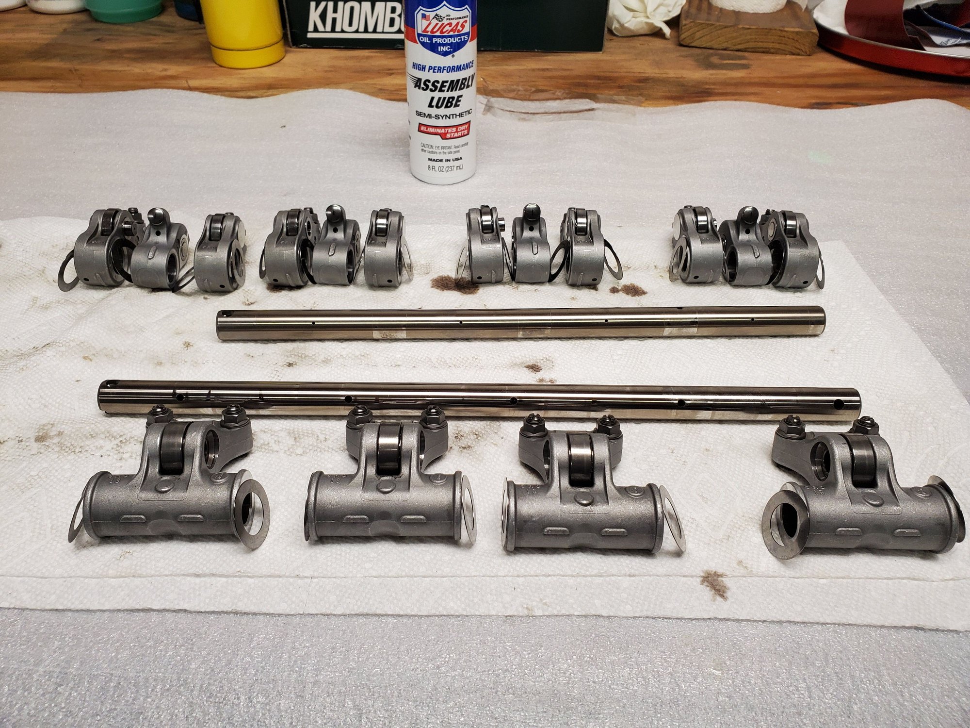

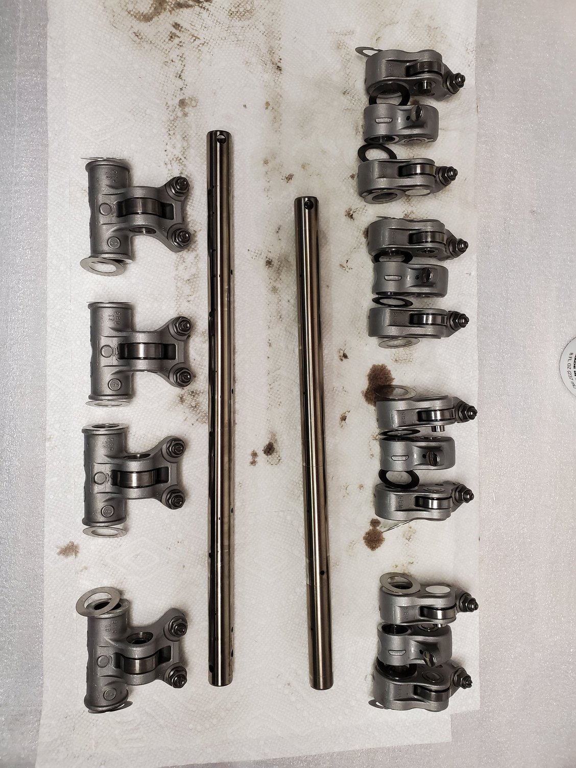

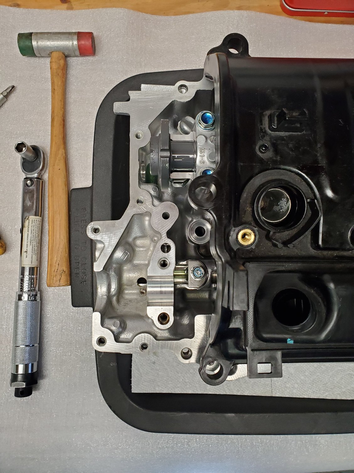

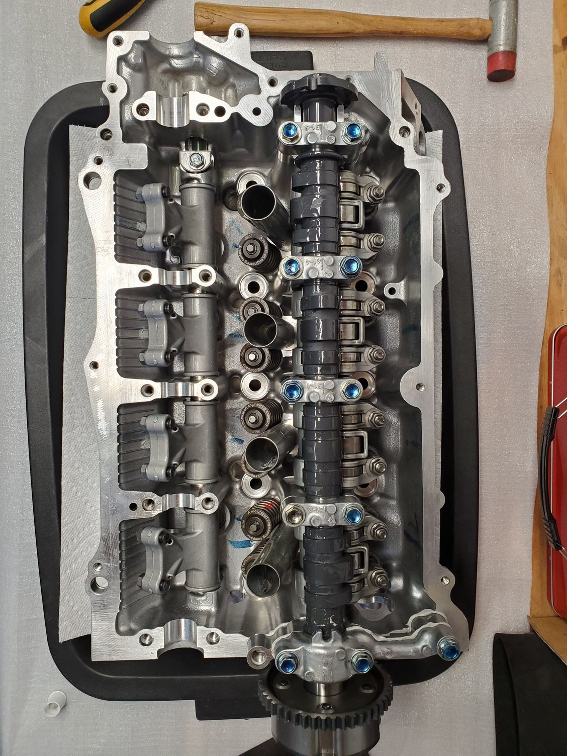

Head Reassembly
A few pics. Block should be back in a couple weeks. I am mating the block with head and cams and taking to Precision Machine for measurements and to degree in my cams...
These pieces can only go one way. It's a fun puzzle...
Also backwards bars and probably upside down middle intake rocker.
I wonder if i could have asked web cam to modify the cam lobe at the end to increase fuel pressure. Corvettes do it on the DI motors...
Covered up to prevent dust while i wait for exhaust gear.
Bisimoto regrind from web cams. This motor is going to pull....
Torqueing back on the intake cam gear and vtec actuator. I went to 50ftlbs, might need more...
Lining it all up
Exhaust rockers in there
These bars are backwards, long one on intake side...
