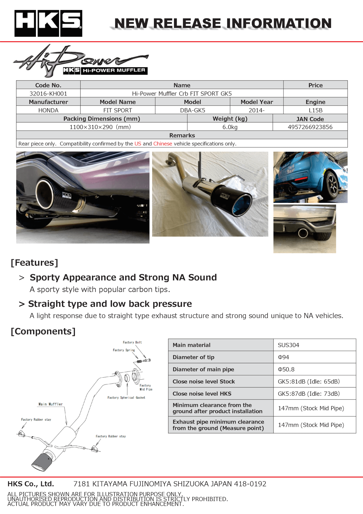

Question on HKS
Looking to get the HKS as well but I need some clarification. I'm puzzled cause the HKS site says it wont fit with the Mugen rear diffuser but they have one in the video. So will it really fit or not ?
https://origin.hks-power.co.jp/en/pr...ffler/db/15573
Old Jan 27, 2021 | 10:00 AM
NWCH's Avatar
Joined: Sep 2019
Posts: 1,195
From: Mountlake Terrace, WA
https://www.youtube.com/watch?v=MFMin9WsRlk&t=24s
The HKS pictured above only fits the US spec Sport. Not any other market vehicles or trim levels.
Well I did some research and got the JDM spec one from eBay. The ones I saw on US sites, I realized the mounting arms were set in a different direction.
I'm more than happy with the results though =DGetting in the 140's on the Dyno too
